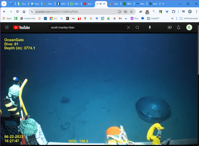

Perhaps this video has already been posted - if so, sorry for the repeat.
Ignoring what is alluded to be a digi-creation voice for narration and some in-video ads, the presentation makes some interesting analysis of the design and CFR hull and its implementation and the preferred test regimen it should have been subjected to prior to use with human passengers.
Additionally, an analogy to TNT force is presented as many others on this thread have already provided and calculated. Seeing a visual representation really highlights the force and rapidity of the implosion.

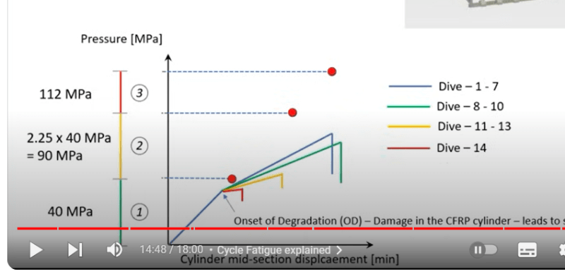

No there's a raft of videos coming out now which are very interesting.
From yours this is an interesting graph and his calcs basically show that their predicted collapse pressure new was about 56MPa, with a dive depth of 4000m (40 Mpa). So at best a FOS from operating to COLLAPSE of 1.4. As the commentary says, this only works when you have full knowledge and reliability of the data used in the analysis.
Then as the number of deep dives increased that FOS reduced until it failed. But 1.4 FOS is absolutely nuts.

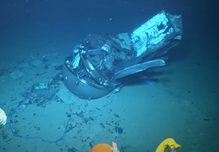

The second set of photos and analysis seems to indicate that the failure point was at the entrance end where the titanium ring met the CF hull and has been speculated on here previously as being a crucial and likely source of the failure point. The photo below shows the far end with all of the CF material basically compressed into the end shell. The other end cap and the dome blew out in the collapse.
Littleinch - yes, the simulation appears to have chosen/calculated an initiation of implosion at the front dome interface. The actual evidence contradicts that mechanism. After seeing the photos of the actual debris site, I understand why no CFR hull components were present in the sea surface recovery photos - there is no hull remaining! The hull suffered a complete shattering. Quite sobering. I have to wonder if the lack of a precedent implosion wreckage of a CFR hull caused the OceanGate team (as guided by Stockton Rush) to underplay/downgrade the severity of an implosion event? Any engineering effort to develop a similar vessel will now have explicit evidence of the enormous risk involved.
Since the OceanGate team never sent an actual unmanned Titan to full Titanic depth until failure, each of the manned dives probably increased their confidence level with the hardware and caused a normalization of implosion risk. All the creaks and snaps of the hull became accepted - similar to the acceptance of the sounds of an old but trusted vintage automobile. Unfortunately, their risk analysis apparently discounted buckling failure is instantaneous and testing to failure with a full size vehicle would have provided much insight into the safety of the design.
That material that is sticking out of the front ring and dome looks to be where the high-pressure air cylinders were stored under the floor.
The testimony of Tym (forgot last name) indicates his belief that the hull was being squeezed in a way that local bending at the interface with the wring was being resisted by the tension in the adhesive, but that the adhesive was, dive after dive, coming loose circumfentially until it could no longer resist the shear load from the differential squeeze between the carbon fiber hull and the titanium ring, leaving only the small step in the ring. When it reached a point of critical damage the remaining adhesive failed, momentarily transferred the load to the small step, which he observed had been completely sheared, indicating an event so rapid the failure could not have started at one location and progressed.
He observed that at the rear the progressive shear of the ring was observed as a curlicue of metal that remained attached, indicating a secondary and slower failure.
This isn't an initial buckling failure, it appears that the diameter of the carbon fiber hull was being elastically squeezed to a smaller diameter than the elastic squeezing of the titanium end caps followed by the inability of the eventually unsupported open end of the tube to remain stable after the connection was sheared off.
3DDave - is Tym's testimony part of the MBI? So he is saying the failure was caused by the inner wall of the end ring that formed the engagement channel for the CFR tube sheared off (collapsing radially inward)? This would mean the predictive modeling did not account for a failure mode that is well understood. Cyclical stress to the titanium hoop of the engagement ring should have been seen. (I am assuming OG used an analysis program more involved than something like Solidworks Simulation or Autocad Inventor's built-in). Of course, the model may have been influenced by expectation of continuous adhesive bonding to provide control of the bending moments created at the engagement grooves of the end rings. But the fault analysis should have included evaluation of loss of adhesive bonding.
