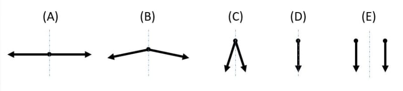

Below is a simplistic version of what I mean. A through D have included angles and intersection points - A being 180 degrees, D being 0 degrees, and C/D being somewhere in between. E has no intersection and does not have an included angle. While not something I have an issue with personally, I understand the difficulty in discussing cones or intersection points with 0 or 180 degree included angles - but to suddenly make the leap to a cylinder (E) where there is not even the possibility of an intersection point to me follows neither logically nor geometrically.
A cylinder of any nonzero diameter is not a cone in any sense or "special case". The only thing I will concede is that a cone of 0 degree included angle is a line which MAYBE one could say is a cylinder with a diameter of zero, but I don't see much use in discussing cylinders having no diameter especially as this logic does not apply to any other cylinder for as soon it has any nonzero diameter it is absolutely not a cone (no intersection/included angle). Though if I'm to go by your previous statements if you do have issues equating a 180 degree included angle cone with a plane I would think you have the same issues equating a 0 degree included angle cone with a line - the fact that you would make the leap from a 0 degree cone to a cylinder of any diameter seems incongruent (though as I said equating it to anything other than a cylinder of zero diameter is not supported by the geometry involved).
If the slope angle is changed to 90° (180° included angle) then the axis becomes of zero length; the only meaningful length of any axis of a theoretically perfect feature is the portion at which it connects center points of cross-sections of the theoretical surface which it is related to. This effectively eliminates the existence of a surface of revolution - there is nothing to revolve around, therefore the resulting geometry is undefined as a surface of revolution. If it is no longer a surface of revolution then there is certainly no equivalence with a cone.
What I personally believe is that the axis is really of infinite length - as long as it bisects the angle theres no reason to limit it to the length of the feature. So a planar feature could have an axis consisting of any line normal to the surface. But perhaps thats a bit of a stretch for most people. Your statement that there is "nothing to revolve around" could be countered with the existence of such an infinite axis, or even without it I see no reason that anything existing in the same plane could be revolved around a single point instead of an axis. Do you not agree that a point could be revolved around another point to create a circle? Same concept.
Setting all that aside for the moment, can we agree that geometrically there exist features of 0 degrees included angle, 180 degrees included angle, and everything in-between? Going by stricter definitions a cone is the set of possible features having an included angle between 0 and 180 degrees, bounded on one end by a shape having included 0 degree angle which is a line (or a cylinder with a diameter of zero) and on the other end by a shape having included 180 degree angle which is a plane.
Nowhere within that set (between 0-180 degrees) or the bounds (0 and 180 degrees exactly) exists a cylinder of any NONzero diameter which is why I disagree with geometrically equating a cone and cylinder of nonzero diameter. Conversely, one of those bounds (180 degrees) is a plane which is why I have asserted the similarities between a cone and plane.
**Edit - I see you may be referring to the calculation for (D-d)/L you mentioned in the other thread. First, you added "degrees" to the slope which is not correct. It is degrees or non-dimensional slope, not "0 degree slope". Second that calculation is the amount of "taper" which must be halved to get the actual slope of the line segments. This tells us nothing we dont already know - that a cylinder (D-d)/L would be zero which means it has zero taper and the line segments which it consists of have zero slope. For a cylinder of non-zero diameter these line segments are still parallel and non-intersecting and the resulting shape has no intersection point/vertex which is required for a cone. The entirety of my response stands as stated with no modifications needed.

You disagree that a cylinder can be considered a 0° taper. I disagree as much that a 180° "cone" is a cone. A cylinder lacks an apex and a plane (180° "cone") lacks an axis. If the axis can be anywhere on the plane it is not an axis, just a normal.
An axis would bisect the included angle. In the case of a 180 degree angle that bisected angle results in a line at a 90 degree angle to the surface, which is also by definition normal to the surface. They could be one and the same. The fact that there is an infinite number of such lines makes it difficult to comprehend but not geometrically impossible - it simply results in an infinite number of solutions instead of one.
Again, I've already conceded that my interpretation may challenge the generally accepted notion of what a cone is and may be hard to swallow. I don't really expect you to agree with me on this point. You've skipped over the more relevant portion of my response.
The main thrust of my statement was that the set of conical features having included angle between 0 and 180 degrees is bounded on either end by shapes having 0 and 180 degrees exactly. Even if you don't call either of these bounds cones of any type, my point was to show that a plane is represented by one of these bounds (180 degrees). Not similar to or approximately, but exactly. This bound is achieved by simply changing the included angle from 179 to 180 degrees and the existence of the vertex can be maintained - the fact that said vertex can be any point on the resulting plane doesn't matter. There is nothing preventing the transition of a shape with a vertex to make this transition from 179 to 180 degrees - neither theoretically nor physically as I showed. Neither of these bounds is a cylinder of nonzero diameter and it is impossible to create a cylinder of nonzero diameter from a shape having an included angle and vertex - this is true both theoretically and physically.

See below. (1) shows that an adjustable simulator could handle different truncations of the conical feature of interest with no need to "contract" it. For (2) which one is the minimum point of "contraction" when both provide equivalent simulation? Both are "contained" per your definition.
Continuing on your point about transition from 179° to 180° - arguably we could have a truncated cone with an adjustable included angle as the theoretical geometry. You could have smooth transition from say 30° included angle, gradually decreasing until 0° (cylinder). The apex will disappear but nevertheless, such a transition is possible. When you change the included angle to 180° both the apex and axis disappear. If you have an infinite number of possibilities to derive some geometry that geometry is called "ambiguous".
If by "disappear" you mean indistinguishable but still exists, then we agree.
If by "disappear" you mean it vanishes or somehow ceases to exist, then I do not agree. The below assumes the latter.
The apex is a point. A point has no size. A line consists of an infinite number of points. A plane also consists of an infinite number of points. A line and plane also have no size. The apex does not disappear, in both the 0 and 180 degree cases it just becomes indistinguishable from any other point along a line (in the 0 degreee case) or on a plane (180 degree case). If you have a black surface and you make a mark on it with black ink, does that mean the mark does not exist or has "disappeared" ? No, its just indistinguishable from any other part of the black surface. As with the physical case with two rods connected by a joint - if positioned at 180 degrees the joint may not be distinguishable from any other part of the two rods but it certainly exists. The implication that it "disappears" or ceases to exist is just not logical.
This ambiguity would only come into play if you attempted to define a single axis/vertex for such a feature. I was just asserting the geometric similarities.
I disagree that this is not rigorous because it can work for any included angle and the simulation is not friction dependent.
You said it will "function in the same way" as a cylindrical simulator. It will not for any included angle in the theoretical world. It will also not in the physical world for anything more than a few degrees of taper. A cylindrical simulator is expanded/contracted until it cannot be expanded further. Try the same with a cone - all you will succeed in doing is pushing the part out of the simulator. The behavior is similar to expansion/contraction but the function is NOT the same as it will never achieve a point at which no further expansion/contraction is possible.
This lies at the heart of my issue with any argument saying that a cone/taper is a FOS. With a cylindrical feature one can expand/contract a simulator until the feature itself stops the expansion/contraction. Put a round part in a lathe chuck jaw. Once the jaws clamp around the part, I don't care how hard you tighten it, you will not succeed in further contraction. Same with a square part in a vice. This behavior cannot be replicated with a conical feature and conical simulator.
you say that a conical feature can always successfully limit a cylindrical simulator [...] Then perhaps it is IFOS type (a)?
A conical feature has by default a conical boundary, I do not waiver from my assertion this is not a FOS of any type. A conical feature with a SPECIFIED (ie: by a note or such) cylindrical boundary could be considered a IFOSa, I already said as much very early in this discussion.
The adjustable conical simulator will have to contract as much as it takes to make full contact around the conical part. Once it does, further contraction is not necessary. Rejecting a UAME based on the possibility of the simulator to contract further after completing the process is rejecting it based on some mechanical behavior related to the process of the simulation, not to the theory of dimensioning and tolerancing.
Figure (1) in your sketch shows that if the simulator's small end is larger than 20.1 (middle image) or 19.9 (right side image) it will have to contract to fully contain the feature.
Figure (2) shows 2 different fully acceptable simulation results, identical ones. No need to choose among them: assuming no form error (for simplification) in both cases dia. 20 of the feature is precisely simulated by did. 20 of the simulator, and similarly each and every local diameter on the feature is simulated by an equal diameter on the simulator.
If you prefer to call the apex and axis of a 180° "cone" indistinguishable rather than ambiguous then so be it. I'd rather call it imaginary (made up). If you look at a black surface you can imagine that there is a black ink mark on it, which may be there and may not. If you make a truncated cone into a nonzero size cylinder by folding the included angle about a fixed size truncation at least the axis doesn't disappear. You may disagree but I find the apex less important. When you construct a conical feature on a CAD program by creating a "revolute" you need to define the feature outline and an axis of revolution. The apex simply results from the geometry you create. I find more similarity between a cone and a feature with a distinguishable axis than with a flat plane with an infinite number of made-up axes and apexes. Also, both cylinders and cones are dimensioned with diameters.
"A conical feature has by default a conical boundary." this is what I tend to think too, but what is the shape of the boundary of a hex screw head?
