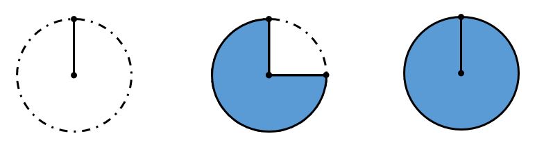

Figure (1) in your sketch shows that if the simulator's small end is larger than 20.1 (middle image) or 19.9 (right side image) it will have to contract to fully contain the feature.
Please refer to my (A) above. In reality any discussion of a truncated simulator is an artifact of physical simulation. The envelope under discussion would extend infinitely, and would therefore be a fully formed cone. No amount of "expansion/contraction" of the envelope would be necessary to simulate a truncated conical feature of any configuration.
Figure (2) shows 2 different fully acceptable simulation results, identical ones. No need to choose among them
If both are acceptable (or presumably anything in between) then this means there is no minimum or maximum. You've just proven my point.
If you prefer to call the apex and axis of a 180° "cone" indistinguishable rather than ambiguous then so be it. I'd rather call it imaginary (made up). If you look at a black surface you can imagine that there is a black ink mark on it, which may be there and may not. If you make a truncated cone into a nonzero size cylinder by folding the included angle about a fixed size truncation at least the axis doesn't disappear. You may disagree but I find the apex less important. When you construct a conical feature on a CAD program by creating a "revolute" you need to define the feature outline and an axis of revolution. The apex simply results from the geometry you create.

I'm not necessarily talking about a physical simulator. Can't a theoretical simulator be finite? Think of a finite theoretical conical surface with boundaries - a virtual envelope with truncation and a base roughly the same distance apart (slightly longer) as they are at the actually produced feature. It can be scaled up or scaled down to contain the feature. I never said it must. I say that if it can, it has what it takes to be UAME per the standard. "In reality any discussion of a truncated simulator is an artifact of physical simulation." - why?
Minimum/maximum can be related to the range of sizes of circular element containing the feature:
Actual produced feature (external conical) #1: 29.8 - 49.75 "minimum contracted"
Actual produced feature (external conical) #2: 30.1 - 50.33 "minimum contracted"

I hope you realize that when I talk about a "range of sizes" along a simulator that contains the feature I am referring to the circular elements along the "used" portion of the simulator - the extent which makes contact with any portion of the actual surface. I do not consider the diameters at the unused portions of the simulator (that just hang in the air or surround other features). This is why in your figure (2) the simulations are identical (same "minimum contracted" range).
The extent of a datum feature simulator should be sufficient to cover the entire datum feature. Beyond that, extent is irrelevant. That's why it's simpler to consider simulators as having infinite extent.
I see no reason it should be for a conical feature considered in isolation. The requirement for a simulator of finite extent is a physical necessity not a theoretical one. If the simulator/envelope needs to be at least as long as the surface of the feature, why not treat it as infinite? Pylfrm just addressed this as well.
I don't follow this logic. Are you saying that a fixed, fully formed conical simulator would be at its minimum or maximum depending on where it contacts the feature? Seems tenuous at best. If the simulator for two different variations of a feature is the same, then it is no more minimum or maximum.

A theoretical finite conical simulator for a truncated cone can be exactly as long as the actual produced feature and it can be seen as an envelope that is able to contract/expand because each circular element along it has size.
I see no reason to consider a theoretical simulator as anything other than infinite. It is the simplest interpretation, and does not involve factors which are secondary to verification of the surface of interest for a primary datum feature considered by itself ie: how much and where the truncation happens. Such truncation can and should be evaluated when conformance of these secondary features is considered relative to the conical surface.
I would say that instead the "physical necessity" of a physical simulator of a certain length is an approximation of an infinite theoretical simulator. If you take the "expansion of circular elements" as well as the "working length" to be properties which support your position, one could consider a planar simulator of a certain area, consisting of circular elements of a certain size (or at least one circular element which describes its outer limit - say if we consider the end face of a cylindrical part), which must increase in area to accommodate a planar feature with a larger area and larger circular elements (or larger single outer element). Would you say this behavior is inherently or truly "expansion" in the same manner as a cylindrical simulator and is it notably different than consideration of a fixed simulator of infinite extent? I would say all you have accomplished is simulating a larger (or different) portion of the infinite theoretical planar simulator.
