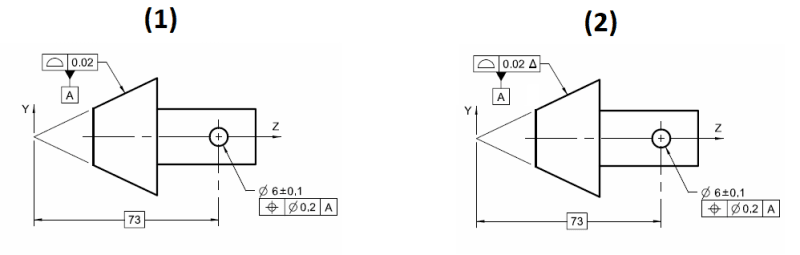

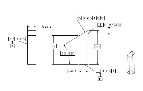

A designer applied perpendicularity feature control frame with the leader pointing to a centerline representing the center plane of an internal taper feature (a "pocket" with symmetrical non-parallel opposed surfaces). I don't consider this specification valid according to ASME Y14.5-2009 but I'm struggling to provide a good explanation of why perpendicularity shouldn't be used this way. The one use of perpendicularity I know when it is applied on a virtual, derived geometry (as opposed to an actual surface) is when a center plane/axis of a feature of size is controlled. It doesn't seem right in the context of a tapered feature, not associated with a size dimension - but I can't form a good argument why. A valid point is that a center plane can be derived from a tapered feature (for example, a datum plane derived from tapered datum feature), and I suppose that a way to evaluate the derived plane orientation relative to a DRF can be found. I need your help, please.

Split the part from fig. 8-19 right in the middle of it. You will get 2 separate parts each with a portion of the original internal feature. The original pocket was a feature of size. Each of the split portions of it is not, and they represent my view on how a non-planar non-FOS looks like. I am pretty sure you get the idea, and if the terms I used fail to describe it properly, you probably can come up with a better definition of your own for this type of features.
If the entire shape including the flat is controlled with a single all around profile tolerance then indeed it is type (b). It doesn't have a defined axis but neither do other irregular features of size such as in fig. 8-19. A geometrical center can still be found.

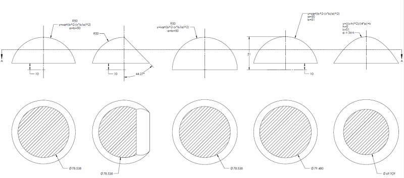

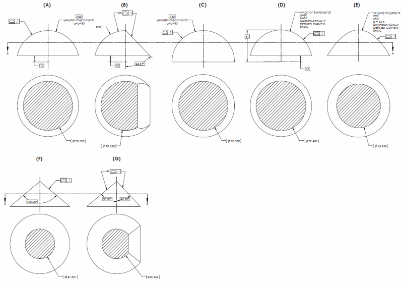

Being able to describe precisely WHY a feature isn't a FOS is just as important (if not more so) as being able to describe why another feature is a FOS. It shows consistency in the criteria and in their application. I'm not really interested in a description of the features themselves, I'm interested in your reasoning on how certain features do or don't satisfy your criteria (or your interpretation of the standard's criteria) of what a FOS is. If these criteria can't be consistently applied in both cases, then either new criteria or a new interpretation should be sought out. WHY do you believe fig 8-19 split down the middle is not a FOS? If your reasoning is lack of a "geometrical center" - what is your criteria for finding such a geometrical center?
In the same vein - WHY are or are not the below FOS?
the ultimate UAME envelope is the one that contacts the high points of the feature in a way that minimizes the distances between its own surface and the actual surface of the feature.
I think this could be defined more precisely.
The requirement that the envelope "contacts the high points of the feature" leads to the question of which points are high points. I think it would be simpler to replace this with a requirement that no points of the feature violate the envelope. Suitable contact would be ensured by the minimization.

Consider the infinite set of all candidate UAME axes that satisfy the position tolerance. For each of these axes, construct a ray (half-line) through each point on the actual feature surface such that the initial point of each ray is on the axis and the orientation of each ray relative to the axis matches the direction of taper and basic included angle specified for the feature. Find the ray with initial point farthest in the direction of decreasing cone diameter. Revolve this ray around the axis to create a conical envelope. Calculate the sum of the squares of the normal distances from this envelope to the points on the actual feature surface. The conical envelope that produces the smallest sum is the proposed UAME.
You're not implying this is the default behavior for the UAME of a conical feature, correct?
I'm only trying to arrive at a precise description of what Burunduk proposes to be the UAME.

A less-than-half-sphere doesn't have the opposed points needed to derive a center point but arguably one can treat it as a surface of revolution. The issue would be lack of an unambiguous location and orientation of a revolution axis - unlike with the cone there are infinite possibilities. For me, the existence of a defined axis indicates (but not a prerequisite to) the existence of an actual mating envelope.
None of the shapes presented nor a cone have opposing points as I defined above. I've already showed a shape which would not have a defined axis yet you consider an IFOSb - namely a cone with a flat (G). I'm still not clear, do you believe the semi-spherical shapes (A) or (B) to be FOS? If so why?
Your argument, like most considering a cone as a FOS, revolves around the derivation of an axis - which is neither explicit nor implied in the definition for FOS, indeed I have already shown shapes which you consider a FOS without a defined axis. In that case you pivot to derivation of a "geometrical center" - another term not included in the standard's definition of a FOS and I have yet to see your definition for such derivation.
All this means the "WHY" I was searching for is still missing. I am still not clear on WHY you determine one shape is a FOS and another is not.

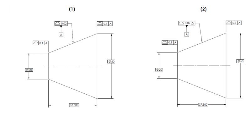

That conical feature could be defined by two basic diameters and a basic distance between them. Since the tolerance zone needs to be only as long as the actual feature, the unmodified profile could reject features produced oversized/undersized. By enforcing the tolerance zone to be between specific diameters and with a specific length, we are no longer able to use different sections of an infinite tolerance zone to always accept features produced with a conforming angle and form only. A modified dynamic tolerance zone would be able to contract/expand maintaining the length of the actual produced feature and the basic angle.
I am not sure either. Judging only by the IFOS type b definition - probably yes. Judging by common conventions and thumb rules about opposed elements etc, they are not.
I agree with chez311 that there is no difference.
Imagine the basic diameters of the circular edges at the intersections between the conical surface and the flat surfaces are 50 mm and 100 mm, and the basic width across those flat surfaces is 25 mm. Now imagine a part produced such that the actual dimensions are 60 mm, 110 mm, and 25 mm respectively. Are you saying that the non-dynamic profile tolerance would reject this part? Even if the flat surfaces had profile tolerances of 10 mm?
I assume you claim that the feature will conform to a tolerance zone that extends beyond the the basic length between the basic diameters.
If the basic diameters of the true profile are outside the portion of the tolerance zone that covers the actual feature, that portion of the tolerance zone is not the intended portion, and the feature does not conform to the tolerance.

Burunduk,
Which RFOS do you imagine doesn't contain directly opposed points?
"circular element, and a set of two opposed parallel elements".
Circular elements only have opposed points if they are part of a cylindrical surface. If the circular element is part of a conical feature or on the curved portion of a feature such as in fig. 8-26 in ASME Y14.5-2009, the normals to the surface coincident with the circular elements will not conform to the opposed criteria.
Despite of the word "opposed", the "two opposed parallel elements" will only be opposed by the mentioned definition if they are on two parallel surfaces, and I'm not sure that this is the intent of the standard. The parallel line elements used as a feature of size could be on a flat taper.
It does not. See my post from 8 Jan 20 19:43: "For me, the existence of a defined axis indicates (but not a prerequisite to) the existence of an actual mating envelope." In other words, not all features of size have axes, but if a feature has an axis there is a very strong case for it to be a FOS, because the feature needs to be "contained" by a simulator in order to derive it, and "containment" implies UAME.
I don't see the involvement of an axis/centerplane as a robust determination of a FOS. A feature could have one possible axis/centerplane, infinite, or none it really provides no real basis to determine if a feature is a FOS. Imagine a single less than half cylinder - one can derive a defined axis but is not a FOS. Conversely I've shown several times features which don't have a defined axis/centerplane but which are clearly FOS. I don't see how "a very strong case" is very useful at all here.
You keep mentioning "contaiment". You have yet to provide a working definition that implies anything more than contact or simply "touching", which as I said I don't see how that excludes any shape/feature including a single planar feature.
Changing the way the basic geometry is defined does not change the tolerance zone. Pylfrm beat me to the punch, but I developed a figure previously so I will share it below. I see no difference between (1) and (2) below - the result is the same as if it had been defined with a basic angle. If you see a difference, could you describe a part which (1) accepts and (2) rejects or vice versa?
If you think of the mathematical term "closed-form", this is not what I meant. The correct wording is "closed shape", I hope you don't mind the kindergarten level link. I guess it is anyway better than my attempts to describe this type of geometries, judging by the outcome so far. If the shapes depicted there were outlines / true profiles of physical features, internal or external, those would have defined UAME forms and should be considered IFOS type b.
I was referring to 3D space, I see you are referring to "closed" 2D shapes extracted from 3D surfaces. I'm still ambivalent about how this is useful for determination of a UAME as well as how it can be more generally applied. A few issues:
- In features lacking a defined axis it is not obvious which cutting plane should be utilized to produce these 2D shapes.
- Features which are obviously FOS may not be made up of "closed" 2D shapes, say Y14.5-2009 fig 4-29 datum feature A which consists of a semi-circular profile or even just a simple width shaped feature consisting of two parallel planes.
- Features which you have already said you don't believe to be FOS like the one on the right from your (23 Dec 19 18:01) post. Lacking a defined axis and from my first point any defined way to determine which cutting planes should be utilized, certain cutting planes will produce "closed" 2D shapes.
Notably in this last case and others (I would say cones and similar shapes as well but we obviously disagree there), 2D shapes/elements themselves may be FOS but that does not tell us that the surface from which they are extracted qualifies as a FOS.
In my recent posts, I talked about centroids, lines through centroids in the direction of extrusion, etc. I guess it is not that important though because as I stated axes and other types of theoretical center geometries are not part of the prerequisites to fitting in the FOS criteria.
So are you implying that I should replace your statement "as long as a geometrical center can be found" with "centroid" instead of "geometrical center" ? Can you provide an example of a shape for which a centroid cannot be found?
If you don't believe that either the concepts of "2D closed shapes/elements" or "centroids/geometrical center" are applicable to determination of a FOS/UAME I would agree - and go even further to say that they are not useful "rules of thumb" as they cannot be generally applied to say whether a feature is a FOS or not, or if they can be I have not seen presented such a consistent way to do so. See my previous post on opposed points for what is in my opinion a more generally applicable and unambiguous rule of thumb.
What we are left with is still, as I mentioned further up in this post, your statement about "containment". Clarity as to what you mean here would be helpful.
If you believe (A) and (B) are IFOSb then (1) I think you'll find yourself even more alone in that viewpoint than on cones and (2) I am tending towards the fact that your interpretation allows almost any shape imaginable to be an IFOSb. I know you have stated several shapes which you do not believe are FOS - but without a more consistent and precise interpretation than whats been provided thus far I don't see how you reconcile those with (A) and (B) semi-spherical shapes (really I would say in addition to (G) too).
You are conflating two different things - the 3D surface and the 2D elements extracted from it.
Take a cone for example.
2D circular elements extracted by intersection of the cone with a cutting plane - in the 2D space all points on the circular element have directly opposed points with normal vectors on said cutting plane. The circular element is a FOS.
3D cone - in the 3D space no points on the cone have directly or indirectly opposed points with normal vectors in 3D space. The 3D surface of the cone is not a FOS, despite containing 2D elements which are FOS.
pylfrm said:
The procedure I described is based on minimizing the separation between the envelope and feature
... which for regular external features of size always equivalent to minimizing the size of the envelope, and for irregular features of size equivalent to scaling down the envelope.
Assuming we're still talking about minimizing the sum (theoretically the surface integral) of the squared separations, that is not true for a nominally cylindrical or nominally square hole. I'm pretty sure it's just generally not true.
For a counterexample, imagine a nominally cylindrical hole that's actually produced more like a short slot with two flat sides connected by tangent cylindrical ends. If the flat sides are slightly non-parallel, one of the ends will have a slightly larger radius and will end up coincident with the maximum inscribed cylinder UAME. On the other hand, the least-squares cylinder will be smaller, contacting the flat surfaces roughly in the middle and equalizing the separation with the two ends.
For different actual conical features with the same basic included angle, you should use different sections of the "axis-revolved ray" theoretical surface as the envelope according to the different ranges of diameters.
Why shouldn't I use the entire thing? When would I care about anything other than the five parameters needed to describe the location of the apex and the orientation of the axis?
Correct. In general, I claim that the tolerance zone covers the full extent of the actual produced feature.
Consider a related example where the drawing specifies a short piece of tube with inside diameter 50 mm BASIC, outside diameter 100 mm BASIC, and length 25 mm BASIC. A profile tolerance of 0.02 mm without datum feature references is applied to one of the flat end faces. Now imagine a part produced such that the actual dimensions are 60 mm, 110 mm, and 25 mm respectively. Cylindricity, concentricity, flatness, perpendicularity, etc. are all perfect. Would the profile tolerance reject this part? What if a flatness tolerance had been specified instead of profile?
How would you suggest the requirement be expressed if my interpretation is the intended meaning? I should clarify that the 10 mm profile tolerances mentioned in my previous post were intended to become part of a simultaneous requirement with the 0.02 mm profile tolerance.
Think of a tab with an inclined top face controlled by profile and defined with 2 basic linear dimensions and a basic angle realtive to a horizontal bottom face referenced as a datum feature in the profile FCF. What controls the height (location) of the inclined top face relative to the bottom face?
Nothing that you've described. The profile tolerance would be equivalent to an angularity tolerance except for the simultaneous requirement rules.
Two nonparallel planes don't have a location relationship. Three nonparallel planes have a location relationship if they are all perpendicular to a fourth though. If you want to control something beyond angularity of the inclined surface, involving a third surface as a secondary datum feature reference or controlled as part of a simultaneous requirement might achieve your goal.
What is the meaning of the two linear height dimensions?
As always, the meaning is that they define some aspect of the part's basic geometry. Whether that aspect is relevant or not depends on what tolerances are applied.
I think I understand how a simultaneous requirement might help (considering the different tolerance zones as part of a single structure tied with the basic dimensions) but I don't see how additional datum features make difference in the context of what I described. See the image below. Full DOF-constraining 3 planes DRF is defined. Also there are three nonparallel planes that as you say should have a location relationship since they are all perpendicular to a fourth. Would this prevent accepting a part produced with distances of 19 and 22 where the basic 17 and 20 are given? If yes, how?
Edit: After giving it some more thought - would you say that the feature produced with 19 and 22 heights will be rejected because the height of the intersection lines between the considered feature's tolerance zone boundaries and datum plane C is defined? Similarly to how the intersection with datum axis A is defined in fig. 8-13?
Yes.
My previous post was based on the assumption that the horizontal bottom face (now identified as datum feature B) is the only datum feature reference of the profile tolerance. I probably should have stated that assumption more clearly.
