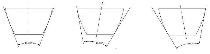

A conical simulator for a secondary datum feature will probably need to expand or contract or progress from MMB to LMB (for external feature) in a way equivalent to how it is shown in fig. 4-31 illustration (a) for a planar feature, which in my opinion could be added to the examples of "the second type of behavior" by pylfrm.
I am largely in agreement with this. This would be indicative of the behavior of a RAME and is the reason a nonFOS as shown in 4-31(a) can have an MMB.
As a result could one make an argument that when referenced with appropriate datum references (ie: sufficiently constrained), a cone or planar feature is an IFOS? Perhaps, seeing as the actual definition in Y14.5-2009 only specifies that a IFOS can contain/be contained by an AME - it does not say which type. In Y14.5-2018 this has been changed to explicitly state that an IFOS can contain/be contained by a UAME.

Regardless a conical/planar primary datum feature or feature without sufficient constraint (due to datum references and precedence) does not exhibit this second type of behavior, at least not without unlimited offset.
Burunduk said:
But, this is what the standard we work by prescribes, and - for a conical simulator I would say "maximum possible contact" or a term I personally would prefer - stable contact is less ambiguous than in the planar case, because of the centering and effect of cone-to-cone interaction.
I think you'll find that the amount of stability and rocking between a planar and conical feature with convex error is extremely similar. The latter may seem more stable because of the effects of friction, gravity, and compliance of both part and fixture/simulator - if you have a part which is light enough (and with a low enough friction coefficient) to not wedge itself into the simulator or whose simulator is oriented in such a way that gravity does not aid the wedging action (does not act along the simulator axis in the direction of the material ie: a simulator oriented sideways with the simulator axis parallel to the ground) or even a part whose mass is not symmetrically distributed around the conical feature of interest this instability will be more apparent.
When the geometry is considered the behavior (rocking/instability) of a conical feature is very similar to that of a planar feature with convex error.
In general, determination of a feature's UAME (if it exists) or RAME(s) doesn't have anything to do with the tolerances that are (or are not) applied to that feature.
This was the key point that I was missing, I got tripped up a bit thinking they might be one and the same or possibly coincident (ie: true profile which defines the tolerance zone and true profile used as the basis of uniform offset for a UAME/RAME).

About the issue of potential rocking/instability of a cone at the interaction with a simulator - similar behavior will be observed when an undisputed feature of size such as a cylinder or width-type feature is produced with a convex error. Most features, regardless of type, are expected to experience the analogical consequences of form error. In the context of the analogy between a cone and a cylinder - it can be noted that a 1 degree included angle cone will be almost identical in all aspects to a cylinder. I generally don't find it very constructive to discuss this type of extremes but since you brought up the 179 degrees cone earlier in the thread - there is your counterexample.
Not always. Imagine a modified version of ASME Y14.5-2009 Fig. 4-44 where the large cylindrical surface is identified as datum feature B, and the position tolerance references |B|A| instead of A.
Since the referenced discussion is of secondary conical datum features, did you mean |A|B| reference for position? And, what is datum feature A in the modified case? Is it the cylindrical shank or the flat shoulder?
Sorry for that, from some reason I read conical instead of cylindrical. I agree that in this case the simulator should not be required to progress, as there is no basic location constraint other than coaxiality.

I'd say this second type of behavior involves the defining characteristics of an AME, or UAME in the special case of a primary datum feature reference. The first type of behavior does not involve these characteristics, but it's the only viable option for a conical primary datum feature reference.
a primary datum feature simulator is not constrained to a DRF and doesn't "acknowledge" any theoretical boundaries/envelopes that are fixed in location; it "recognizes" in space nothing but the feature that it simulates. Therefore measurement of offset, limited or unlimited, to a fixed (relative to what?) "true profile" boundary/envelope is not required
The true profile of a UAME would not be fixed or constrained by definition, I don't think I said otherwise? I'm not sure I follow why you don't think offset is applicable in the case of a primary datum feature in which the UAME would be the envelope of interest. Take a cylindrical feature defined with basic dimensions called out at RMB as a primary datum feature - the UAME would uniformly offset from the true profile in the direction of the material until it reached a minimum (for an external feature) or a maximum (for an internal feature). This would be the second type of behavior pylfrm mentioned, the fact that this results in "nonsensical" behavior for conical/planar primary datum features (and therefore the first type of behavior is the only viable option in those cases) doesn't mean it doesn't apply to other types of features during primary datum feature simulation.
Under most circumstances this is not the case as a local minimum or maximum can be found. This was discussed at length in ( and I showed in my post on (18 Mar 19 16:54) that only with significant form error and a high width to length ratio will such behavior be possible. Convex error in most cases will not result in such behavior. Pylfrm also shows this in the post (19 Mar 19 05:28).
The same cannot be said for planar and convex features - any amount of convex error will result in the potential for rocking and instability.
I disagree. The behavior of a cone with 1 or 0.1 or 0.001 degree included angle will be very similar to any other cone and fundamentally different than a cylinder, although such differences may be difficult to discern with the naked eye when looking at a physical part.
Lets break down their behavior in context with the concept of uniform offset from the true profile - if we take the radial (normal to the axis) and axial (parallel to the axis) components of the uniform offset to be r_offset and a_offset respectively, a planar feature or cone having 180deg included angle has an r_offset/a_offset = 0, a cone having an included angle between 0 and 180 has an r_offset/a_offset which is some real nonzero number, and a cylindrical feature has an r_offset/a_offset = undefined (ie: if r_offset is some real number and a_offset is zero therefore r_offset/a_offset = undefined). In contrast to the cylindrical case, r_offset/a_offset for a cone having a nonzero included angle (whether that be 1, 0.1, or 0.00001) approaches infinity as a_offset approaches (but never reaches) zero. A cone with a nonzero included angle will always have a nonzero axial component of the uniform offset (a_offset) and a cone having a 0deg included angle is simply a line.
To put it more simply a cone and a cylinder are fundamentally different as the former has an intersection point (vertex) and the latter does not. As the angle of a cone and therefore this axial component (a_offset) becomes very small it may appear to approximate a cylinder and in physical simulation may behave similarly due to the effects of friction and compliance (and indeed no physical part/simulator/fixture/jig/etc.. is perfect and most produced parts will have "conicity" error at some resolution) but geometrically if we consider the ideal/theoretical shapes the two are still fundamentally different.
