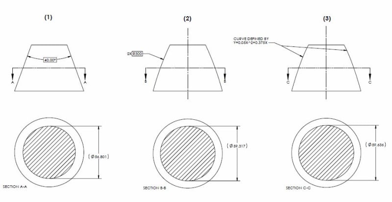

No, curved open surfaces are not, a less than 180° arc is not.
Yes I agree but I am interested why you think so. See below for three different features which I think satisfy your aforementioned requirements. All have circular cross sections - none of which I believe to be FOS. (2) and (3) would behave similarly to a conical feature (1) on a simulator namely "As long as it's set, it contains/being contained".
Note (2) has two opposed circular arcs - I did not include a dimension between the centers as they are 500mm apart.

Yes, but that doesn't make the theoretical envelope that constitutes the unrelated actual mating envelope any less "unrelated", the base doesn't act as a datum feature and doesn't constrain the envelope, not in orientation, and certainly not in location, so I don't see where the problem is.
Regarding the 3 figures at the end of your post, I don't see why any of them can't be contained by a potential UAME simulator of the exact inverse theoretical form of the feature, edit: except for the one reservation I already mentioned several times - the requirement for adjustable size of the datum feature simulator.

1. I don't think the interpretations of true profile itself are any different, its the application of the true profile to the definition of UAME that is beyond the definition provided by the standard.
2. I think I see what you're getting at here - I'm not sure I can satisfactorily answer this. I'm hoping pylfrm can perhaps help clarify this a bit.
3. If we can derive an axis from the UAME then it is because we can derive an axis from the true profile. I would say they are related because they are the same axis.

Reconnecting this to the FOS/non-FOS subject, should the main question be whether a tapered feature can constrain the simulator of the related actual mating envelope when it is prescribed to behave as in the "second type of behavior" you described above?
Although it's not explicitly stated, I think the actual mating envelope that's relevant to the definition of 'irregular feature of size' is the unrelated one. Higher-precedence datum feature references would need to be involved for a related actual mating envelope, and different choices of those would lead to different answers. I don't think that would make much sense.
the behavior which allows expansion of a cylindrical simulator until it reaches a maximum limited by the feature (envelope offset from the true profile) is fundamentally different than the ability to set a conical feature on a conical simulator (envelope coincident with the true profile). The takeaway being that the former behavior is required for UAME simulation.

Then let's discuss it. A conical simulator for a secondary datum feature will probably need to expand or contract or progress from MMB to LMB (for external feature) in a way equivalent to how it is shown in fig. 4-31 illustration (a) for a planar feature, which in my opinion could be added to the examples of "the second type of behavior" by pylfrm. If for the part in that figure we would rely on the ability of the actual feature to limit the movement of the simulator, then there too unlimited offset of the simulator from its initial position would occur, as the part would rotate around the primary axis. Instead, there are two restrictions imposed by the standard:
1. The range of translation of the simulator is pre-limited from the MMB to the LMB, there would be no purpose in crossing these limits - don't see why this can't also be the case for a secondary conical datum feature (this echoes my previous attempts to convey the need in replacing "true profile" with MMB as the origin of the offset in question). Regarding MMB my assertion is that for any closed surface (including conical) defined with basic dimensions and a profile tolerance a maximum material boundary exists (I.e. outer boundary for an external feature). This alone already makes "unlimited offset" impossible.
2. The simulation is required to stop when "maximum possible contact" is made. I don't like the concept of maximum possible contact either - if the surface of datum feature B is produced as a convex arc (within its planar profile tolerance range) then maximum possible contact is pretty much ambiguous. But, this is what the standard we work by prescribes, and - for a conical simulator I would say "maximum possible contact" or a term I personally would prefer - stable contact is less ambiguous than in the planar case, because of the centering and effect of cone-to-cone interaction. This further rejects any type of "unlimited offset" during simulation.

... Although it's not explicitly stated, I think the actual mating envelope that's relevant to the definition of 'irregular feature of size' is the unrelated one
Then, if it is still the primary datum feature simulation / UAME simulation under question, it seems that "unlimited offset" issue is eliminated in that regard:

I do not understand "uniform offset from true profile" for a conical simulator. For me, it makes as much sense as talking about "uniform offset from true profile" for a planar datum feature simulator and claiming it may become "unlimited" during a simulation.
The point is that planar primary datum feature references don't behave in that nonsensical way, and neither do conical primary datum feature references.
Per the above, for a conical feature, there is no issue with the simulation of the type of AME that defines an irregular feature of size.
