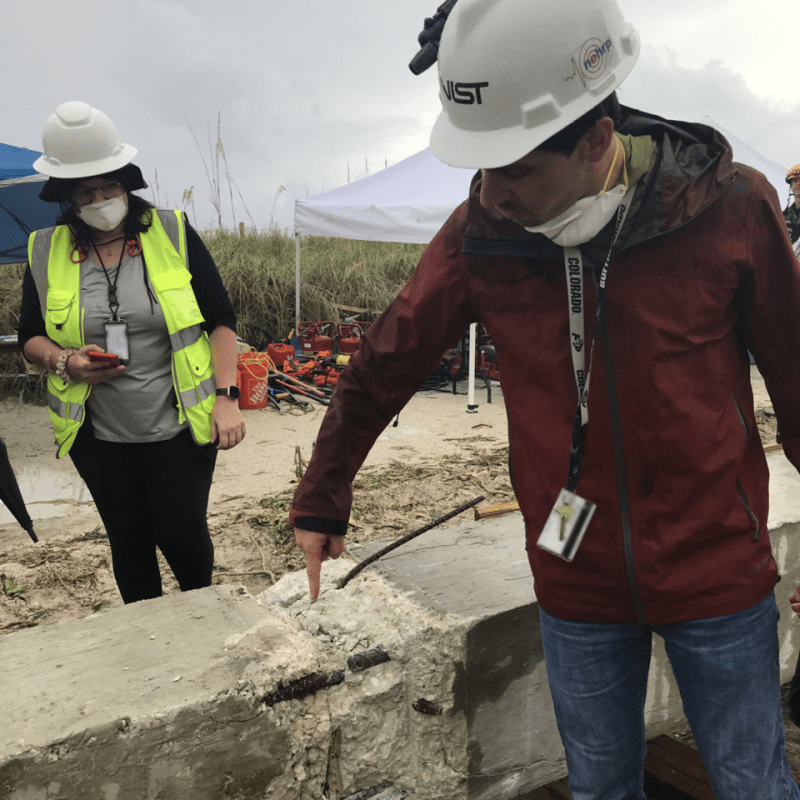

NIST researchers at Champlain Towers
Do I see cold joints top, bottom, and side of the column? Is this the standard way for slab and column to be cast?
Now I can see it better, what I though were smooth failures at the sides turned out to be rebar, sorry.

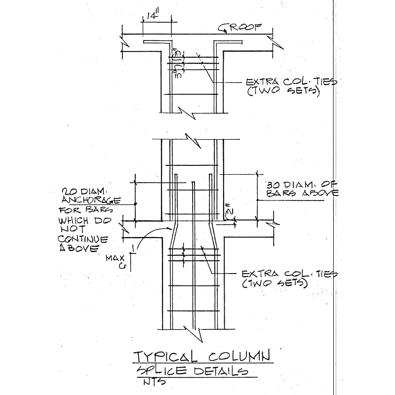

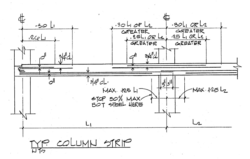

Yes. The photo shows a column extended through two levels, the lower to the left and the upper to the right. The rebar from the lower level is crimped so that it laps up to the inside of the upper level column rebar (the photo can be misleading seeming to to show the lower level rebar terminating below the upper level rebar). One can also infer from the photo that the upper level column rebar was stood in place prior to the casting of the floor slab.
The slab rebar in your photo is extraordinary for its paucity.
I'm curious as to what the inspector is pointing too but the photo does not lend much to positive speculation on that.

You can also noticed the burnt ends, which shouldn't be. The gas axe shouldn't have been anywhere near that.
Maybe I read the wrong article, but are there really people now trying to say the building had too much rebar and that's the issue?
@Demented, One wonders why the gas axe was needed, if the rebars were detailed on shop drawings by fabrications shop, cut and bent to exact lengths, and tagged or marked according to shop drawings as to where they go. Of course, you have to be willing and able to read and understand the shop drawings during assembly?
Edit: Perhaps gas axe used to adjust for as-building errors? Or using wrong rebar in wrong location? Or Who needs Shop Drawings, just build on job site on the fly?
Demented (Industrial)8 Aug 21 20:26 said:
... the building had too much rebar and that's the issue?
It may have said that, but I understood it to mean the column was to narrow for the required rebar. (also, the NIST photo seems to show all the rebar very close to the bottom of the slab. Yes, that's where the tension is, but was there sufficient cover?)

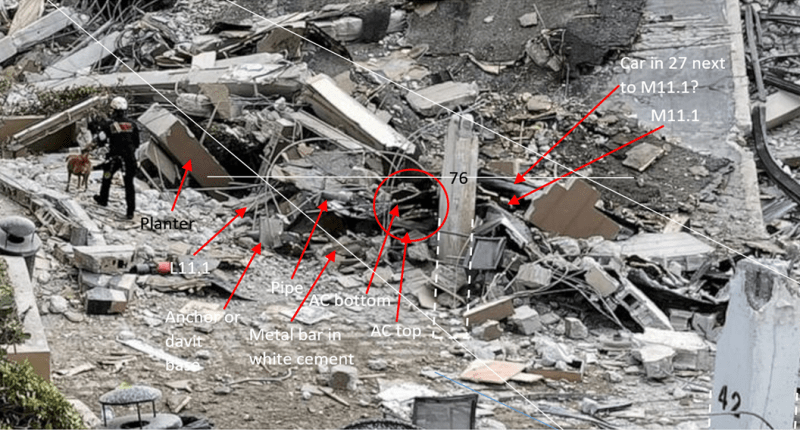

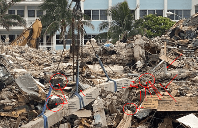

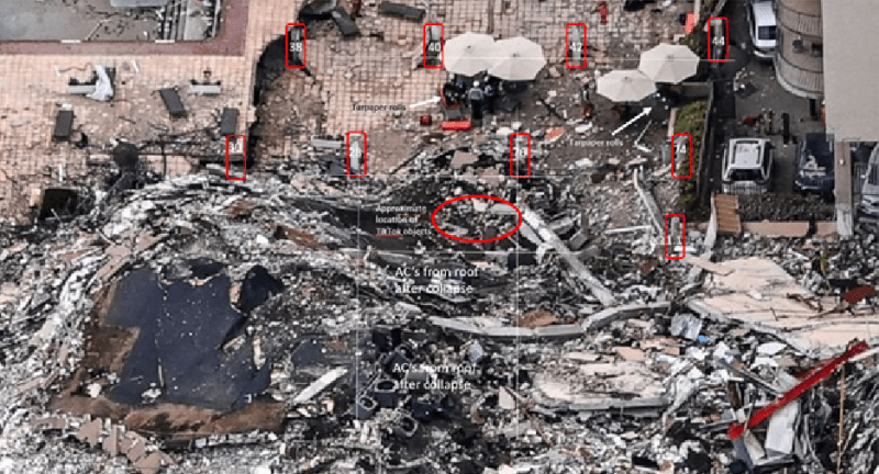

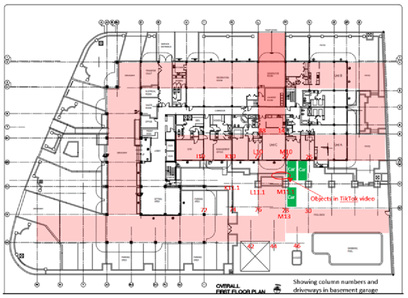

In the next figure, column 76 and column 28 can be seen on the pool deck after the collapse. By noting that column M11.1 lies in a line with column K11.1 which also can be seen in the figure, one can establish that the TikTok objects should be located approximately within the red ellipse in this figure. Note that under the umbrellas in this figure one can distinguish multiple rolls of tarpaper, which were suspected by some to be vaguely visible in the TikTok video.
In the next photo, which shows the region of interest from a different angle, I have zoomed in on this region of interest. Sure enough, one can see the same objects that were found in the TikTok video still located on the basement floor under only one layer of debris from the roof of the east wing that collapsed last. One can easily distinguish the top of an air conditioner and the bottom part of the same air conditioner behind it. One can also see two hexagonal weights on rods, one on each side of the air conditioner, along with pipes, a planter, and a long metal bar attached to a cement column that were seen in the TikTok video.
One can see these same TikTok objects in the following photo taken after the west wing of the building was demolished. These objects can be seen more easily by zooming in further on the ellipse, which can be done using the PowerPoint document provided with this post. Again, it is easy to distinguish an air conditioner under the pile along with two hexagonal weights on rods and pipes seen in the TikTok video. In addition, things seen in this photo that could not be seen in the previous photo include tarpaper rolls within the field of view of the TikTok video along with a car in parking space 26 and another white car in either parking space 28 or on the driveway behind the TikTok objects.
These two photos not only show the same objects seen in the TikTok video, but also the same objects that were seen on the small debris pile left at the end of the ramp for two days when everything else in the parking basement was removed. It is believed that the recovery crew leaving this small debris pile standing for two days was an indication of its importance as supported by red cones connected by red tape left on the ramp and by seeing five Miami Dade firefighters witness every shovelful of debris removed by the crane operator when clearing this region.
I will not go into the implications of these videos at this time. I suspect it will be controversial enough to establish that the main object in these photos is an air conditioner that appears to have dropped from the roof onto the beam between column 27 and column M11.1. This object appears to have sheared the horizontal beam from column 27, thereby eliminating horizontal support from column 27, and initiating the collapse of the pool deck and then of the building itself, just as was seen in the CCTV surveillance video. This appears to be the trigger that caused the collapse. All of this would have been aided by the design errors and construction deficiencies discussed in the Miami Herald article.
The objects in these photos should be viewable much more easily than those in any of the previous photos I have shown. If anyone still persists in saying that there is nothing in these photos and that these objects are all a figment of my imagination, then they are taking a gamble that the final report for this collapse will contain evidence of these objects and maybe even cite them as the trigger for the collapse. In this case deniers of this evidence and those who ridicule it will look foolish indeed.

Are you calling the fire fighters sitting at the table roofing rolls?
I swear I've got a higher resolution photo from one of the FR teams somewhere that shows the fire fighters taking break time there in the mid-day heat.

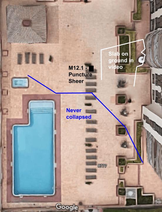

What we read in Miami Herald investigation based upon their design based calculations, may be giving the As-Built Condition too much credit, since nothing seen so far in public information indicates the building was built as well as the suspect design.
Edit: The garage floor slab appears to have fared well from collapse and heavy construction vehicle traffic during cleanup.

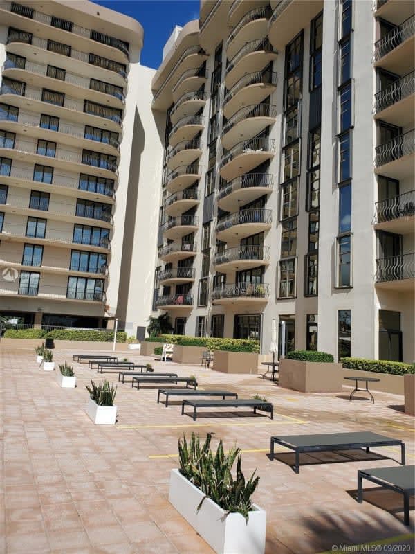

I have attempted to find a trigger by assuming that the drains in the planters were clogged and the planters had filled up with water. How much would this water have weighed? The full version of Acrobat has a measuring tool that can be used to estimate the dimensions of the planters and therefore the area. Based on a photo of the planters, I assumed the height of the planters was about 1 meter.
I assumed water so I used a density of 1, then converted back to pounds. Based on the photo below,
I estimated the additional weight of planters full of water due to the rain at about 85,000 lbs. The structural engineers will need to opine if this was enough weight to trigger the collapse, given the deteriorated state of the slab, the extra weight of the additional layers of tile and the poor initial design. Just a thought.
