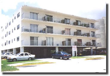

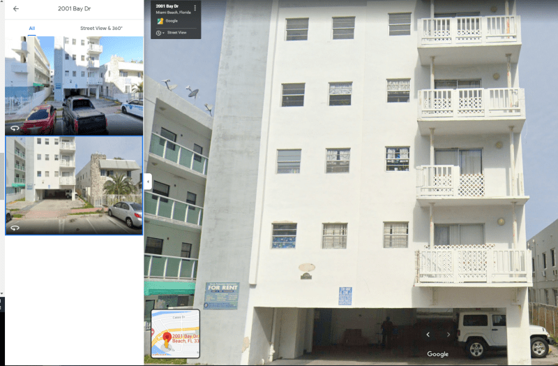

This is owned by the Mayor of Surfside. He's freaking out for a reason, and it's not because he cares about Surfside.
The surfside building department is under some heavy scrutiny for many many reasons. With all we've seen so far between files missing, no organization, a whole slew of not caring by officials, the above by the Mayor; even if they hired the best engineer in the world, I don't think we can trust the Town of Surfside here.
