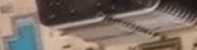

Below is a close-up of the CTS roof taken on 6/22/21 obtained by zooming in on the aerial photo supplied by Santos81. The brightness has been enhanced to provide greater contrast, but nothing else has been changed.
With the brightness enhanced, by comparing the photo to another photo taken of the same rooftop taken on 1/16/21, one can distinguish that the following things have changed:
1) Several objects have been added to the 88th street side (north side) of the roof by the roofers, including possibly a cache of tarpaper,
2) Two men can be seen bending over the parapet from the 12th floor roof to the penthouse roof on the 88th street side (north side) of the roof. One is on the penthouse roof side of the parapet and one is on a removable ladder on the 12th floor side of the parapet.
3) One of two air conditioning units that were in a row by themselves on the middle part on the south side of the building can be seen to be missing.
4) A bright object that can’t be distinguished is present between the built-in ladder going over the east side parapet wall to the 12th floor roof below and the south side parapet wall over the planter on the patio. This object may be the missing air conditioner awaiting removal either by a crane or by hoisting it over the east parapet wall to where it can be taken through the door on the 12th floor roof to the elevator.
5) A second bright object that can’t be distinguished is present on the 12th floor roof near the base of the stairs going up to the elevator house. This may another air conditioner unit awaiting removal just like the one above.
6) By enhancing the brightness of this photo a second time, one can vaguely see what may be a beam outrigger with counterweights on the penthouse roof going over the south parapet wall over the planter on the patio. With an optional hoist attachment, this outrigger beam can be adapted to lift heavy objects like an air conditioner over the parapet wall, such as over the east side parapet wall to the 12th floor roof below. This is not a verification that such a beam hoist is present. But air conditioners can be removed from the roof only by using a crane or by some kind of roof hoist. So if a crane can be eliminated, a roof hoist can be verified.
It may be just an artifact of increasing the brightness, but does the edge of the parapet in the area of the possible beam outrigger look straight? It doesn't to me.
MarkBoB2 said:
It is recommended that readers copy the photo above and paste it into a PowerPoint document, where it can be zoomed in on to help see the objects. To further help readers, I have enclosed a PowerPoint document containing this photo along with ground truth photos from 1/16/21 for comparison. Readers can vary the zoom on the photos in this document to verify how the images were made and improve their ability to discern the objects. A high resolution display will help immensely in such viewing. I have used a 1920x1280 non-interlaced display for such viewing. If one uses a smaller display, like a 640x480 interlaced display, then the photos well likely be blurred beyond recognition. If readers lack a high resolution display, I suggest taking a digital copy of the photo and the PowerPoint document to a Microsoft computer dealer to view them on a good high resolution display.
That picture is roughly half a mile wide over 2,500 pixels. That translates to each single pixel representing 1 square foot of reality more or less.
And you’re telling us you can discern people on ladders in it???
That’s bonkers.
This smells more and more like some intricate troll but I can’t say that I can understand it.
Honestly... at this point I'm just here for the MarkBob2 (et al) posts.
My own sanity and the memory of William of Ockham be damned, I'm all in! It's like Tobias Fünke himself is now dabbling in forensic engineering, and I think we can all agree that's awesome.
2000's calling to get their high quality 1920x1280 display back. Can't tell if trolls or not at this point either.

Re image interpretation: at high zoom most software smooths things out for you. Turn all that off and you see the pool is at best 20 pixels wide, a floor of the building is three or four. About 0.5m as per Spartan's calculation. Anything smaller is a blur across one or two pixels and objective identification is physically impossible. When you know something is there (eg the roof anchors, the floors) you can clearly spot them. What is happening here is that a pre-xisting mental model is being recognised in the data. In that case the mental models are based on verifiable facts so no problem occurs. In the absence of a verifiable basis for a mental model, minds do their best and recognise suppositions they find reasonable, some more creatively than others. Reasonable only becomes factual though when some other data supports it.
