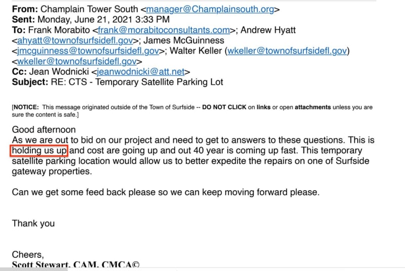

The residents were complaining about the structural engineer who seems to be related to the roof anchor contractor 3 days prior to collapse in this email:
My concern is Morabito Consultants would recommend demolishing the remaining building to eliminate any evidence. Due to the transfer slab on the second floor, I believe most of this building is stable with enough shoring. It was stable enough to resist progressive collapse. Most of the shear seems to be in the remaining building. In my opinion, they should have shored the accessible parts of this building on day one.
As the inspection records the city has posted only go to 2019, I have sent this to the city. If the anchors installed that day were over x11 stack we have a very solid hypothesis.
Morabito has no say in the matter. It’s still an active search and recovery mission with multiple Federal, State, and County Investigations in the early stages. Until it’s forensically cleared and evidence taken to the secure location, the site must be viewed no different than any other mass casualty crime scene. This includes FOIA requests. Until they’re deemed no risk to any investigation, they won’t release them.
