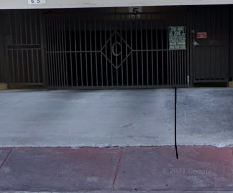

although it’s hard to rule out an HVAC unit as the round object in the garage debris.
One of the round objects is the marquee on the vehicle gate. The other roundish object down in the debris field is possibly the patio furniture from 111. It’s hard to see but the pedestrian gate for the terrace of 111 appears to be just inside the right arc.

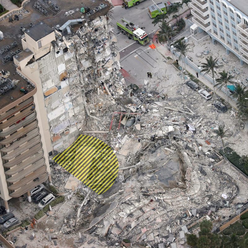

My working hypothesis (for now) is that the precipitating event occurred at or near the 111 planter (the bushes seem to be visible in the TikTok video). Either the slab beneath the planter gave out from the combined effects of corrosion and neglect (perhaps related to that hole/damage visible in the overhead pic) or the column beneath it collapsed somehow. The collapse then spread to the rest of the pool deck, I would imagine similar to this:
I wonder how consistent this failure pattern is. Would this mean that the more distant pillars will usually have columns puncturing the slab, but the slab nearest the failed pillar would break across its entire width? That would suggest that the upper parking deck failure happened first, as that’s the only part we know of where the slab “hinged” rather than punctured.
Edit: scratch that. It looks hinged because it’s resting on cars.

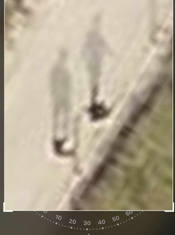

Santos81 said:
the center is probably a black cleanup bag stuffed in the bore hole and spread out with sandbags around the perimeter
Actually probably is a person as you first suggested. The picture was probably taken at 10:39 when the sun azimuth was 149° (By rotating image and looking at angle) and at 37° elev. Object height will be 0.60 * shadow length.
This is slightly Northeast on one of the paths near the beach. Two people. Another nearby (not this image) probably walking a dog. The white band around the dark person is probably an image compression artifact.

It does sound like punching shear was a factor, as there were plans to add to the slab thickness at some columns. Whether that scheme would have overcome the punching shear susceptibility is questionable at best. One thing I would look at with the pieces of columns remaining is evidence of effective slab depth at the columns. A favorite builder's trick is to pour columns a bit high to simplify floor formwork, and that can drastically reduce punching shear capacity.
One has to wonder - with so many columns punching through, was it really a column failure at K/L-9.1/10? This would suggest that only three columns were seriously degraded, but the slab everywhere else was.
The roundish object is likely an object in front of the vehicle. The reason I suspect a pickup truck is the square box that abuts the "broken column" (if that's what it is). The roundish object could be the wheel well or not.
What is missing in the frame grab is the column at the back of stall 27 which is why I pose the hypothesis that the two concrete peices bent over the back of the vehicle are the remains of that column.
Additionally, if the slab dropped into the parkade, I would expect a notable depth of debris on the parkade floor but I don't see that.
Fair game on calling whether the vehicle is parked sqaure in the stall or not. At any rate, I hope it is useful to post my suggestion as to what the image shows and its positioning beneath the pool slab/building footprint. I didn't expect to get that much out of this little project. I only did one frame and perhaps other frames can lend more clarity but of the ten frames that I glanced at, this one seemed to offer the most clarity.

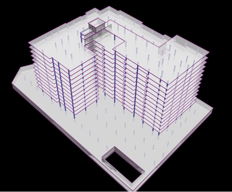

A chilling animation of what likely happened, and worse. The animation is likely predicated on sound (but marginal) column caps. From the images of the actual collapse, the column caps or what was left of them (after corrosion) were minimally provisioned and gave up without a fight, ergo, after the first column or grid line gave out, the remaining slab came down as one piece.
The site seems to not like me. I’ve twice composed an extremely thorough reply and hypotheses but find myself logged out automatically by the time I get to submit.
In the mean time to be brief:
The vehicle in bay 27 is a SUV (possibly a Ford Explorer) positioned head in. The square box is a planter from outside 111, but I’m not convinced it’s the one in cluster positioned directly above the column that is no longer visible. I think it may be the one to the west.
I don’t see a failure of the pool deck occurring first; rather a slow column shear failure below the pool deck that is made unusual due to the already deteriorating structure and pendulum behavior of the planter as it separates from the slab. This generates a non-linear alternate load path that spreads out in an almost circular motion. Of the elevated pool/plaza deck, the parking area seems to be last portion to fail but the load is still continuing back through the superstructure at the lobby level until it too cannot carry more.

There is a significant amount of debris missing where the first collapse section appeared to drop straight down. It should be piled up three or four stories deep like the rest of the pile.
Also,some interesting items atop the debris pile. The northeast stairwell wall (I believe a section of five of the uppermost floors) landed about 100 feet from its origin.
Strings of column sections (a total of ten make that nine, in one string) all detached from the slabs and apparently falling over as a single item.
I believe a significant portion of the south side may have collapsed slightly northwards. If you study the collapse video closely, the southwest quadrant of the penthouse and access corridor appear to hinge downwards on roughly the 4 line of columns (the north side of the corridor on all floors). If that was representative of most floors, the slab hinging on the 4 columns, the debris pile would be moved a little to the north.
