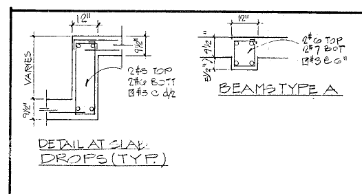

Good eye. I wonder if the beam was even there? Per the typical beam detail the top bars (2 #6) should have 180° hooks. I would think there would be major damage to both columns if those pulled out....
I'd be curious to see as built conditions at lobby level <K/14.1. The way the 14.1 beam connects to the column west of the 1' step at K.

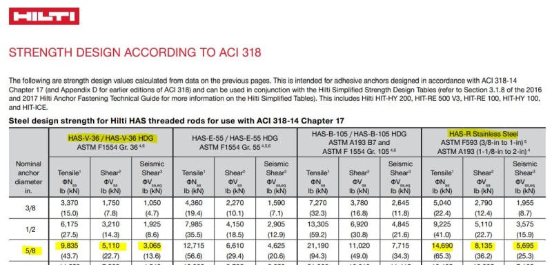

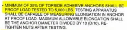

Yes, we all agree the structural plans are a mess, but I think the roof anchor plans are a mess too. This work was occurring the day of the collapse. So I continue to start there as the initial cause. Remember the Kansas City collapse was down to a simple bolt detail.
The reading of this note appears incorrect:
The 5,000 lbs. testing number doesn't make sense with the Hilti adhesive anchors.
HAS-V-36 et all is carbon steel and HAS-R is stainless steel and both have very different capacities at 5/8" dia.
Stainless steel should have been used due to being near the water but "carbon steel" was specifically stated in the note on the plans.
And, neither of them divide to any reasonable multiple of 5,000 lbs. for testing, but the OSHA rule does for the entire assembly including 4 x adhesive anchors do see below.
The OSHA Rope Descent System (RDS) Anchorage (not a fastener) needs to withstand 5,000 lbs. ultimate load in any direction.

My hypothesis continues to be:
The roof anchors were installed on the cantilevered sections of the roof (not per the plans, this is evidenced by actual installation on the remaining portion of the building.)
Then the fall protection anchors (either the entire assembly or only the adhesive anchor fasteners) were tested at much too high of a force (note on plans is unclear.)
This improper placement and testing then damaged the concrete roof slab above the penthouse over the x11 unit.
This concrete slowly failed through the evening, completely failing that night around 1 am causing the cantilevered portion and parapet to crash onto the pool deck and into the backside of column I/12.1

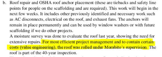

Morabito is the structural engineer and someone with that name works for the roof anchorage contractor - they are located within 20 miles of each other near Baltimore, MD and they both also have offices in South Florida.
I'm pretty sure they have a relationship.
The roof anchorage contractor appears to have been doing unpermitted work, they pulled their permit the day of the collapse.
With that said, I don't think we should rely on Morabito's statements at the current time.
I believe it's likely Morabito emailed the report to the city (they received it after the collapse) in an attempt to divert attention and cover up a roof anchorage mistake.

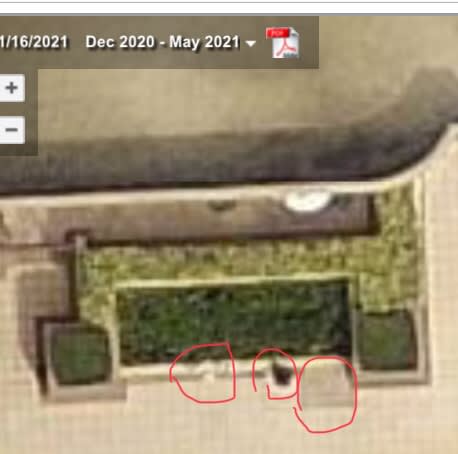

Well, as we suspected, there's my barricade I mentioned in the previous page of the thread
I looked at (Switch to top view)
where you pointed out the barricade is on the West side of the square planter box sitting on M11. In the image it is the square planter on the right. The barricade was where I drew the rightmost red circle. DB27 pointed it out too. Left square planter is on L11.
Can anybody identify the three circled features, they were not there a year before.
I think the photo of lucky555 is from another place. The sun angle does not make sense. It’s morning or late afternoon, then eliminate when the building would cast a shadow. Also the pavers/tile and layout is different.
Even though the note states "carbon steel", the HAS-R is stainless as you noted. If you specify HAS-R, they will (should) install HAS-R. If not, and an inspector catches it, they would be made to replace and relocate the anchors.
The Hilti design tables you are referencing (above) are only for the steel strength of the anchor. Steel strength rarely controls. Generally, pull tests (tension only tests) are used to test the anchor/adhesive bond strength, and the base material's (concrete) in-situ strength. 5000lb is roughly 90% of the design strength of this particular anchor in 3000psi concrete (roof slab), and the controlling limit state is concrete breakout. Steel strength utilization is about 40%. I suspect the 5000lb proof load for the anchor is not necessarily related to the 5000lb rating for the actual davit/anchorpost assembly itself.
I see what you're getting after, but I still find it very unlikely that anything dealing with these davits/anchorposts/whatever, had anything to do with the collapse.

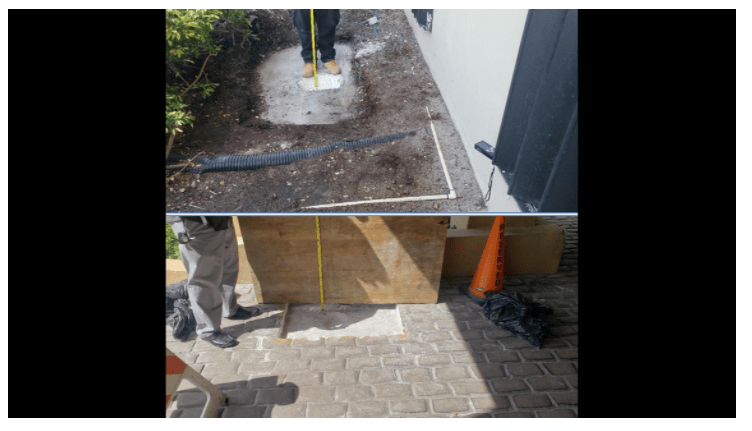

Interesting. The picture in the Miami Herald article which shows the core samples seems to make it look like the feature on the right would be the core sample hole (neatly-cut, removed tiles in a square pattern). So that returns us to the question of what is the feature in the middle?
Yes, I realize that is a different hole, but one would assume they were all done the same way--not haphazardly like that damage/hole in the middle.
Now that they are paying attention, it has begun: evacuations of another condo deemed unsafe: Link
I wonder how they got 13" cores out of a 9" slab.
