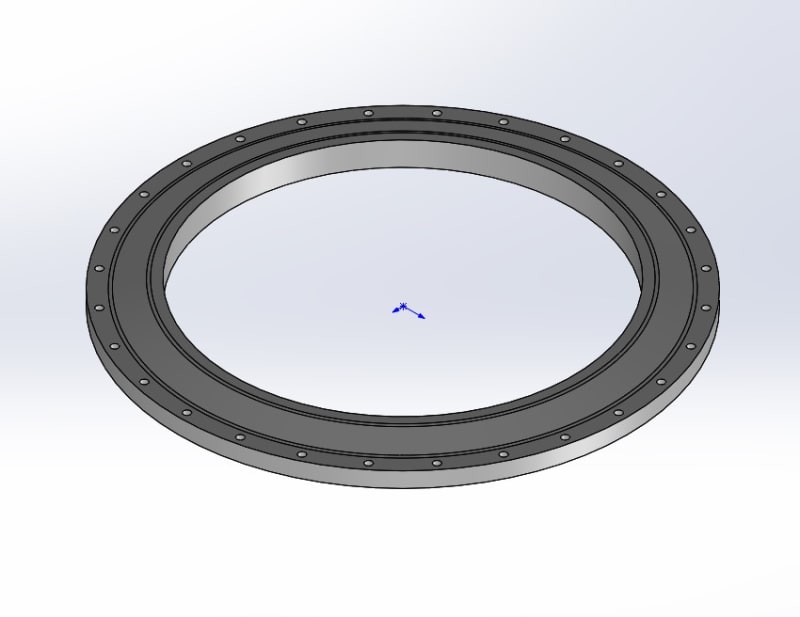

I have recently moved from a mechanical design role into engineering at my small R&D company figured I would try reaching out to you folks for some help and direction as I do not have other colleges to consult with. I am looking to design a weldment between two 6061-T6 components supporting a very strong solenoid magnet. This had been a bolted connection but the bolts failed after the system was overloaded and now we would like to weld them together for a stronger, permanent connection. My thought was to chamfer the parts to make for a groove weld to hold them together but I am mostly unfamiliar with weldment design.

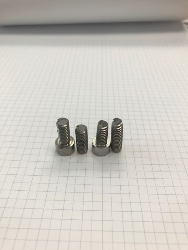

I don't recall claiming the bolts failed one at time other than them possibly rapidly unzipping and I don't see how the magnets being in separate chambers changes the problem I proposed at all. There is a lot going on with the system and I have been trying to keep from overloading with unnecessary information. This is my first post in the forum and I am new in the field, just doing my best and appreciate the help.
The unreliable part is failing to provide: an accurate free-body diagram. The fact that the failure was explosive in nature. That the lid was in the load path. The total load capacity of the bolts. These should all be in the first post.

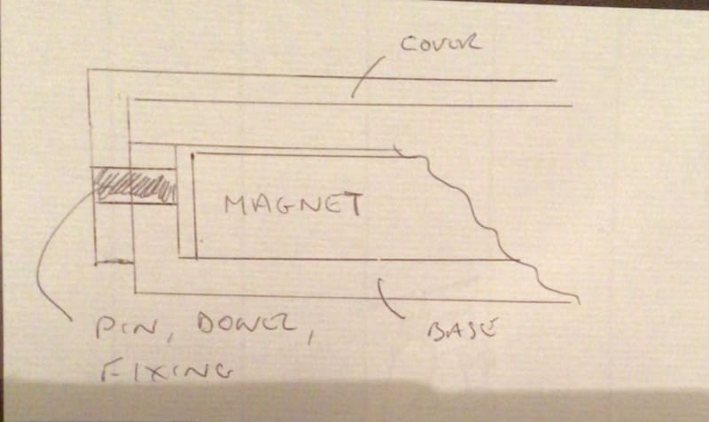

Now the next problem is how to fix it, have you considered putting bolts, dowels at 90 degrees to the current bolts, this would mean putting them in shear but the bolt preload wouldn’t be affected by the contraction..
Make the cup part with an OD flange. Drop the cup into a hole in a supporting structure. Take the magnet load through the flange. The bolted-on cover then carries no load.

Radial pins might work, the total OD of the structure must remain fixed so the thickness of the flanges would have to be pretty small at about 9mm each. That may not be an issue though so I will look closer at that. I think I would use large diameter Aluminum pins and shrink fit them in place but I have to think more about it.

the fact is the bolts failed
so the conclusion the bolts have to be more robust such as minimum of M9 bolts or larger.
in the English version 3/8 or even better 1/2 inch, it is really very evident the bolts were inadequate.

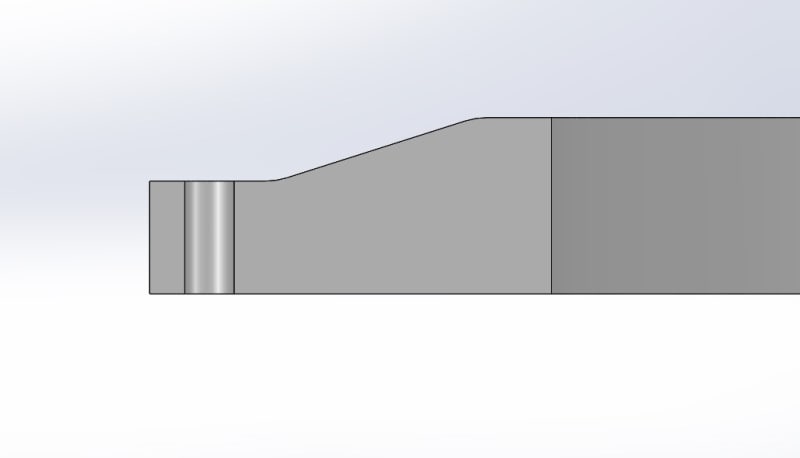

Make the cap in a conical shape to eliminate the "oil canning" effect of the flat plate shape to reduce or eliminate the bending load applied to the screws.

Is this sort of what you had in mind?:
I like that, to the extent that I have enough clearance I will try to incorporate that profile.
