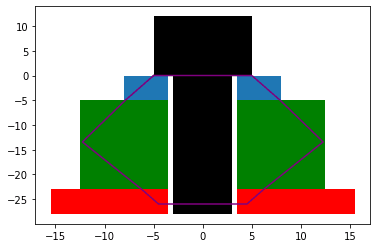

Here is the current state of the design:
-56 bolts preloaded to 10.5 kN
-3mm thick invar washer, 12mm OD
-2 mm counterbore in bobbin before threads
I am calculating the joint stiffness in steps from room temperature down to 3 K using the NIST data, the joint constant at room temperature is .308.
At 3K the calculated separation load is 9148 N per bolt.
Here is the frustum that I am using in the calculation and an interesting 3D plot of the separation force vs temp and washer thickness:
I am still tweaking it though. The changes I am working on now are:
-changing the final frustum diameter to 2D instead of 1.5D to account for the helicoil
-redefine the joint stiffness to account for a truncated frustum due to the flange thickness (18.4mm)
If possible I would like to stick with tightening the bolt with an input torque, in its assembled state we wouldn't have space for a hydraulic tensioner or anything like that. The aluminum contracts more so unless you make a very thick washer, the preload goes down with temperature. I am not sure how load indicating washers would impact the stiffness here, but I cant use any magnetic materials so I think they are likely not an option. Also can you share your calculation for embedding?

Thanks for the update, how much preload are you left with at 3K? You have said that the separation force at 3K is 9.148KN per bolt and therefore that exceeds the external force by a factor of 2 so I would say that was safe, however my approximate calculation suggested you would need a preload of 15KN at room temperature to enable you to achieve a 8KN preload at 3K, so how come your figure is much lower than mine?

At 3K there is still 6.35 kN of preload left, that is possible because of the invar washer. The washer is reducing the total thermal contraction of the joint to more closely match the bolt and therefore looses less preload. If the washer was very thick, over a centimeter, the preload would increase with decreasing temperature because the bolt would contract more than the joint.
desertfox
The proposed washer in this example has an OD of 12mm, and ID of 7mm and is 3mm thick.

Shoot- the invar 36 I will use for the washers has a yield strength of 276 MPa so I am limited to 11 kN before the bolt will embed in the washer.
3DDave
I looked into this method and I think this will be our best approach, does ±15% error sound reasonable?
I realized that Inconel is actually a poor bolt material in this situation. The failure mode is separation of the joint, not bolt tensile strength, which means a less stiff bolt is desirable (decreases the joint constant).
Re-running the calculations for 316 stainless (A4-80 bolts), a 5mm thick invar washer, and an initial preload of 9.7 kN and after 10% relaxation that gives a separation force at 3 K of 8.212 kN. Custom inconel 718 bolts were going to cost about $5K with 4 week lead time, I can get stainless bolts tomorrow for 1% that cost. It seems counterintuitive that weaker bolts would be preferable, I am glad that I though to make the comparison.

The preload goes from 9.7 kN initially to 8.73 kN after relaxation, then from room temp to 3K it drops to 5.9 kN from the differential thermal contraction. The script I wrote with the NIST data makes switching between materials very simple so all of the correct material properties are applied to the new joint.
One puzzling thing that someone might be able to explain to me is how A4-80 bolts achieve so much more strength than what is listed for just 316 stainless steel. I can see that the compositions are essentially identical and from what I have gathered the elastic modulus and thermal properties are the same, is it just how they are treated? For this calculation I just need to be confident that the elastic modulus and thermal contraction match what is in the NIST database, I should be totally safe from yielding.

I feel like I am ready to submit the design:
-56 X M6x1mm 35mm length DIN 912 A$-80 socket head cap screws.
-Preload to 9.6 kN by first torqueing to 2.88 Nm (~2400 kN preload) in a star pattern then repeat turning 19 degrees.
-minimum factor of safety on joint separation at 4K = 1.96
I think I did the torque angle calculation correctly, but it is a first for me and I couldn't find a formula:
load/turn = combined stiffness * pitch = (kbkj)/(kb+kj)*.001 = 1.3684e5 N/turn
7200*(1/1.3684e+5)*360 = 18.94 degrees

Unless I am reading it wrong torquing to 2.88Nm is almost generating the preload you require at the end of tightening, I read 3DDaves post as setting a very low torque that just allows faces to contact each other ie “finger tighten nut on bolt” and then use the rotational angle to generate the preload, I think you are setting to high a torque at the first stage which will have all the friction error you are trying to avoid, also without the dimensions of the joint and the stiffness values you have calculated I can’t check the maths.

T = (.2)*(.006)*(2400) = 2.88 Nm
2400/9600 = 25% of the preload
kb = 1.88e08 N/m bolt stiffness
kj = 5.03e8 N/m combined stiffness of the washer and aluminum
pitch = 1mm
For greased threads I have seen .2 as a K factor but please advise otherwise. 2.88 Nm (~25 in-lbs) is near the bottom of most common 1/4 drive torque wrenches but I could go as low as 2 Nm. The covers are not perfectly flat so I think I will need at least 1 kN to be sure the gaps are closed.

Okay I misread the units, however that 25% will be subject to an error of 25% and the turn of the nut angle method is +/-15% so if it were me I would reduce my first torque setting down to 5% or 10% of the required preload, that way the +/- 15% error on the final turning of the bolt angle method will be subject to a smaller error overall.

I see your point about the error, I will knock the initial preload to around a 1 kN if possible, thank you.
