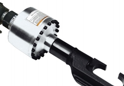

Similar to a tool I designed to generate 30,000 lbs of force resisted by the screws in the bolt circle.
