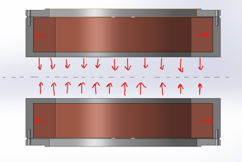

I have recently moved from a mechanical design role into engineering at my small R&D company figured I would try reaching out to you folks for some help and direction as I do not have other colleges to consult with. I am looking to design a weldment between two 6061-T6 components supporting a very strong solenoid magnet. This had been a bolted connection but the bolts failed after the system was overloaded and now we would like to weld them together for a stronger, permanent connection. My thought was to chamfer the parts to make for a groove weld to hold them together but I am mostly unfamiliar with weldment design.
From what I have seen it looks like to be conservative I can expect the welded area to behave like 6061-O which is dramatically weaker. There is an axial magnetic force of about 250 kN downward and an outward radial force that is still being evaluated, for now I am treating it as 0.5 MPa acting on the inside wall of the support. Where should I start with evaluating the stress experienced at the weld and how it will behave? I have attached some snips of a simplified model for discussion.

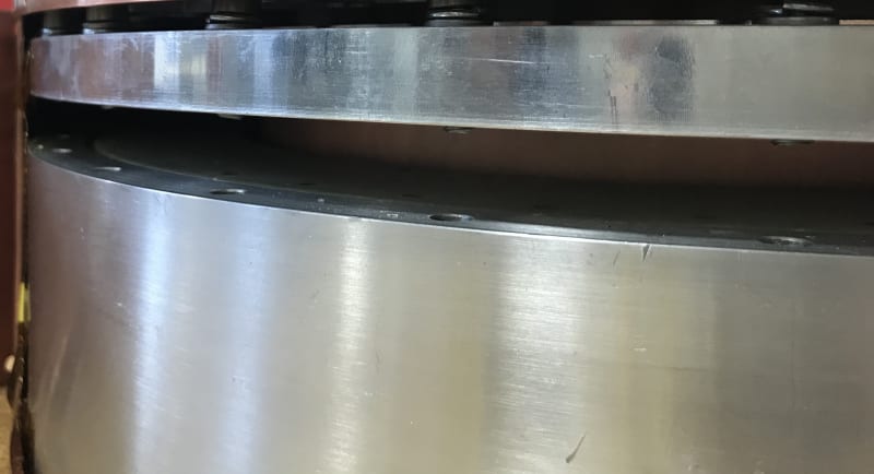

Here are some images of the bolts:

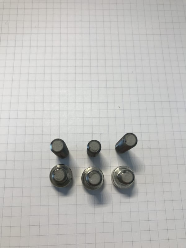

This is what the they looked like during disassembly:
you can see on average they broke very close to the joint interface.
This also shows the steel flat and lock washer that have no place being there.

Looks like tensile failure through the thread root.
Ted
At those temperatures, differential shrinkage between the bolt material and the joining parts may have created enough tensile strain to break the bolts. Do the the bolts and the other parts ahve the same reaction to your temperatures? A more basic question: are the bolts suitable for such temperatures or are they embrittled? Did they break as the temperature was decreasing or as it was increasing? Do the joining parts "feel" the temperature swings before or fater the bolts?
It certainly looks like the aluminum shrank more than the magnet material putting the bolts in tension. I expect that the contraction is not linear for any of the materials involved, but what is the CTE for the magnet and how long it? Also to keep in mind, the aluminum cover is also shrinking radially without constraint of the magnet while the shell is constrained by the magnet - this adds a shear load as well.

Thanks for the photographs, those bolt failures do look brittle and did you get any documentation with the bolts because Understand Inconel bolts can suffer hydrogen embrittlement.In addition my last post I mentioned a working temperature limit of -250 and not -270 degrees C which might not help your cause.
However coming back to the bolt failures if the Aluminium as a higher coefficient of linear expansion than that of the bolts, I would have expected the bolt preload to reduce whilst cooling and thereby reduce the tensile stress in the bolts,in line with a comment you yourself made on your post dated the 18/12/20. Other than the mass of the solenoid what other forces could induce tensile stress on the bolts? You mention the force of attraction of 250kN but I cannot visualise the set up. I suspect that the bolts have failed in shear due to differential thermal movement between the cover and the container.

The operation of the magnet starts with cooling everything down to its base temperature, around 3K, over ~30 hours. Then current is slowly supplied causing the magnetic field to rise. The temperature of the magnet also rises during operation but only slightly, never exceeding 6K, which negligible effects compared to the magnetic forces. The coil is wound and impregnated with epoxy, axially it contracts more than the aluminum and radially it contracts less. At room temperature there is a gap between the structure and the coil which closes during cooldown. The aluminum structure contracts more than the Inconel bolts, 0.435% and 0.238% respectively, so the bolts are loosing tension preload as it cools down.
The coils are attracting to each other, that is where the 250 kN axial force comes from. There is also radial force outward on the structure, the coil wants to expand, but this is more tricky to evaluate, I am trying to sort that out now.
I don't have anything that came with the bolts but I have reached out to the manufacturer to see what they say. This material is advertised as remaining ductile at cryogenic temperatures and has been used in other structural applications at low temperature so that doesn't feel like the solution to me. The bolts tested in tension to failure look very similar to ones that failed in service:

The attached image shows the cover with a close fitting ( nominal .002" Ø clearance for assembly ) pilot to resist the radial load applied to the cylinder.
Note there is only one mating face on the cover an cylinder.

 https://files.engineering.com/getfile.aspx?folder=6bb12bff-adcd-425b-ab5b-2a09ed407dd9&file=cryo_weld_.PNG
Hi Andre3
I am studying your latest post and thanks for that, before I respond in any more detail I have several important questions and these are :- are the magnets arranged as shown in your sketch ie one mounted vertically above the other? Are the fasteners in both magnets failing are just the one in the top or bottom position?
Struggling to understand how the solenoid can can contract more in the axial direction but less in the radial direction when compared with the Aluminium?
Can you not just put a bigger clearance radially between the solenoid and aluminium body?

The bolts are M6x1.0 Inconel 718 age hardened.

Yes the orientation is as shown and they both failed. The bottom assembly had the short helicoils installed on all threaded holes, 14 helicoils ripped out and 14 bolts broke. The top assembly had appropriate helicoils and all 28 bolts broke.
The images of the assemblies I have posted are simplified, the coil winding has spacers on the top and bottom made of composite which contract more than the superconductor-epoxy matrix of the coil.
The contact that the coil makes with the structure is part of the cooling path so we need to be making contact there to get the coil temperature low enough. In the future the cooling can be done differently to avoid the need for the radial contact.

Andre3, about the benefits of longer bolts. You need to think about the strain in the bolt. The length of the bolt is the denominator in strain so increasing the length of the bolt reduces the strain. In your case you have a specific amount of thermal expansion you must deal with. A longer bolt will see less change in strain over the range of conditions.
