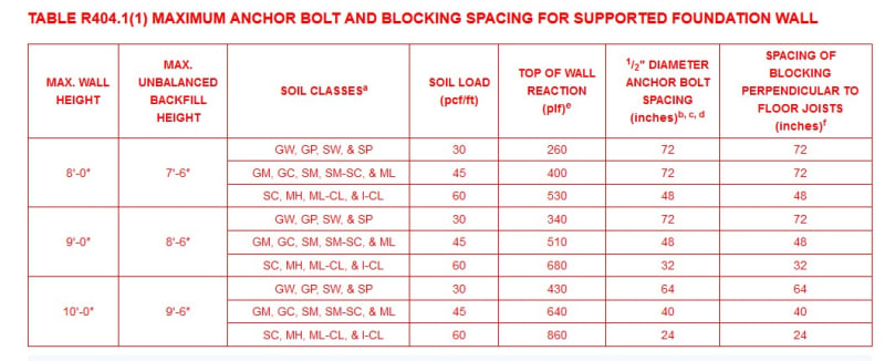

Let’s take a closer look at connections to foundations, for example. It’s not uncommon for large custom homes that fall within the IRC’s scope to have finished basements with tall ceilings resulting in deep foundation walls with significant unbalanced soil load. There can also be significant uplift loads that must also be transmitted to ground depending on the proportions of the superstructure. These forces can easily exceed the capacities of the prescriptive provisions, that, if I had to guess, were developed long ago with simpler construction in mind.
It’s also not uncommon for many home builders to skip architects and engineers and simply follow the IRC. I’ve seen too many projects where this happens, and the result is connections that are over capacity, lateral systems without adequate diaphragm and shear wall detailing, etc. This often doesn’t result in total failure, but rather a final product that doesn’t meet current standards of practice, making it hard to call the builder’s attention to flaws with “the way we’ve always done it” that might be code compliant but not necessarily sufficient. And of course, failures can and do happen in the worst cases.
So what mechanisms, if any, are in place to ensure that simply following prescriptive codes are adequate for every situation, and whose job is it to identify when an engineered design is required? And, who is responsible if a code compliant prescriptive design ultimately proves to be inadequate for the situation?

Are you saying within the IRC "there's maybe other provisions elsewhere for anchor bolt spacing due to the lateral (soil) load"? I spent many hours digging thru the IRC at this point, pretty sure there's nothing in here, but let me know if you see something.
Eh, well, no. I didn't find anything special about lateral loads on the sills, there's some fine tuning you could do on your calculation but it is highly unlikely to alter a 1,800% overstress. I just feel compelled to mention, in case that's coming from a design somewhere, but the refinements appear to increase the allowed load so it's conservative as is. I didn't read Stephanie's article, I just saw that comment about load path when I was trying to find it for discussion...

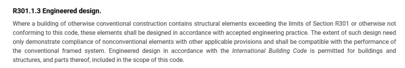

Mike Mike said:

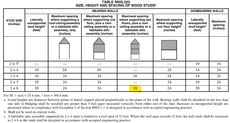

Floor trusses are specifically permitted by 2024 IRC R502.12 and require engineered design regardless of span. You can't get more "in the middle of two prescriptive designs" than that. If you were EOR would you not allow your clients to use floor trusses?
Touche. Agree they are pretty clearly sandwiched between a prescriptive stud and a prescriptive foundation. But isn't that engineering by somebody else? The truss engineer? I'm not too sold one becomes a "full" EOR on a project just by doing a tall stud wall, you know? I'd expect at least 4 out of five dentists would allow floor trusses without batting an eye, similar for roof trusses.
Source: 2018 International Residential Code. (actually the image is from the 2020 Minnesota Residential Code, but I don't think there are any changes.)
You could probably read that to permit a sandwich of an engineered design between two prescriptive systems, but it's got some (mild?) peril to it, but the peril we're talking about specifically is the wall connection at the top of a soil-retaining foundation wall and that's not happening due to the wood truss...
One would like to think a too long span for the truss will have bearing/crushing issues with a 2x4 that would prompt a question, but then again, I've seen that exact defect on an engineered three story building with an occupied roof and a penthouse, all in wood. So, probably not.
Going to the top of your post -
1 - Some sort of "gateway" check would seem in order, since there aren't engineers on these items, and it's difficult for them to a) make the call when it comes to snow load, seismic load, and b) they could then know (the building officials as well) where to expect engineering. Or how to design so as to avoid it.
2 - That or add "engineering required" for the floor attachment beyond where the 6' sill spacing stops working, with some inclusion of possible dead load friction or say a 25% increase to the stresses..? I feel like some states have revisions in that area to provide additional bolts.
Source: 2020 Minnesota Residential Code
That would be the kind of modification to propagate "upwards"?
3 - What about bringing back the footnote on Fb and E? Took them what, 6 years to add the superscript on the 1.6 x 106 psi and change the "by" to a 'x' indicating multiplication? Like as a starting point (although maybe it came back after 2015, I haven't looked that far, so much (unnecessary) reorganization and renumbering .... so many adds) In the northern areas, we tend to see 2x6 studs for insulation so the 2x4 parts of the table are of less relevance to us up here so they get less scrutiny. The table is kind of funky anyway, to me it's a bit backwards, but nonetheless. Somewhere an "engineering required" would be nice to see in that table. If they'd just stop rearanging things and moving sections all the time, that would surely help.
4 - Another perfect opportunity for "engineering required" in a table, which would send folks retreating to eliminate the need for engineering and go back to more standard spans. We'll ignore the 25% decrease for clinched nails for now, but wouldn't a double shear connection tend to provide more than a 25% strength increase? I've not tried to calculate it out, when I get stuck with this situation I use hardware that's been load-tested (cough Simpson cough).
How about (A) - Delete all that garbage for light gauge stud and joists and punt it to the light gauge people to publish their own bloody standard a la the WFCM? Do the light gauge studs calculate out better as somebody put them into the code? Why did they sandwich all that light gage garbage between two wood framed sets of provisions (Floors, Decks), that's just a bad decision from the go.

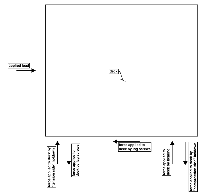

1. R507 is for decks. I'd eliminate those at your peril. Lateral Loads Generated by Occupants on Exterior Decks, Parsons, Bender, Dolan, Woeste, Structure Magazine, Jan 2014. As an engineered design, code calls for it to be "designed for lateral loads" (not really a quote, sorry), without any guidance.

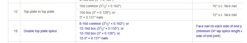

2. Single top plate is possible without engineering in both codes, I think.
Mike Mike said:
Top plate nailing requirements of table R602.3(1) lines 13 and 14 are extreme overkill and can be reduced or deleted.
3. Which part is excessive? I suppose cheaper with fewer nails, sure, nothing dramatic, though, and would the framer actually look at that or just do it per "code minimum" like they've done forever. The splice (1422 lbs?), last I checked, is the same in the two codes, unless the options in the IRC are different. If we're comparing R602.3.1 and Chapter 23, they tend to be pretty similar. The IRC doesn't control a top plate splice location so it's presumably in the worst case location between two braced wall panels at the ends, it's a collector/drag strut, and the nailing is probably unchanged since, say, 1926.

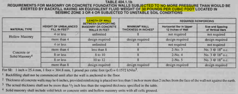

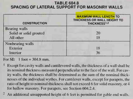

As to the horizontally spanning masonry foundation wall, is there a requirement for a bond beam anywhere in the IRC that might provide that, or are we expecting the mortar bedding in tension to do something or ladder reinforcing (if required?).

I deal with this foundation bolt issue all the time in my practice. I have clients who need a foundation engineered because it is required in some jurisdictions, or because there is something unusual (large custom home, deep basement, etc.) The problem is when you run numbers on the prescriptive requirements that the job was priced on (the engineering often isn’t sought until the last minute, but that’s a whole other topic), you often cannot get the numbers to work, as Mike Mike covered several posts ago in this thread.
This puts me in a predicament. Do I specify what my engineering expertise tells me to do, or do I just sign off on the code?
Of course the contractors throw a fit when I double or quadruple the bolts, because they've seen it done 1,000 times at the code minimum and never had a failure. Problem is these guys aren't engineers and don't understand why just because something "works" doesn't make it right.

The anchor bolt connection detail is something that comes up a few times a year (about every 5th moon cycle I believe). We all think about it, and then throw our hands up.
While most of the IRC and IBC prescriptive provisions seem to have some engineering basis, this particular detail apparently doesn't. I suppose it's along the lines of it being constructed that way for a long time and apparently not failing. I can understand the pressure on the code writers from the building community to not decrease the AB spacing (or whatever the code change would be), but I think something should be done about this. From an engineering perspective, I don't think something having been done a particular way in the past should be taken as an absolute justification for how it's to be done in the future. Most houses could be constructed without any connection to the foundation, and most would be fine, but that doesn't make it right.
It's borderline embarrassing trying to provide an engineered connection and ending up with ABs spaced at 6" o.c. or whatever. Meanwhile the builder's looking at a table showing 6 feet o.c. and thinking how he never wants to work with you again. Then later that night, he's going to tell his 6 builder buddies how wacked this engineer is that he worked with today, and then they're all going to tell their buddies. (I mean, who doesn't love a stupid engineer story?!)
If the IRC/IBC people aren't willing to revise the code, perhaps they could at least create a short design guide showing an engineering basis for the AB spacings. I've gotta think shear friction between the sill plate and top of concrete wall plays a big role. Realistically, 2-way action of the concrete probably does too, although that's perhaps a lot harder to quantify from an engineering perspective considering there are usually only 2 or 3 horizontal bars in the wall (at least per prescriptive requirements). Then there's also some fixity at the base of the wall. Besides all that, I imagine the biggest discrepancy is that the lateral soil forces that we use in design are never realized, especially if well drained material is against the foundation wall with a foundation drain at the bottom. If my speculation is true concerning that, maybe the code could provide alternative lateral pressures. Of course, some engineers would say that the lesser pressure shouldn't be used because the foundation drain could get clogged, etc, etc.

It does though, in my area. I wouldn't be surprised if it isn't at least a quarter of houses in my area that have foundation walls that have popped their top connections and started to learn inward. One could provide college tuition for a family of 6 by just running around town spec'ing out wall restraints and similar fixes for every realtor or homeowner buying or selling a house.
Ok, wow, so this apparently is a problem somewhere. I don't feel quite as crazy now thinking about this load path and detailing.
Are the failures primarily between the top of wall and sill plate or between the sill plate and floor framing?
The code "soft spot" is the reaction at the top of wall path into the "diaphragm".

In terms of prescriptive deck holddowns, I disagree. Your reference Lateral Loads Generated by Occupants on Exterior Decks specifically says the holddowns don't work as expected on page 27: "Tension hold-downs behaved in a counterintuitive way for the deck investigated. The flexibility of the deck allowed significant rotation of the deck joists within the joist hangers. This resulted in a geometric prying effect that caused zero tension in the tension hold-down and significant tension in the compression hold-down". full article here:
for most decks alternate lateral load paths exist and prescriptive holddowns are excessive. this is an example of where an engineer fluent in both IBC and IRC has a competitive advantage over an engineer fluent only in IRC.

2 way basement wall action won't help because IRC places no limits on distance between wall jogs. does IRC place any limit on building length and width at all? I don't believe it does but I'm not sure, might be hidden somewhere in the back.
I agree basement footing fixity helps and soil pressures have a large factor of safety. But you're not going to establish an engineering basis when you're off by a factor of 18.
I suppose you could argue not many houses have basement wall jogs more than 20ft apart and experience base uplift. probably less than 10% of homes right? 90% aint bad. but I guess I would still prefer we edit the IRC to keep the failures well below 1%.

Mike Mike said:
In terms of prescriptive deck holddowns, I disagree. ...... significant tension in the compression hold-down.
I rest my case. There's a tension load developed and the holddown attracted and resisted it. The load path is altered by the deck flexibility (not really much of a lateral diaphragm), in the life-safety sense, it's a code requirement without an engineered design and has documented effectiveness.
Yeah, I dunno, waiving something so obviously intended as a life-safety measure that's based on testing to be shown to be effective "because I feel like it" as a professional engineer isn't to my taste. I'm not the guy to be expert witness to defend that practice as "standard of care." I get people dislike stuff and think it's overkill, but then again, it went through a balloting process, had a code cost increase associated with it (I PRESUME), so it was honestly put through. (cough unlike residential sprinklers cough).

Deck holdown load: the tension was on the compression side of the deck, meaning the holdown further destabilized the deck and resulted in additional tension on the lag screws. FBD sketch below. the holdowns aren't waived "because I feel like it", the holdowns are waived because they satisfy IBC, the body of engineering knowledge, and engineering calculations. not sure if we're speaking the same language here. did you read the article?

In terms of prescriptive deck holddowns, I disagree. Your reference Lateral Loads Generated by Occupants on Exterior Decks specifically says the holddowns don't work as expected on page 27: "Tension hold-downs behaved in a counterintuitive way for the deck investigated. The flexibility of the deck allowed significant rotation of the deck joists within the joist hangers. This resulted in a geometric prying effect that caused zero tension in the tension hold-down and significant tension in the compression hold-down". full article here:for most decks alternate lateral load paths exist and prescriptive holddowns are excessive. this is an example of where an engineer fluent in both IBC and IRC has a competitive advantage over an engineer fluent only in IRC.
I consider deck hold-downs a critical (if not the most critical) element of a deck construction. Most deck failures seem to occur due to a poor waterproofing detail at the interface between the deck and the house. After years of deterioration of the fasteners connecting the deck joists/joist hangers to the ledger, there's no longer any withdrawal capacity. Now add a bunch of people for a graduation party/cookout/whatever and you get a failure where the deck pulls away from the house, collapsing inward and downward. Anchoring the deck framing directly into the floor diaphragm of the main building helps to prevent this type of failure. I like to design decks with the mindset that the deck won't fall off the house unless it's tearing out the floor of the house with it.
The article linked above is very interesting, but it's concerned strictly with lateral deck loading, not the type of failure I mention above. Per the article, the hold-downs don't resist lateral loads as we would intuitively expect. Still, the article doesn't suggest not using them (as I read your response to imply), rather:
