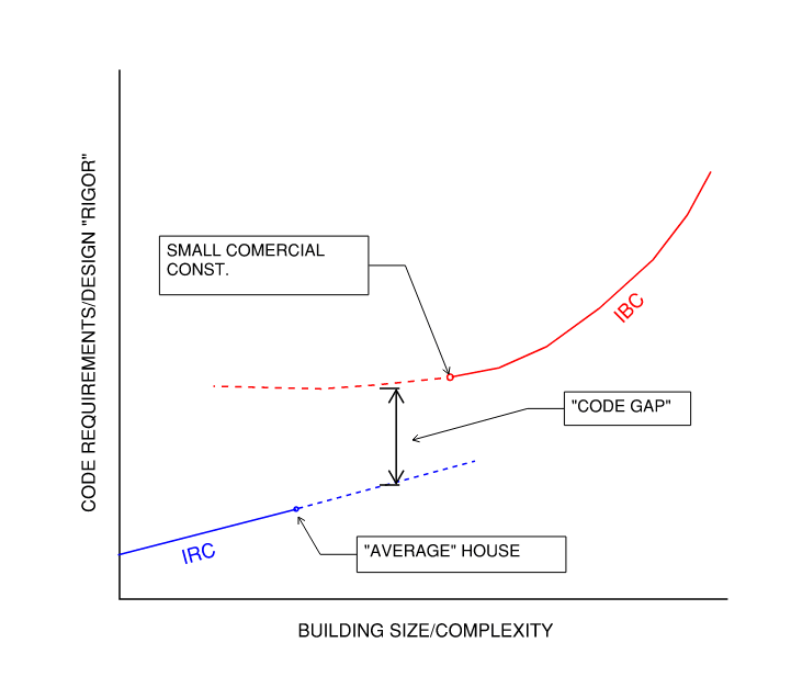

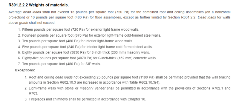

1. IRC is wildly out of line with other codes and standards, creating house performance issues and in extreme cases, life safety issues. It's up to us to participate in committees to bring codes into alignment and counteract entrenched interests.
2. The limits of applicability of IRC are not clear, but appear to be: 10psf max floor dead, 15psf max roof dead, 40psf max live, 70psf max snow, no special wind regions over 140mph, no coastal wind regions, roof rafters up to 48' between supports, floor trusses practical limit of up to perhaps 40' between supports.

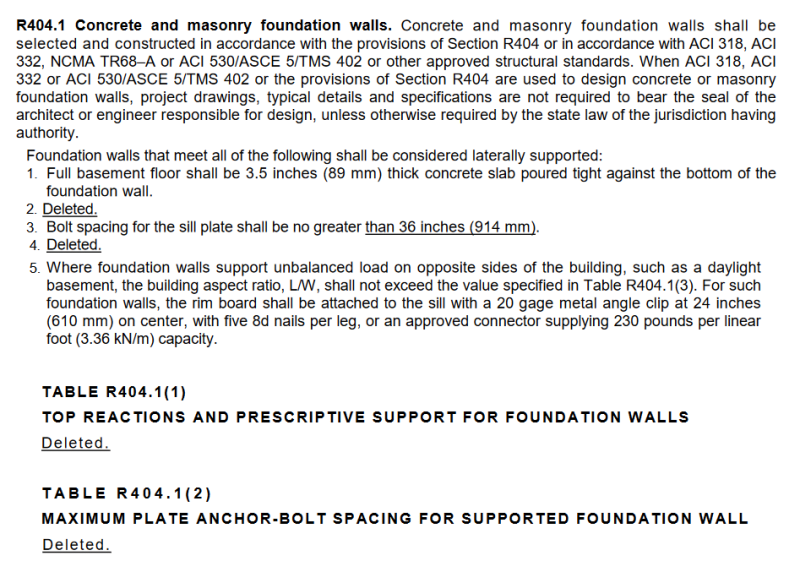

1. top of basement wall to sill connections
2. top of basement wall sill to band joist connections

1. Engineers are held to a "standard of care", so if a homeowner's basement wall tilts in because the engineer of record followed the IRC, the engineer may be held liable. That being said, we don't know of any cases where this has ever happened.
2. I say engineered design can be less expensive than prescriptive design in some cases. lex says engineered design is always more expensive than prescriptive design.
3. I say some prescriptive requirements can be removed if alternate load paths are engineered. lex disagrees. eng16180 disagrees in the case of deck holdowns.
Floor joist span tables provide values for 10 psf and 20 psf dead. See Table R502.3.

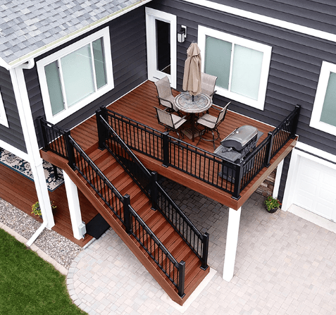

Regarding deck hold downs - I would caution anyone wanting to use that report as a reason to say "see, we don't need them!".
1) This was done in a lab. A threaded rod running inside and fastened to a hold down bracket will age better than a screw in a 1-1/2" piece of wood that gets damp ever night, wet when it rains, and dries every day.
JLC Article Linke Above said:
ome level of structural redundancy is recommended, even though in ideal laboratory conditions it was shown that sufficient withdrawal capacity could be provided by joist hanger connections when screws are used. It is important to note that both deck tests were conducted in a laboratory setting where materials were not exposed to environmental factors such as wet/dry cycles, and there was no wood decay or fastener corrosion present.
2) This isn't how most decks are built. The behavior of these decks relies heavily on the fact that everything is screwed together. The prevailing interpretation of the codes is that, with the hold downs, you don't need screws in the joist hangers and nails are fine. So most decks, even those built to code, will have very different performance curves without the hold downs.
3) These curves are taken to failure. Waaayyy past where we expect them to operate. It's important that we understand those failures and consider them in our designs, but who designs a deck to exceed an inch of sway? That's going to be very uncomfortable for anyone on the deck. Besides, many post designs will start to 'fail' if your second order moment eccentricity starts to get that high. d/6 is a good 'rule of thumb' for designing wood columns to account for that (as well as eccentricity in the connection). On a 6x6, that's 0.92". If you look at that spot on the curves in Figure 7 of the article, you'll see that the hold down tensions are all pretty close to the 'expected' tension, and the actual tension doesn't exceed the code minimum capacity of the hold down (3500lbs) until the deck has deflected about 14".

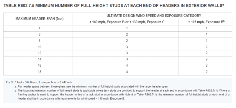

I believe the max wall height for IRC is 12ft based on 2024 IRC R602.3(6). Jaw droppingly, the king stud schedule does not differentiate between 2x4 and 2x6, at least not that I was able to find. And yes, none of the table entries are even close to working for 12' tall 2x4 stud grade kings lol.
phameng
I agree with all points on both posts, and that's a great point about local jurisdictions with high winds not simply adopting the vanilla IRC. Another couple things the deck experimenters could have done to get the expected behavior at both service and ultimate loads: (1) install the holdowns on the first joist in from the edge on the opposite side of the joist, or (2) install double DTT1Z holdowns instead of single DTT2Z holdowns. the DTT1Z is installed on the bottom of the joist and screws into existing double top plates.

After years of deterioration of the fasteners connecting the deck joists/joist hangers to the ledger, there's no longer any withdrawal capacity.
would you feel better about the connection if hangers are fastened with screws instead of nails? what if hanger fasteners are 3" long? enough to get some bite in the house rim joist. not sure if this is a good solution because I've heard too many little fasteners efs up the flashing and waterproofing, not sure if it's true though.

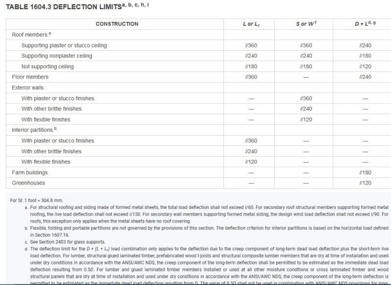

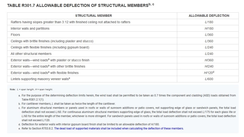

it looks like the IRC deflection limits match up pretty close with the live load limits in IBC, but the IRC fails to clarify as usual. and yes this is another great comment for your drafters someday when you're head of the committee. why is this table even in the IRC anyway?

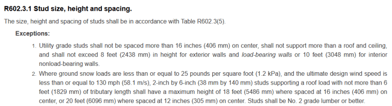

@ Mike Mike - Check out 602.3.1 Exception 2. Allows studs up to 20' tall for some conditions.
It has been a while since I have chased this one down, but try to get that (2)2x6 king stud to work in a 18' tall 2x6 wall with a 18' opening... Hopefully this has been cleaned up somehow, but last I looked the same header and jamb stud requirements you reference above were the only thing required to my knowledge. There are a couple of threads floating around here dedicated to the topic. In 2015 IBC they tried to address this in a way, but it ended up going back to old wording in 2018 and has not changed to my knowledge..

I thought the deflection limits in the IRC were more specific about load cases in the past?

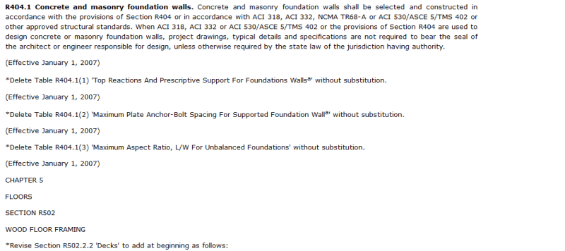

Anyone have links to documentation of this debacle over anchor bolt changes?
@PhamENG - I am not aware of true documentation, but I remember the back and forth a bit. There was a new table introduced in IRC 2006 that tightened spacing of plate anchors at the top of basement walls (Table R404.1(1) Top Reactions And Prescriptive Support For Foundations Walls and Table R404.1(2)Maximum Plate Anchor-Bolt Spacing For Supported Foundation Walls). These came alot closer to typical "engineered" basement wall support - at least in terms of actual reactions at top of wall and making sure they can be resisted by the plate anchors. If memory serves, values may have been based on assumptions a bit on the conservative side in an attempt to simplify and unify, but not overly so.
It caught alot of backlash and many municipalities omitted it from adoption. There must have been uniform resistance from builders groups of some sort because many times changes like this would just go unnoticed or ignored, but in this case they were omitted from adoption completely. See links below to GA. and NC adoptions and their respective omissions of these tables. Many other areas followed suit.
Later versions of this section of IRC do not contain the table. In IRC 2009 "significant changes" summary sited lack of past performance issues and conservative design values as proponent justification. Take that for what it is worth, but that is the only glimpse I found into the code committee deliberations.

I ran a quick engineering check on three 20' tall 2x6 stud grade kings at the side of a 14' wide opening for 129mph, exp C, 35psf unfactored C&C wind load, 300% overstressed in bending, 5" deflection. Hopefully the homeowner doesn't mind his walls shaking and drywall cracking. no no it's fine he can just post a sign "careful for falling debris. shut door softly. avoid loud noises. and by all means never turn on any appliances with frequencies matching the house harmonic."

Mike Mike, this is what I have to explain to my contractors almost daily when this gap between “past performance” (aka this is how we’ve always done it and never had a problem) and engineering requirements comes up: Many structures never come close to seeing design loads. Case in point, how many times does the wind really blow 129 mph on a building? When that does happen, we have hurricane disasters where many buildings are destroyed. Same with snow storms. But 99% of buildings out there will never see full design level wind loads, live loads, etc. and are never put to the test. So that explains why most things that get built seem to work just fine, even if not per standard engineering practice. And as engineers, we are obligated to design for that worst case no matter how improbable. Believe it or not, many contractors, at least the sensible ones, understand this even if they don’t like it.
Can’t tell you how many times I’ve heard about so and so’s 200 year old farmhouse that has a cobble foundation and no uplift connections and how us engineers are just being ridiculous with our modern requirements. Again my rejoinder: it obviously hasn’t had the misfortune of ASCE 7 loads applied to it. (And by the way, they never admit that old house has settled so far out of plumb that half the doors and windows don’t close properly.)
The real travesty is how ICC basically sold out engineering in caving to the “this is how we’ve always done it” crowd.

Regarding IBC/IRC conflicts, I think this is natural. You have a prescriptive code developed with the building stock of "yesterday" and are trying to apply it to "today's" structures. The same provisions that have worked well for the single story gabled ranch house with 8' ceilings and 7 or 8 total windows around the house are being applied to newer builds full of windows, crazy roof planes, tall walls, etc.. The code does not always extrapolate "up" well.
Likewise you have engineered design which was developed for primarily larger structures where things like interior gyp walls and other less reliable means of load transfer are largely ignored. This may be negligible for a larger structure, however the smaller the building gets, the greater the impact of those ignored items lending to increasingly over-conservative designs. Engineered design may not extrapolate "down" well.

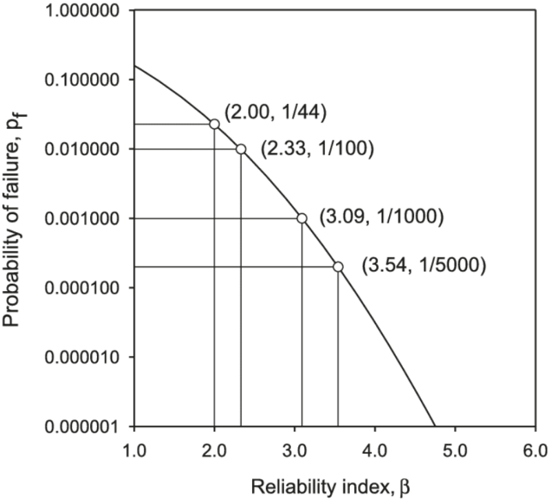

To make all this worse, it takes years for the "problems" to arise to know just where the prescriptive designs may be delinquent, yet the cost implications of an over-conservative design are immediate. I think it is our job to fight the more obvious discrepancies, as noted above. I often wish I had a better file of photos of issues that arise from the common IRC issues (both issues of the code as noted above and common areas of lack of inspection or code adherence - ex. gable wall hinge, ridge beam/board, etc..) If anyone wants to upload a bunch of photos I would be glad to file them away as ammo for later use..

DTS said:
99% of buildings out there will never see full design level...loads
agreed, and I think part of the solution is to reduce IBC safety factor, not just increase IRC safety factor.

if ICC committee investigates the data and determines 1/2" bolts at 6' are fine for 999 out of 1,000 houses, then the solution to code discrepancy is to revise IBC to output similar solutions to the IRC. I would be fine with that. 3.0 or so seems like a reasonable reliability index for this issue since it's unlikely a life safety issue, but I don't even care what reliability index the committee chooses. All I ask is that they do their jobs and be consistent across their codes and stop creating legal gray area.

the codes reflect the makeup of the committee...The same provisions that have worked well for the single story gabled ranch house with 8' ceilings...are being applied to newer builds
I agree ICC does a poor job of clarifying the limits of the IRC. I agree this is the result of the makeup of the committee, by which I assume you mean special interest groups.
