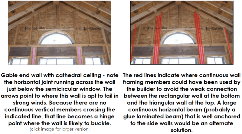

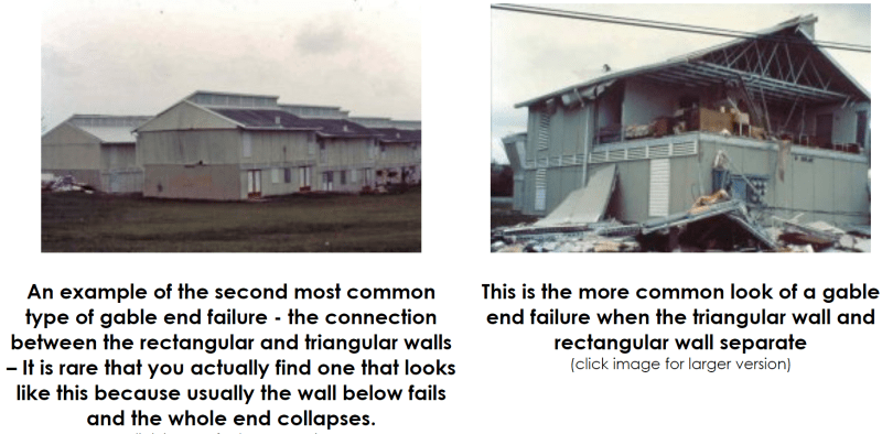

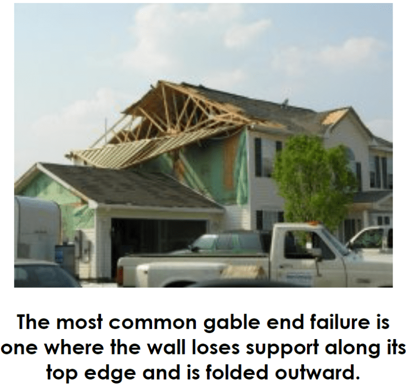

Where are those photos from? The document I mentioned by the APA?
Top photo looks like the front has a sort of minor vault in the front half, also note there's a lot of shingles missing from that garage and an apparent sheathing loss on the back side, the sequence of failure isn't all that clear, there's more than one way for that to fail besides it 100% being a defect. Some of this "drive by" inspection stuff gets published as "real."
Second one looks like there's no ceiling, ever.
Third is the classic "window wall" with improvised framing where the building official either caught it, hence the photograph, or somebody fully took it apart after? There are some good guides on tall wall construction, e.g. Weyerhauser, among others.
Even so, to me the takeaway there is this is an awareness on the general contractor and the framer as well as the building inspector. In a hypothetical diagnostic sense, you may see this flaw via thermal imagery without having to take the wall apart, as the solid framing will transmit heat better/faster than the insulation in those areas.
As far as the code goes, the studs need to be continuous, that's the continuous load path we've discussed, so it's a builder's defect/workmanship issue, for one. Bad G.C. supervision of subs, Sub at fault for defective framing, G.C. at fault for passing to the next sub, next sub at fault for "starting work constitutes acceptance" if they know what they are looking at, and a building official at fault for not flagging during the framing inspection (if they even require one) it as "requires engineering if you want to do it that goofy" (hinge wall).

the photos are from your link Florida disaster preparation hurricane retrofit materials, maybe I clicked something on the site lol. the article explains that you are correct in that the most common failure is in photo 1: the roof ripped off the top of the gable wall and the issue here has nothing to do with the hinge.
with regards to the cathedral ceiling gable end wall, could contractor argue he provided a complete load path via double 2x6 top plates? in my opinion the IRC was followed perfectly by both the builder and the inspector and I disagree "it's a builder's defect/workmanship issue". "The construction of buildings and structures in accordance with the provisions of this code shall result in a system that provides a complete load path that meets the requirements for the transfer of loads from their point of origin through the load-resisting elements to the foundation. Buildings and structures constructed as prescribed by this code are deemed to comply with the requirements of this section." I agree with you the top plate is insufficient and probably of limited use because of splices, but how does the contractor know that? It's the IRC's job to tell him that and the IRC has failed.
