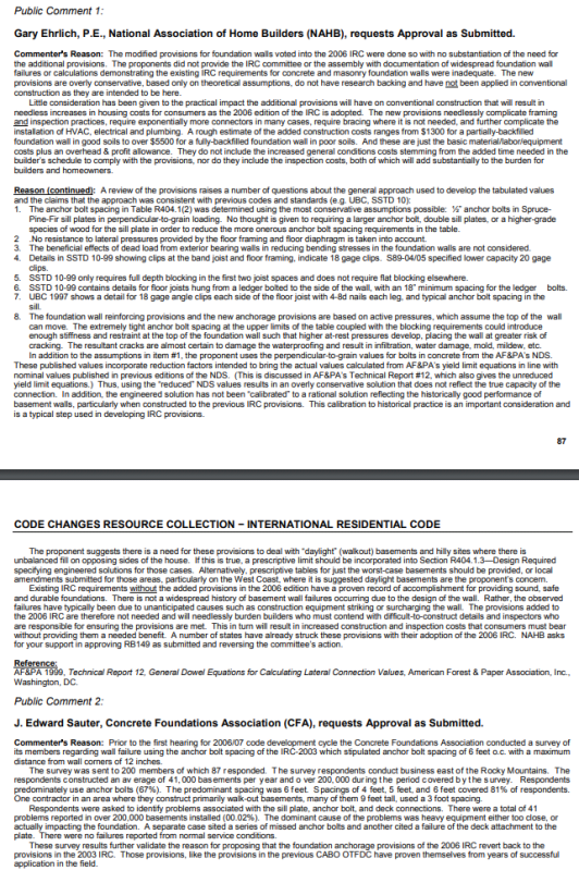

Oh, as a Side note, I may have found the anchor bolt spacing that DTS419 was discussing previously, look for Ehrlich, page 87 of the document below...
2009 IRC Resource, Approved changes
As a side note, RB116-07/08 proposal by Steve Skalko, of the Portland Cement Association, for foundation wall reinforcement, that suggests to me these are based on calculations.

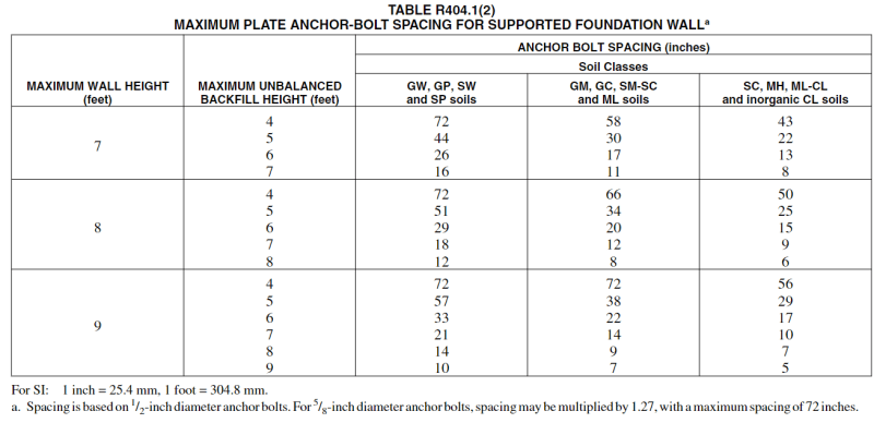

Great find on the repeal of the 2006 wall anchorage requirements. Here's a screenshot of the 2006 code:
5" OC!!! quite a difference from 6', no wonder the powers that represent the contractors flipped, here's the movement to squash it:
I have no issue with their conclusions. If they have collected 200,000 data points from unbiased samples and found no issues resulting from lack of connection at top of basement walls, then maybe IRC is right. Maybe it's the IBC that needs to change. Let's dig in and call the IBC and NDS numbers into scrutiny.
That being said, I am skeptical only 41 problems were reported. Let's dig into the Concrete Foundations Association's "members" and their affiliations and validate the data. Certainly seems to be at odds with Kissymoose's observations.
as to NAHB's comments, I suspect Gary threw together this list without consulting a structural engineer (or a spelling/grammar checker). I could poke holes in every one of these items, but I'll focus only on "no resistance to lateral pressures provided by the floor framing and floor diaphragm is taken into account" uhhhh in order for the load to get from the wall to the diaphragm doesn't it have to go thru the anchors? not sure what subject Gary got his PE in but it certainly didn't require tracing loads.
one thing that doesn't make sense to me about all of this push back from contractor's associations, if the price of homes has to go up because of mud sill to foundation wall anchorage, that price increase will be passed onto consumers. perhaps NAHB members are scared because basic economics says an increase in price will cause a decrease in demand, and therefore a decrease in company revenues and share prices. however, in this case, shelter is virtually universal, and most consumers do not see forgoing shelter as an option.

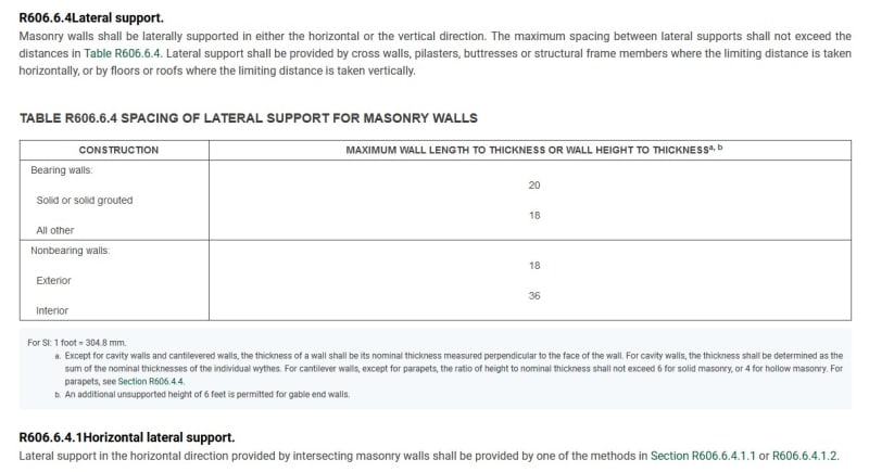

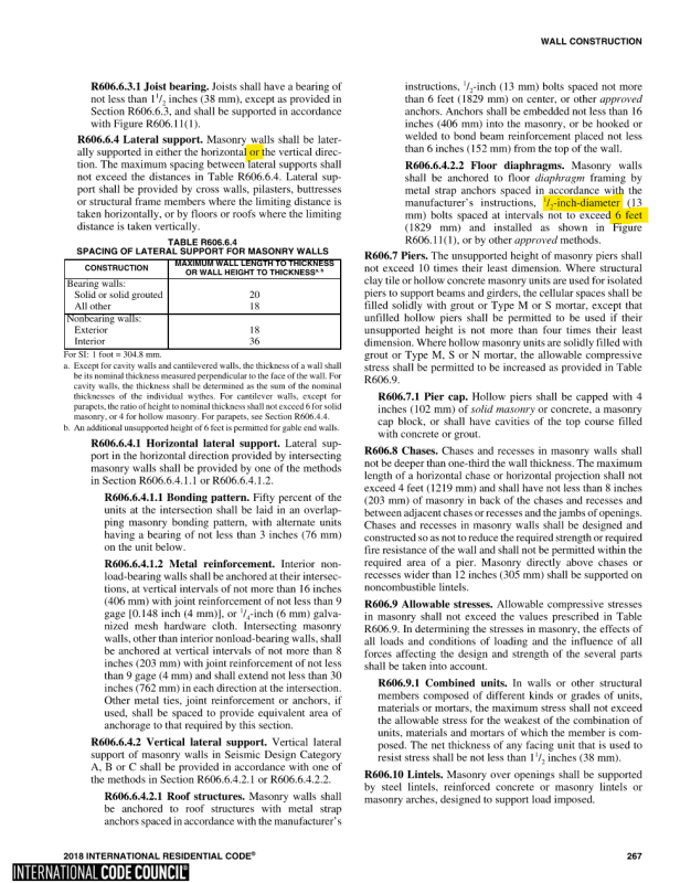

moving on to your other items lex, 1992 CABO Figure R-404.9 appears to only allow balloon framed masonry walls, which takes care of the OP's original concern. this is similar to my 9 Jun 24 09:17 post on 1995 CABO.
a couple issues with your code masonry lateral support requirements:
1. concrete wall chapter 608 contains no equivalent provisions
2. length is not limited where walls are supported by floors, highlights below

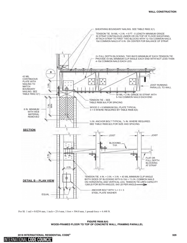

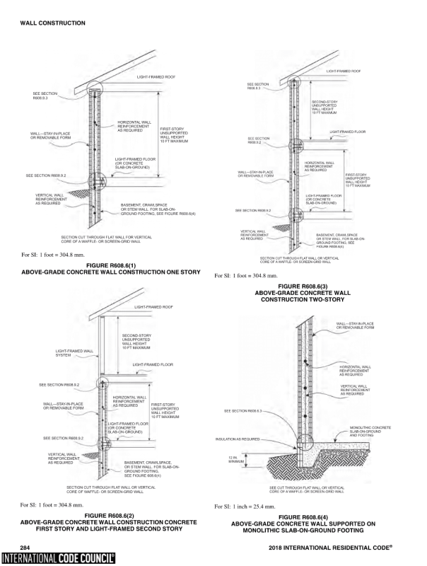

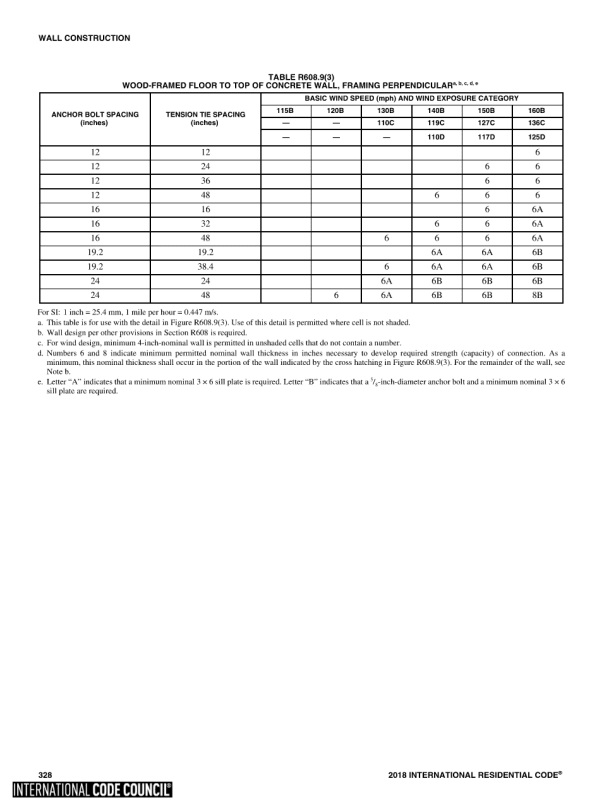

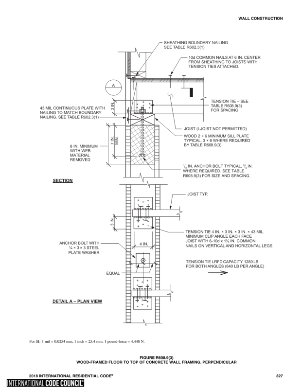

concrete walls 608 does not appear to pertain to walls resisting soil pressure, but I did find the following enlightening, and may give the OP some ammo for future conversations to make his engineered designs a little less embarrassing. these tables appear to require 1/2" bolts at 24" or tighter, depending on wind loads.
