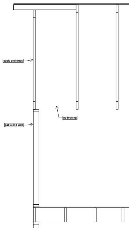

RWW, you mentioned the gable wall hinge and it got me to digging again. IRC does not appear to prevent me from building my gable end wall with a hinge as sketched below.

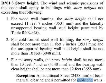

I know the truss is an engineered element, but typically in the commercial realm it's the engineer of record's responsibility to call out bracing since the engineer of record typically owns the wood wall and global stability design. I would not be surprised if residential roof truss suppliers do not design their truss bracing to support my wall. should IRC at the very least have a detail for this common scenario? the wood portion of the IRC appears silent, but the passage below indicates that perhaps the committee's intent is for walls to be framed full height without a joint.

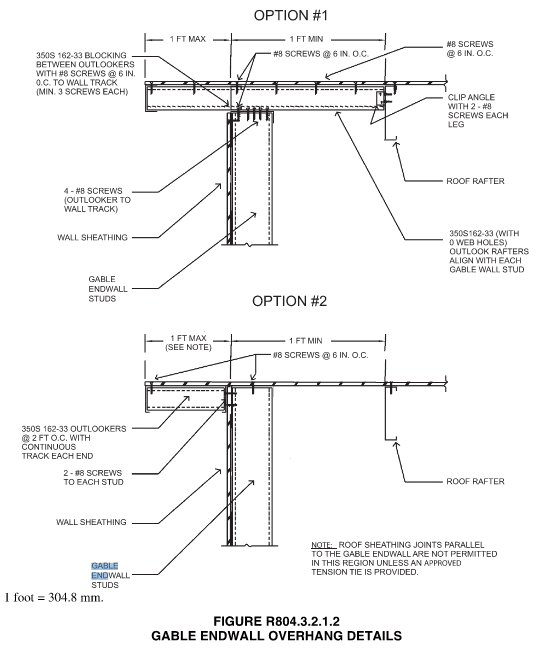

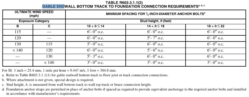

within the cold form portion, the following table appears to support this hypothesis, it varies bottom track fastening based on stud height. to tell you the truth tho I don't do much cold form, and the table does not make sense to me. seems like you would want to call out max spacing, not min spacing. also the spacing values listed in the table seem to have experienced some kind of a printing error. I'm not an expert in this tho, somebody let me know what I'm doing wrong here.

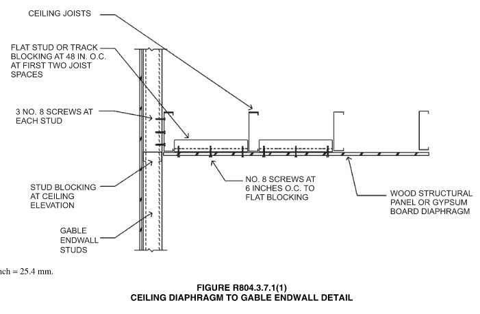

the following is the only sketch of the gable end I could find. it also supports the hypothesis that the committee's intent is to ban the truss to wall hinge, since the sketch shows a wall.

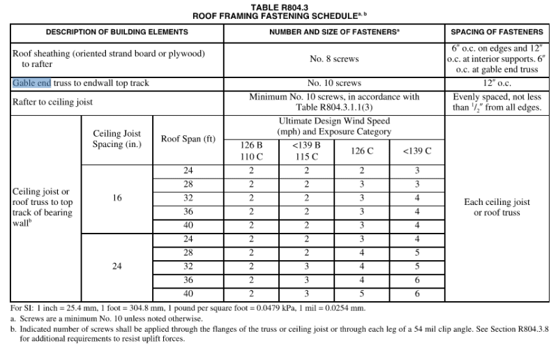

however, that hypotheses is largely shut down by the table below, which specifically calls out the required fasteners between gable end wall and gable end truss.

The detail does not show a sheetrock nailer or sheetrock which is what typically braces it - for better or worse. in high wind areas, the IRC requires balloon framing (at least in the NC version)

Irc requires a continuous load path so that's where it's outside the code for the hinged gable end. You'd rather stick frame it up to the roof on the end. Alternately you are relying on diaphragm action of the gypsum board ceiling and that's how they sometimes survive, though they usually manifest damage when the wind load is high enough.

@ Mike - Gable wall hinges come in several forms - and gable trusses are definitely one of them. We also see gable walls framed up to ceiling level and then a new stud ceiling to truss alot. Truss packages often come with a detail for bracing gable trusses out of plane, but my understanding is that this takes care of the wind on the face of the truss but does not take into account the wind from the wall below. Even at that it is better than nothing. Like many I prefer baloon framed gable walls or an adequately braced "hinge"

That detail you show for cold formed steel the tie is in tension, I think the gypsum board ceiling is more accurately described as a diaphragm, so it's in shear more than outright direct tension, unless we want to start debating shear as diagonal tension, but a gypsum board is used as a shear wall element, so even if you want to argue diagonal tension, tension-field action, (plate girder), etc, it's still documented to work (*under the test conditions*) and the IBC last I looked did allow a gypsum board ceiling to function as a diaphragm, provided you didn't count the plywood/OSB roof sheathing (which kind of means it won't math out), but it has some recognized capacity in the base code.
The light gage stuff showed up circa 2003, so I suspect there's at least some engineering behind it. Given that the studs are engineered/manufactured to be just crappy enough to be used as substitutes for wood, they may have just calibrated their design to "match" the light frame wood, which puts it in the same rather inauspicious boat as the light frame provisions, "time-tested" without any consistent, documented factor of safety.

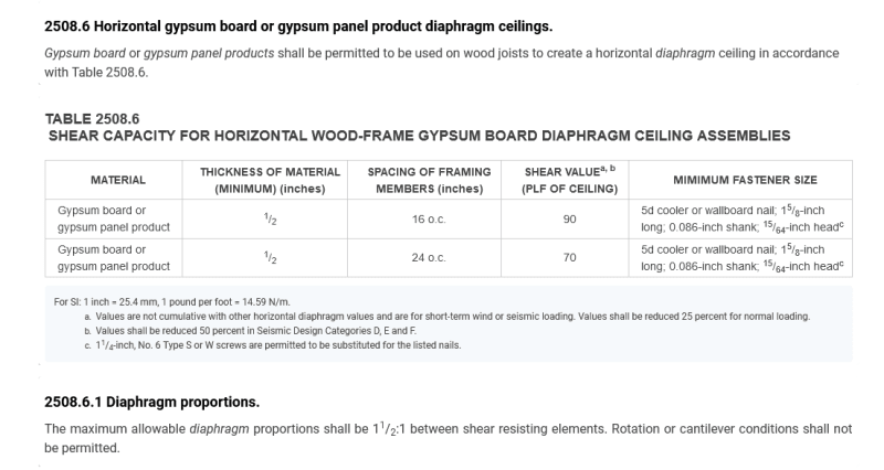

It's in the code, it's just not viable because it's prohibited to use both the gypsum diaphragm from the ceiling and the structural panel above in combination, footnote a). They both have similar stiffness, so they both get involved in reality, it's just not permitted in the code.
( I don't use these in the design sense, I mention this because they have similar stiffness). They gypsum ceiling is not absolutely along for the ride, it's part of the stiffness. We just don't use it, typically, in a structural design because there's something 3-4-5x stronger nearby, the plywood/OSB roof deck.
Source: 2021 International Building Code

Edit: added code link.
Whoa. Where did that come from? What version of the IBC is that?
Never mind. It's in my code, too...but in a chapter I've never bothered to look at. Because why would I? Good to know it's there, though I have no intention of using it.
It's not the most useful provision in the history of man, particularly with footnote a, if you read it.....
It's as though it's designed specifically for the gable end bracing condition we're talking about. Wind loads on all other surfaces will go to the roof diaphragm - just the stuff acting around the hinge would go into this one.
