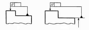

I was staying closer to self-datum definition described in Krulikovski's "Advanced GD&T":
Now to my collection of pictures.
In the times of common sense there were simpler rule allowing you to:
Do not assign letter to datum feature if you don't have to:
To show that there is no difference, which feature to use as a datum and which one control:
And simply say "those two to be parallel to each other":
Like I said, it's from my collection of pictures and tracing the sources may take extra time.
Old version of ISO 1101 has something similar to first one:

semiond,
The same concept is used to define the circularity:"5.4.3 Circularity (Roundness)
Circularity is a condition of a surface where
(a) for a feature other than a sphere, all points of the surface intersected by any plane perpendicular to an axis or spine (curved line) are equidistant from that axis or spine"
CH,
You did not answer my questions about what would be your own opinion about the differences between your shwon cases A and B.
There is no difference - they are both wrong.

semiond,
Do you understand difference between parallelism and flatness? One has datum, another doesn't?
Well, it's the same. Cylindricity is runout without datum. If it has datum, it's not cylindricity.
End of story.
