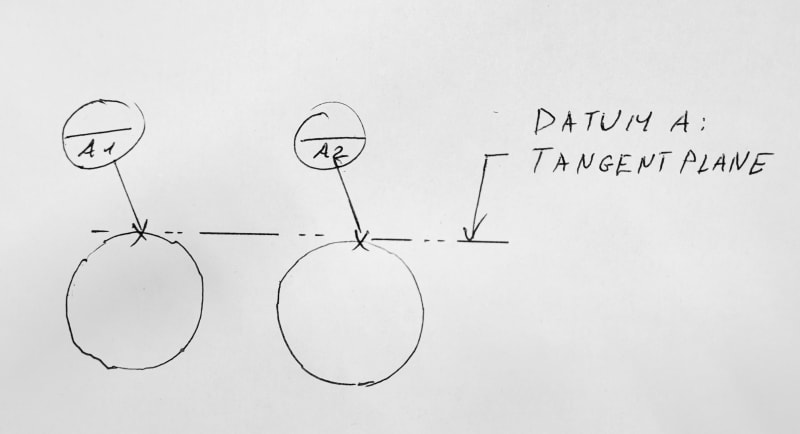

I have a part with two partial cylindrical surfaces and I want to make a datum that is the plane tangent to the two surfaces, as the mating part has a flat surface that is seated up against them.
Part is similar to this example I mocked up:
And I want the datum to be tangent to both surfaces, like so:
Can I just sketch a line between them on a top-down view like in the above picture, and attach a datum to that?

3D said:
"a can of worms"? Have you anything to support that
It would be a can of worms because if it becomes legitimate to attach the 'datum
feature symbol' to a representation of something that is not a 'datum feature' (such as a theoretical datum plane tangent to non-planar datum features), it would open the door for all kinds of ambiguous uses of that symbol.
Some of such uses are explicitly forbidden ("The datum feature symbol shall not be applied to center lines, center planes, or axes.") but still a common drawing mistake in the industry. If the rules of applying the datum feature symbol become less strict, such practices may become even more common.
Other than the explicitly forbidden placements of the symbol, other bad practices could get some legitimacy. Once I've seen a drawing showing a line representing a plane completely detached from the part, and not as part of a coordinate system, with the datum feature symbol applied to it and no robustly specified relationship to any integral features of the part.
If we agree that a datum feature symbol is only intended to assign an integral datum feature, we minimize those issues.
A datum feature symbol needs to indicate real surfaces on the part. My proposal and the diagrams in the standard already show that they can be applied to this case.
What bad practice can happen as long as the requirement is that a real, solid, flat datum feature simulator would contact the part as shown on the drawing?
Not only do the examples show that, several show that one contact with two bumps are sufficient to locate one such plane, that plane is used to set the orientation of a second plane that is contacting one bump.
Since this is the way real parts really function and can really be inspected, the "bad practice" suggestion comes across as unfounded. It certainly would not allow a floating unrelated datum symbol.
If we agree that datums are tied to surfaces on parts, then we minimize those issues. I don't see real surfaces on real parts as "ambiguous." If you can sketch a case where no one could understand how a plane of defined location and orientation could be not understood to have a defined location and orientation and is currently accepted otherwise, it's worth considering.

You haven't made a case, even though you attempted to borrow the metaphor. There is never full contact with the datum simulator, not ever. Datum targets say that only specifically located portions - I have asked for your way to specifically locate the portions and you have not done so. What dimensions and what targets? The target system tells the exact configuration of the inspection equipment. What targets and what dimensions would be passed to the gauge maker to work with?
There is never full contact with the datum simulator, that is correct, but there is a difference between specific elements designated for contact, and an infinite number of potential contact points on the entire surface of the feature. I assume you got the gist, so it seems going into semantics with that was non-essential.
"What dimensions and what targets?"
As I mentioned: "If the contacts are defined by tangency to a plane, as in the OP's case, this can be indicated on the drawing by a phantom line passing through the datum targets, and possibly a matching note, if considered necessary".
Those would be datum target lines of course, as I've repeatedly mentioned throughout the discussion (and I apologize if I haven't communicated it clearly enough).
The phantom line indicating a tangent plane in combination with datum targets may not be a commonly encountered solution, but at least that solution would be consistent with the choice of the symbol to designate the datum feature, depending on the type of intended connection with the simulator.
Datum target lines have only single points of contact on surfaces they are tangent to.
The desire is to use the full depth of the feature which is why I remain doubtful of your intention to not have the same contact.
There is no example of a target line being tangent to two curves at the same time, invalidating them for the same reason you wish to consider cases that are shown of a plane making this same contact invalid.
If I want a plane to contact two pins, that is shown here:
There is no doubt there are two planes; only one tangent to two cylinders is required so only one extension line is used. This can be seen by even a casual reference to the standard, where a close reading is required to find what you didn't know existed until this thread and does not seem to have been noted by anyone else on the committee. No one using Y14.5 should also be required to know what is in Y14.41 to interpret a drawing.

3D, I'm surprised that this isn't clear by now. I'm referring to exactly the same type of contact as you – linear contact in the depth direction (along the cylinders) in the contact areas with the plane.
The difference is only in the way it's defined on the drawing. I suggest, for the sake of language consistency (like in programming languages), to label a datum feature intended to create linear contact with the datum target line symbol, as is done in the more trivial examples.
The information that the measurement fixture designer will receive is that the contact lines are determined by the tangent to the plane. The way to convey this information is through a phantom line, in the view where the plane is a line, and possibly also a note. My goal is to maintain language consistency for all cases where linear contact with the simulator is required.

No need to find an exact dimension to locate the high points. The intent is that a planar simulator is used to contact both cylindrical surfaces. This is the information to convey to the gage maker - and it shouldn't be a difficult task to convey that information.
You were clear that datum target lines would be involved. I see datum target point indicators which aren't in the examples in the standard for datum target lines and that use appears to open an avenue to confusion. In addition, datum targets typically do not get datum labels; they are standalone. No [A], , or [C] appear in Figure 7-58 and no additional labels or notes are used or required to show they do.
A datum symbol is the standard way to indicate this sort of datum, as done in the figure that this example would negate, on a solid line that is aligned with a surface.

When a datum target line is also shown in an edge view it gets that symbol. The location of the datum target line is given as dimensioned to other datum features or other datum targets in that case.
No FOS. No associated dimension line. Just a solid line to indicate planar, in this case, contact the same way solid lines are usually used to indicate a plane is the intended datum.
That solid line is just an extension line common to two planar, and coplanar, surface outlines. If those surfaces were curved instead, I don't think such representation and use of the datum feature symbol would be well-supported.
Also, application of datum targets does not mean that unnecessary dimensions are necessary. If the two pins are fully dimensioned, no additional dimensioning of the datum targets would be required. The relevant basic relationship (parallelism) is implied.
The use of simultaneous tangency to two or more curved surfaces already is supported and no target lines are required so no dimensions for them are required.
The reasoning for the targets in 7-58 is they are separate parts of a single datum which do not form a plane as opposed to being multiple contacts forming a single datum plane, the condition in this picture:
There are multiple examples establishing a plane of contact on multiple tangencies. There are none establishing datum targets the same way. It makes no sense to interpose an additional step into the process that is reserved for a different purpose.
