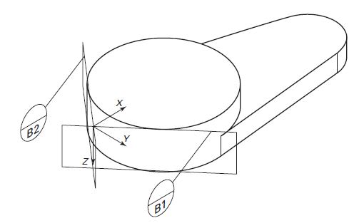

I have a part with two partial cylindrical surfaces and I want to make a datum that is the plane tangent to the two surfaces, as the mating part has a flat surface that is seated up against them.
Part is similar to this example I mocked up:
And I want the datum to be tangent to both surfaces, like so:
Can I just sketch a line between them on a top-down view like in the above picture, and attach a datum to that?

A representation of a common plane in the OP's case could invoke the implied basic dimensions that are required.
A basic angle between auxiliary drawn lines passing through datum targets could define a v-shaped simulator a la 7-58.
There could also be an inverse case in which an auxiliary drawn circle with a basic diameter would contact a v-shaped datum feature on two datum targets at the tangencies, obviating the need to attach the datum feature symbol to a representation of a non-integral cylinder or invent another type of a datum target (cylinder).
3D said:
If the idea that the datum target form should match the contact, then the lines shown for B1 and B2 in Figure 7-58 of ASME Y14.5-2018 are incorrect. That tangential contact between a line and a cylinder is a point and, by the flawed reasoning, should not be lines at all and should be datum target points - the only contact possible for that arrangement.
But that is a logical contradiction, showing the reasoning for the other argument is also flawed and should be rejected.

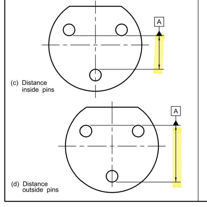

"As I already explained, those irregular datum feature of size examples show a datum feature symbol associated with a dimension line, which is a legitimate use for that symbol."
That is false. ASME Y14.5-2018 Figure 7-42 c and d are not associated with any dimension.
You argue for two different interpretations at the same time. That isn't inconsistent, that is contradictory.

Judging by the above texts, clearly those are considered dimension lines:
The false statement is yours.
Distance is not dimension. I see no dimension symbol in those examples.
I also see no datum target lines in those diagrams.
Those are dimension lines nevertheless.
Those are cases of irregular features of size used as datum features, having very little to do with OP's problem. Had the intent been to relate the part to a datum plane through tangencies only at the two top pins, datum targets would be required.
They are lines that indicate that the width is to be used as a datum feature.
Where are the datum target lines in those examples. That's the contact with the pins - lines - right? Your demand that line contact be represented by datum lines? But then the other contact of a line with a cylinder is a point, which you don't want represented as a point.
"Had the intent been to relate the part to a datum plane through tangencies only at the two top pins, datum targets would be required."
You are making things up again.
Those "lines that indicate that the width is to be used as a datum feature" are part of an example referred to from a text that clearly specifies the attachment of the datum feature symbol to dimension lines.
"Where are the datum target lines in those examples" - nowhere, because as I said multiple timed already, for a feature of size the datum feature symbol can be associated with the dimension line, which is irrelevant to the OP's case.

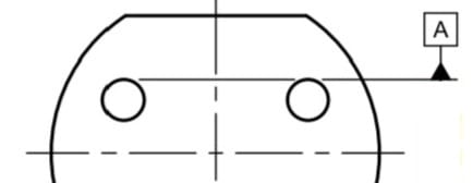

One thing is for sure. The following is an invalid use of the datum feature symbol. You will find zero support for it in Y14.5 text or examples:
Figure 7-52 supports it. I thought you enjoyed finding extension of principles.
"Can be" and "Can only be" are too different things and the committee did not use the second. It shows how it can be used. It can be used for other purposes. That there might be no dimension involved at all if this is on an assembly drawing to align some other feature or part.
You find the weirdest things to link arguments to.

You can use vertical datum target lines on those surfaces if they are given locating dimensions to some feature of the part. It's just that it doesn't represent the use of mutual tangency to a common plane. It also doesn't exclude the use of a mutual tangency to a common plane, as many figures show.
Figure 7-52 does not support it. It shows the datum feature symbol attached to an extension line from the surfaces. Extension lines extend from the outline of the surface. In the image I showed it's not an extension lines the symbol is attched to. It's a straight line tangent to the round outlines.
6.3.2 lists all possible applications of the datum feature symbol. Your suggestion matches neither of them. Assigning local elements of a surface, regardless of how they are distinguished, is what the datum target symbol is for.

7.24.1
If a datum target plane V-shaped true geometric counterpart is required, B1 and B2 would only be shown in the top view. On the model, the V-shaped simulator is represented by supplemental geometry tangent to the cylindrical feature, and the datum target is attached by a leader.
I don't think this would help solve the problem. To ensure consistency, the definition of datum target (para. 3.21) should rather list more target types, including planes and spheres, which I believe Burunduk alluded to.

I am not sure I would agree with this. Figure 7-60 is easy, but in fig. 7-58 your approach would end up in defining two datum target points B1 and B2 instead of the two v-shape lines. I highly doubt anyone would be able to easily figure out from such a definition that v-shape edges, and not two spherically-ended pins, should be used to immobilize the part. (I am sure you see how these two different approaches could/would lead to different relationship between the part and the datum target simulators.)
The same issue could exist in the OP's case if two datum target lines were only defined at the peaks instead of a datum target plane tangent to them.
"The datum target lines are the correct symbolic means to designate a datum feature that connects to the plane along lines of contact."
That is an unsupported claim. The plane established in that manner may well pass through the part, missing the high points, something a tangent plane will not do.
The standard shows that tangency via a solid line creates a plane, in that doctored image and in other cases.
