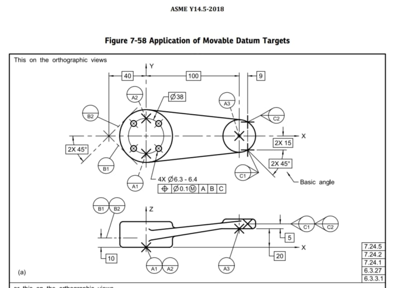

As for the other part you claim I maid up; datum target lines represent lines of contact between the datum feature and the datum simulator, so in the OP's case a graphical clarification that the targets on the peaks are defined by contact with a single planar simulator would do. What part of it is made up?
pmarc,
I see no application of a "datum target plane" in fig. 7-58. It's all about datum target points and lines.
The idea of a "datum target plane" does appear in Y14.41 in the figure you posted on another thread, to which I referred in my initial reply to the OP above.
Burunduk,
I did not say fig. 7-58 shows datum target plane application. I said this term is used in para. 7.24.1, where it is explained how the figure needs to be modified to define datum target planes instead of datum target lines. But how can one define datum target planes if planes, per the definition, are not possible choice for datum targets?
I hope this clarifies what I meant.
That example is intended to establish a datum plane that is not coincident with either of the defining planes.
You want to use a plane that is coincident with the datum plane to define the datum plane. As all the other examples I have given show, this is neither required nor supported.
That is a problem with ad hoc proposals that don't go through the entire committee review process.

7.24.1
If a datum target plane V-shaped true geometric counterpart is required, B1 and B2 would only be shown in the top view. On the model, the V-shaped simulator is represented by supplemental geometry tangent to the cylindrical feature, and the datum target is attached by a leader.
Looking at ASME Y14.5-2018, Figure 7-13 Inclined Datum Feature, one sees that the intersection of two planes that are not mutually perpendicular creates the same control as is being discussed. Since the two contacts in 7-13 are on surfaces of different extents they are given a priority in the datum reference section of the feature control frame.
If, as in the datum target line example, it was a round feature then the appropriate callout using datum planes would be to have both, separated by a hyphen.
The business going on in 7.24.1 is simply to save using a hyphen and an extra character in the feature control frame. Same amount of drawing of datum indicators, more complicated symbols; probably someone in the Y14.41 committee is on the section 7 committee and just added it.
Maybe the person responsible for adding that text thought it was a good idea to make another extension of a principle, after there is already a type of datum target that is not a point, line, or area (and not a plane either) exemplified elswhere in Y14.5. You probably know which example and additional datum target type I'm talking about.
I don't find those extensions of a principle useful. To be consistent, the standard(s) should have stuck to datum targets as representations of the form of the contact between the simulator and the datum feature. For example, if I want to communicate that there needs to be contact between a planar datum feature and datum-simulating pins along lines, as in Figure 7-60 (targets B1&B2), I use datum target lines, not datum target cylinders to represent the form of the simulators. Similarily a datum target plane is not required to define line-contact with a curved feature.
