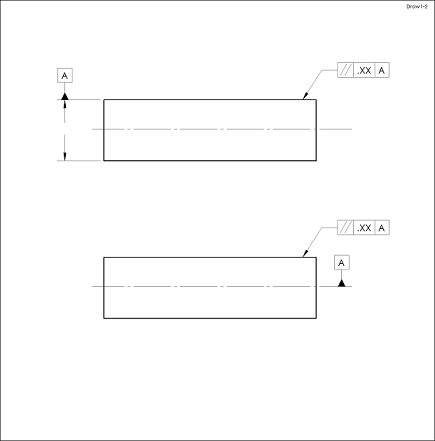

pmarc said:
If you are able to change the drawing, you could assign the width as datum feature and then control each of its sides with paralellism to the datum center plane.
Although it would look weird, it would not be datum self-referencing.
How exactly this is not self-referencing?

This is not self-referencing because each parallelism callout proposed by me requires inspection of a single face relative to the center plane derived from two faces.
If my proposal was to assign the width as datum feature (say C) and then associate parallelism tolerance with the width dimension and use C as datum reference in that callout, then that would be self-referecing.
CheckerHater,
I think that the reason that it would not be self-referencing, is because the datum is derived from the unrelated mating envelope, which is influenced only by the high points of the flat surfaces. The parallelism to datum control measures the entire surfaces (or sufficient sections of them), thus giving a clear enough evaluation regarding the orientation of the features to the datum, and indirectly - to each other.
pmarc said:
If my proposal was to [highlight #FCE94F]assign the width as datum feature[/highlight] (say C) and then [highlight #8AE234]associate parallelism tolerance with the width dimension and use C as datum reference[/highlight] in that callout, then that would be self-referecing.
Isn't it exactly what you propose?
pmarc said:
you could [highlight #FCE94F]assign the width as datum feature[/highlight] and then [highlight #8AE234]control each of its sides with paralellism to the datum center plane[/highlight].
If you use [highlight #FCE94F]width[/highlight] as datum feature, your datum is [highlight #8AE234]center plane[/highlight], isn't it?
The width is the centerplane (datum), but the controlled feature is the face (each single face would have its own parallelism) because the parallelism is NOT associated with the width dimension.
Is my understanding correct?

Could you make a sketch with GD&T symbology applied?
CH,
pmarc said :"you could assign the width as datum feature and then control each of its sides with paralellism to the datum center plane."
Datum feature is the width:
Datum plane is the centerplane of the width
Controlled feature(s): each individual faces/surfaces:
GDT: parallelism of each individual features within some tolerance to C ( datum plane)

pmarc,
I got your illustration.
I really don't think creators of the standard have seen it this way.
Have you seen this dimensioning scheme not even referenced, but at least discussed somewhere else (beside this thread :-))
Yes, I have seen it used and discussed. Does it matter?
Yes, because creating datum from feature being controlled is still no-no in my book.
I would rather assign A to one side, B to another side and control wrt A-B (it's not like I really like it). At least compound datum is not single datum.
But, whatever. Let's hope everybody else understands it the way you do.
CheckerHater, how about what i wrote earlier - about AME (orgin of the datum) versus the entire actual surfaces (being controlled)? The AME and the surfaces are related - but not the same thing.
