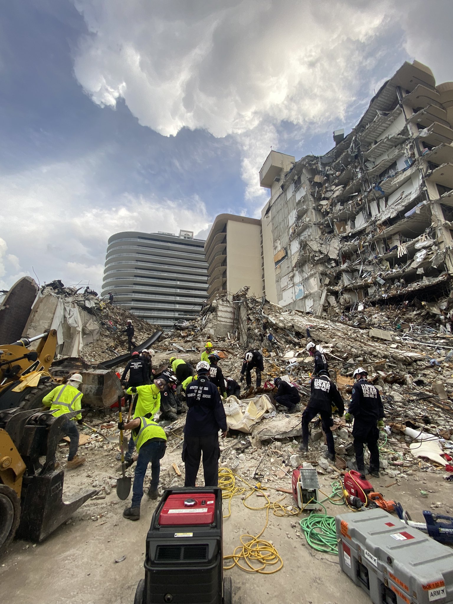

Photo source FTF 2 US&R.
The 8th floor slab has failed differently, possibly with some hinging. Just an observation. Would this give us anymore insight into what we see with the floor above 711 shifting before the full collapse?
This would also be roughly where the family from 904 reported falling to the floor below and staying there briefly (long enough to crawl) before this floor gave away.
What would make this floor fail like this compared to the rest? I cannot wrap my head around it.

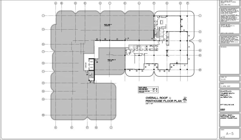

Partial roof area #1 15,496 and #2 1,711 sq.ft = 17,207 sq. ft. for the gray areas. (from preliminary-review-plans-for-40-year-re-certification) called for CCW-500 hot-applied liquid waterproofing membrane.
Two layers, I estimate 15,275lbs for 125-mil coating, plus 10,992lbs for 90-mil, plus 200lbs of felt. Total around 28,267lbs. That's 584 blocks or just over 9 pallets. Plus a little for the felt/fabric for those two roof areas:
CCW-500 Reinforcing Fabric 24lbs/roll good for 2,000 sq. ft. 9 rolls x 24lbs = 206lbs.
Durapax tar-saturated 43 rolls X 60lbs = 2,581 lbs. I'm not sure if this is the old roof material.
The mass of the required roofing materials is significant, stored on the roof and on site somewhere?
I can't see them constantly bring the crane on site to lift more materials to the roof. It was a rush job to start late, rainy season coming.

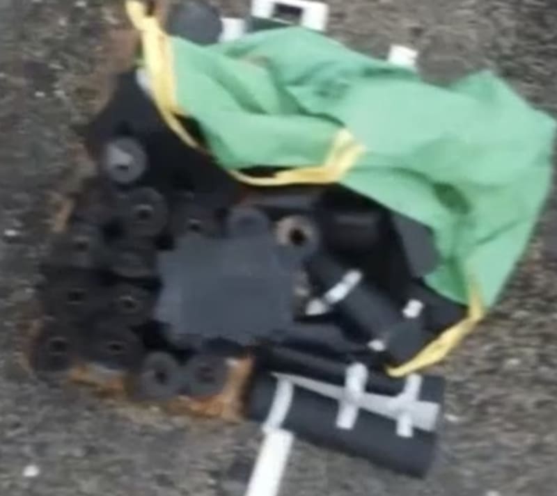

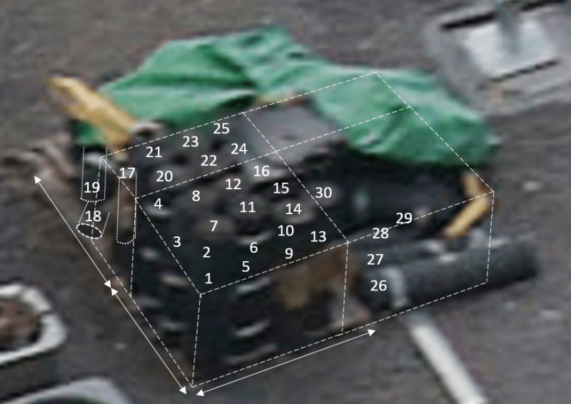

Spartan5, here is my count of tarpaper rolls. I preferred to use my figure instead of the one you provided because mine showed them in a perspective view instead of a straight top down view.
I can count 30 rolls that I can see, with 25 of them on the two left-hand skids. I assumed that the two right-hand skids carried approximately the same number. Some are covered with the bag and some have been used already. I found out that the symmetry was more like 8x6 rolls rather than 7x7 rolls.
