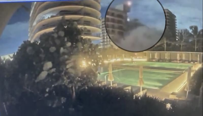

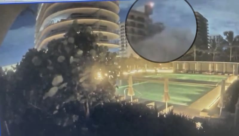

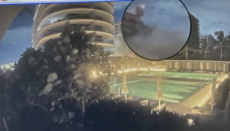

24-27 - It collapsed upwards slightly if you believe these are true frames of the building.
This is why each frame must be registered The smartphone, whatever was moving around quite a bit.

They'd perhaps be synchronous unlike in the video, and much shorter than electric sparks. A typical xenon flash is 5 microseconds. (One can be seen on exposed 13th floor passageway - two strobes, a few seconds, another two strobes, each strobe occupying exactly 2 frames.) A typical arc/induction spark is ~10 milliseconds and the were 12 tubes going east from each meter room. A single exposure at 30 fps naturally maxes at 33ms.
The strobe heads are located both interior and exterior at every non ground level exit. One of the interior fixtures in the UPH corridor is visible momentarily before disappearing. The units flash at a rate of 1FPS for 4 cycles, pause for 5 seconds, then repeat with asynchronous flashing alternating between each floor. Now add in more asynchronous flashing from circuit delay along with the different frame rates it was played back on the front desk display, the device used to record the playback, which was then uploaded for distribution, and viewed at every display frame rate, it’s going to look strange.
Look back and note I did not state that there are ONLY reflections. A small number of interior lights are visible and an even smaller number of exterior light sources of other origin are visible on some balconies.
The Surveillance system at 87 Park captured the entire event from multiple locations at 60fps/4K. It has continuous recording but will not play back at that quality at the Lobby console nor without action event queue markers.

When I play the video I see some flashes that look, to this electricians eye, like arc flashes, a couple that look like the lights were on in that condo unit, even one that looks like a cell phone light for just a second in the last section to fall. I can't see that any of these lights prove anything one way or another. But there were a whole lot of flashes that could line up perfectly with the full moon that was out that night reflecting off the window panes as they fall. That just makes it that much harder to attribute the flashes on such poor quality video to anything meaningful.

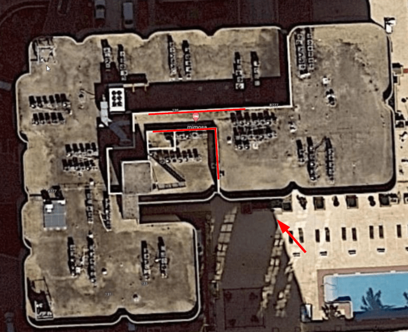

"Alternatively, the failure causes a redistribution of load which affects M9.1 and causes the M9.1-M11.1 beam to detach from M9.1. This then puts the plaza slab into overstress and starts the plaza failure, without anything falling."
I believe this is what happened rather than debris falling to the deck. There doesn't seem to be any evidence of it really. If the roof collapsed anywhere, that slab centered under E2.1, H2.1, E4, and H4 is likely the most suspect place with the work cenetered around it to avoid shoring.

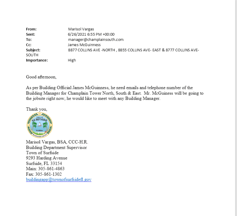

Missing/disorganized building records at a commercial storage facility rented to former Surfside inspector... the plot thickens
Auri, is it related to this?
They released this a few days ago, alone. I thought that was odd.
Not implicating McGuinness, but odd email to release.
Edit: to release on it's own as the email file, not a PDF.
FOIA request issues makes sense now.

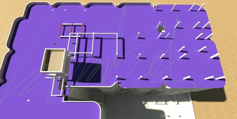

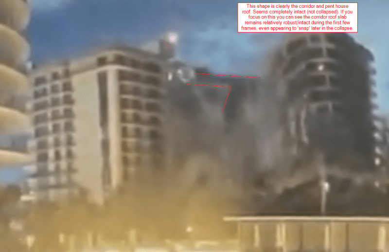

The cooling tower and support assemblies didn’t begin to move until after the 2nd collapse portion fell. If you look at the Surveillance video frame by frame, it’s path and sequence is completely visible. It ultimately falls to its final position just before the 3rd section falls and the dust cloud obscures the view.
When the skin is peeled away, things look a bit different and remove the roof first theories from the list of suspects.
I can't see anything clear enough in the video frame by frame.
I also fail to see how removing the skin removes that theory entirely. Help me understand. If tower didn't fall, sweet. Let's check that one off as a nope.
If the slab below the support structure fails, but the tower remains is still a possibility. This questionable work in that area involves some questionable work to avoid shoring the slabs for 3 floors. We shores floors to support them to prevent collapse, yes? Lets say we come up with a gimmicky way to remove a beam for a full beam replacement. What we're gunna do is carry up sections of beam, and then bolt them together. Tap into one of the A/C units and run a little transformer welder to stick some shit on. It's bolted, doesn't need to penetrate 100%. We'll weld some small sections of beam to the sides of it next to the support, drill some holes and bolt this thing right on down to the column. Now we weld this beam to the cooling tower. Job done, awesome.
Now, balcony repair company comes along and removes the beam, but uh-oh, this weird bolted together weldment with some only 8 3/4" by 5" Hilti bolts that bolts it down to the columns sags.
They didn't call in a crane to lift it.
They didn't shore 3 floors down to support jacking the beam and tower back up.
This work also got done rush rush and given the stamp of approval even though the field inspector/SI was not witness to the pouring or completion, but somehow the steel beam was back up supported under a concrete beam with minimal cure time. Something weird went on.
Edit: But then again, this was the same crew that shored the x11 and x12 stacks straight down to on top of the pool deck. Smart crew this one was. Multiple days reported they didn't even have work plans or shoring plans on site.
Why can a SE design something and a company be allowed to go around the SE's design/plans and hire a new PE to quickly sketch up a "let not have to go into people's unit's" shortcut? Craziness. It's almost like this was done on purpose to hide it from the SI, who was one of the engineers of the original consulting form overseeing the concrete restoration work.

I’ll put together a 3D PDF, with some FEA model examples. But to be brief, the available alternative load paths based on the framing layout and debris field doesn’t jive with a top down modus of failure.
