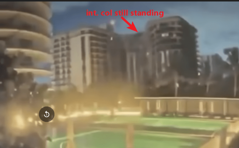

The Nir family saw the southern edge of the patio/parking/plaza/pool slab fall in advance of the building. This video shows that it had failed all the way across to the 9,1/10 columns and southern wall of the north wing of the building. Then a pause, at least 15 seconds, but possibly several minutes, before those columns failed and brought that section of the building down.
If that pickup truck is heavily loaded, it's potentially a smoking gun, starting the collapse at I14.1. That's total speculation, but there's quite significant load from the vehicles parked around the I columns at rows 12.1,14,14.1 (the three columns under the eastern wall of the surviving southern wing of the building). I wonder if any vehicles associated with the construction work have been using that area? The entrance wouldn't let you get a big construction truck in, but you could certainly get some vehicles that are much heavier than cars in there.

The tick tock video clearly shows something over the garage ramp.

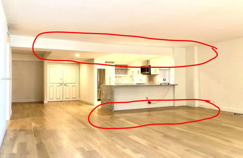

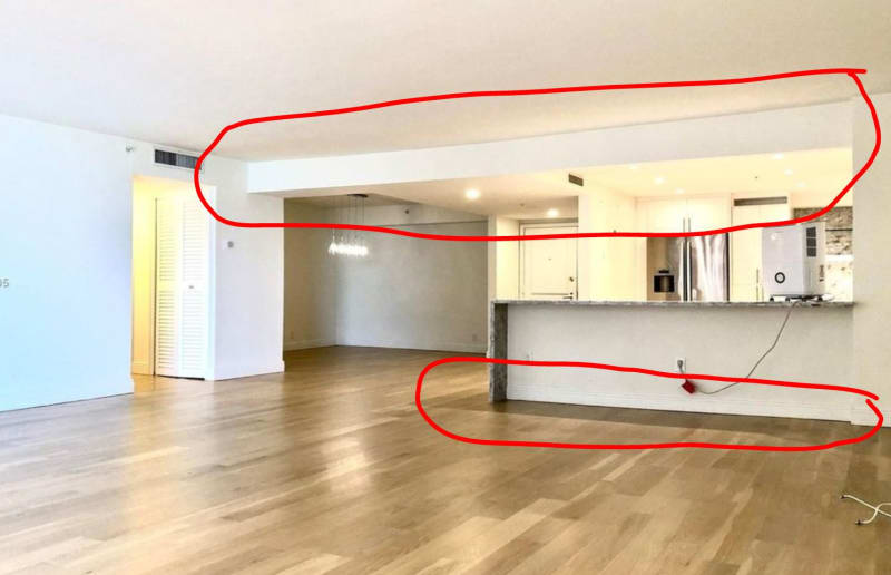

There was clear deflection in unit 1010 prior to collapse, the mislabeled column I found (see post above) is between the coat closet and laundry in the photos below - this deflection is more than normal in concrete (in steel is this is more normal in a long span.)

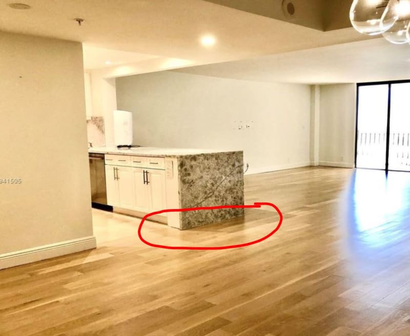

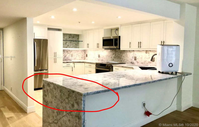

To me, those photos do not indicate clear deflection.

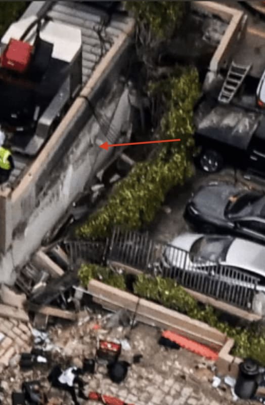

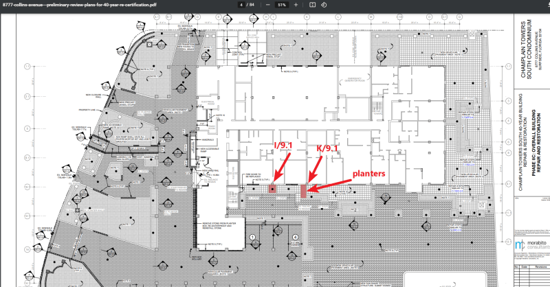

Regarding the columns that may have been in contact with soil in the planters: I have found a particularly interesting item. See clips below. Both of these columns were not only located at/in/part of the planter, but the planters were irrigated (I never considered that plants need water). Clips from pages A2C-1.0 and LR-1 of the renovation drawings.

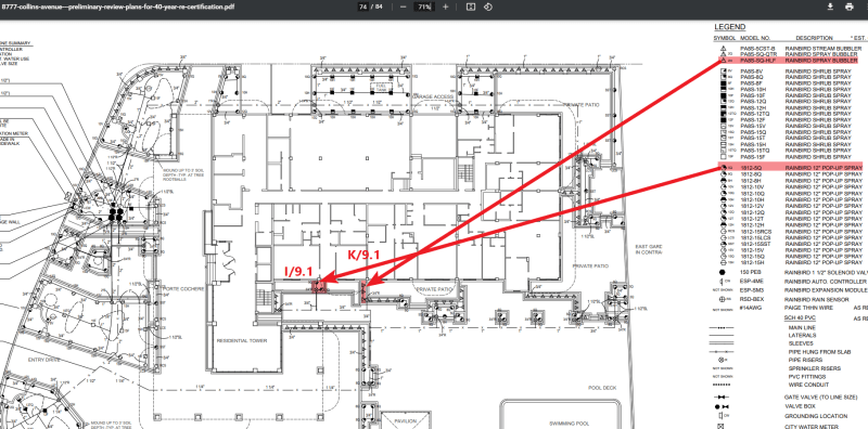

Looking at the video it appears that the column on grid I/9.1 was the first to go, although I can't see the interior columns to the north.
1) this looks like a low point (+10'-10" only open to the pool area to the east) where the slab would seem to be at higher risk of corrosion. ;
2) there is a 2'-6" step in the slab at this column joint.
2.a) this leaves a decent offset between a potential lateral load implied by a failed slab panel (possibly yellow area?), and the restraint at the primary deck at +13'-4".
Next, perhaps since all the columns along grid 9.1 are tied together with a beam at the slab step, if column I/9.1 (i.e. "the suspect column") collapsed first, that could potentially mobilize a force on grid 9.1 columns acting to the west, with load path bonus from the steel in the perimeter beam.
This seems to be reflected to some extent in the collapse video - the columns along grid 9.1 are among the first to go, starting at the suspect column and propagating east.
I would be surprised if you didn't know that interior shots are often taken with a wide angle lens which introduce distortion to the image. Unless you know what lens was used you can not rely on these images for analysis.

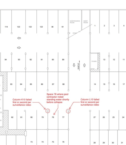

Question here - Could it be possible for column L10 to have failed first, but the initial impact seen was on the adjacent pool deck?
I still find it difficult to believe that failure of a single column can bring down a building, but if that one column failed and then that led to the pool area slab pulling away from the external wall and then rippling the failure across the deck area as witnessed by a number of people then that effect went into other columns?
The failure may have started at the pool deck area, but I think a lot of people are trying to work out why and not seeing a good reason.
The column in question looks on this plan view from a post above to be the most vulnerable to anyone entering down the ramp and running into it. Coupled with apparent surface water ponding over the years maybe it simply failed first?
