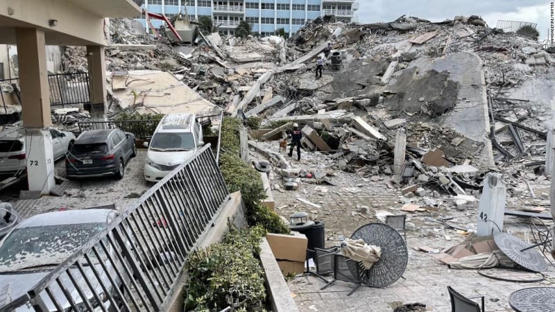

A large portion of the pool/amenity deck underwent some measure of collapse, and according to a couple different eyewitnesses this preceded the superstructure collapse.
I would be surprised if the investigation ends up showing that an issue on the roof ended being the primary, driving factor in this collapse. A contributing issue? Sure. Perhaps even the straw that broke the camel's back. But structure at the amenity level is what to me warrants a tremendous amount of initial attention. A bit of extra load on the roof or not, the amenity level presents as if it were a bit of a ticking time bomb.
Spartan5 : said:

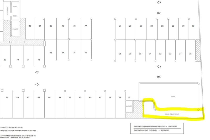

warrenslo - the collapsed pool deck:
The pool equipment room where the pool contractor took the photos (highlighted in yellow below) did not collapse, it is still standing today.
We do not know if the pool deck collapsed first or if the building collapsing on it brought it down (more likely the latter in my opinion based on the damage pattern and 111's testimony.)
111 seems to have escaped via the pool deck as he said he went outside to go investigate and he had direct access - if the pool deck had collapsed 1-story into the basement at this time then this wouldn't be possible.

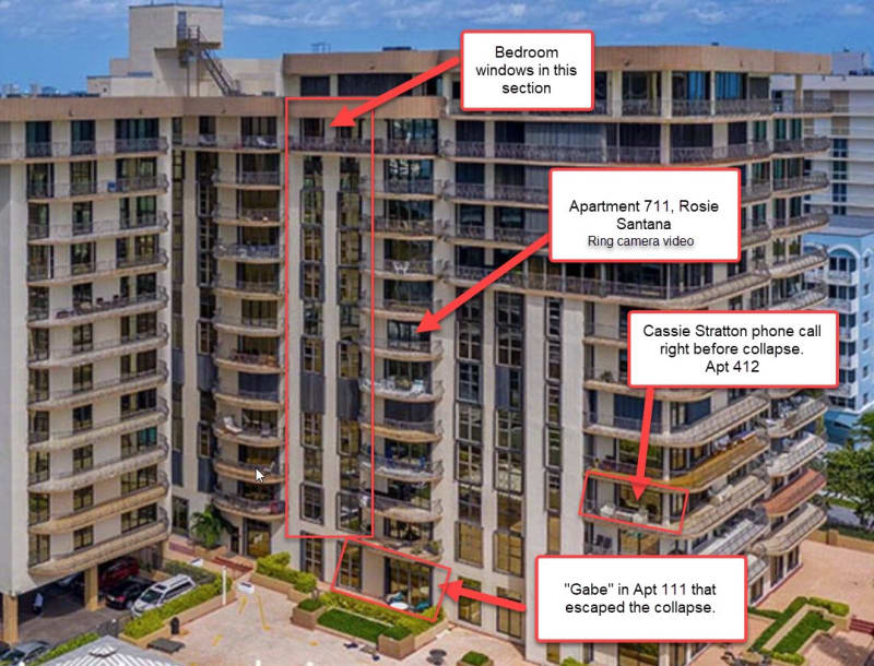

From 412's vantage point she wouldn't have seen the first collapse, her guest bedroom is in the way, only floors 9-12 in the x12 stack have a balcony viewing the initial collapse. Its likely she was seeing pool deck dropping due to the initial collapsed portion of building falling on it. This is evident by her phone cutting out seconds (not minutes) after which is when the second portion of the main collapse occured.
412 had a wrap around balcony that directly overlooked the pool. Same view as 111, only higher.
URL]
URL]
warrenslo is advocating that the first collapse was under Nir's apartment. If so, Stratton would indeed have had trouble seeing it.
But it appears what she DID see was the collapse (or the aftermath thereof) of the pool deck, while still standing in her uncollapsed apartment.

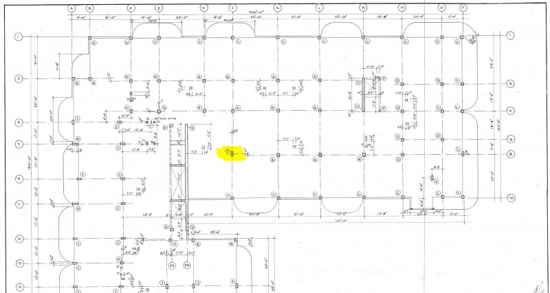

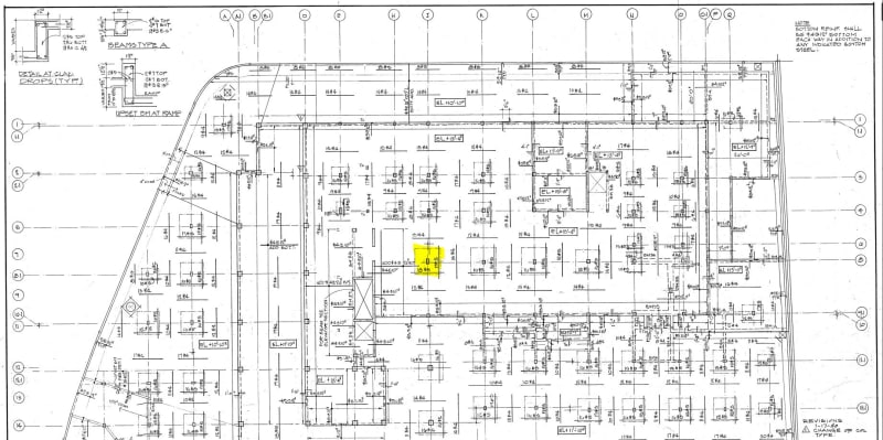

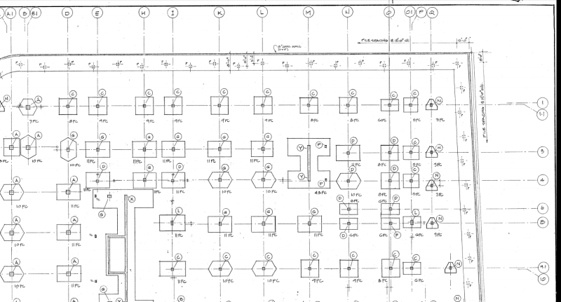

I just found something interesting:
Column I-8 appears to be mislabeled as a column type G on the structural framing plan, it appears it was supposed to be a column type L.
It is clearly longer and skinnier than the remaining G columns in both the architectural and structural drawings.
The roof replacement (Roof #2) is directly above this column.
I think we're all having a little trouble connecting the collapse of the pool deck to failure of the building columns. There must have been some sort of horizontal propagation of slab failure, leading to punching shear failure at the building columns due to unbalanced moments. This then doubles the unbraced length, leading failure of the column in compression.
Not the traditional form of progressive collapse, but plausible.

I took her interview as she was in the southern portion of the lobby when the first major event occurred which would allow her to see the cars falling (she said she saw cars getting swallowed up in another interview) in the guest parking lot just outside the lobby; the guest parking area is adjacent to the pool deck separated by a gate and planter/fence. To me it sounds like the pool deck/guest parking area collapsed first then she went and got her kids and got them out through the front lobby. When they got across the street the building went down.
My bet is this is where it started ('cars sinking into basement'). Punching failure and progressive collapse towards main tower and overloading columns I10 & K10. Load transferred on the demising walls on grid K (cracks seen rapidly opening in wall by resident on 6th floor), she got out in time. I8 or K8 (or thereabouts) then failed.
