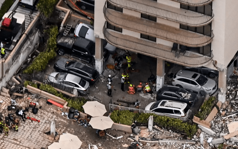

Every spot in that parking area was occupied. Any better images of the load on that pickup?
This would have been within view of Gabe Nir while she was in the lobby having security call 911.
This fits her account of the "parking lot of the building collapsing, like an abyss that has opened up beneath it,”. She wouldn't have referred to the patio as a parking lot.

Since the very beginning of the thread, the most telling imagary was the punching shear failure of the pool deck, and specifically IMO how it extended all the way into the small guest parking area under the uncollapsed section..
secondly, how perfectly the slab punched through, leaving so little damage, or remaining slab tied to the coluums. Not even much rebar on show. No drop panels in sight either.
So no matter where in this area the failure initiated first, the fact is a single column or joint failure somewhere either beneath the pool deck or the guest carpark has been able to rapidly spread across the whole area and someway under the collapsed section of the building. with punching shear failures at every column on the patio deck by the looks. That's surely got to be a clue that the slab-column joint's are a universal issue
