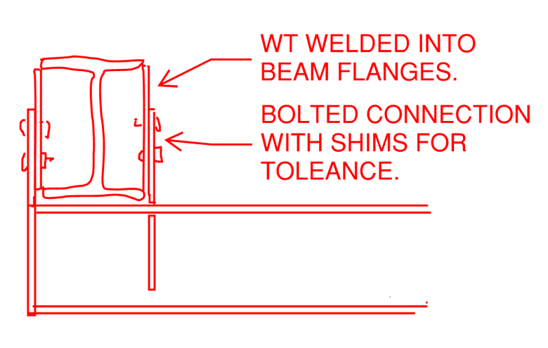

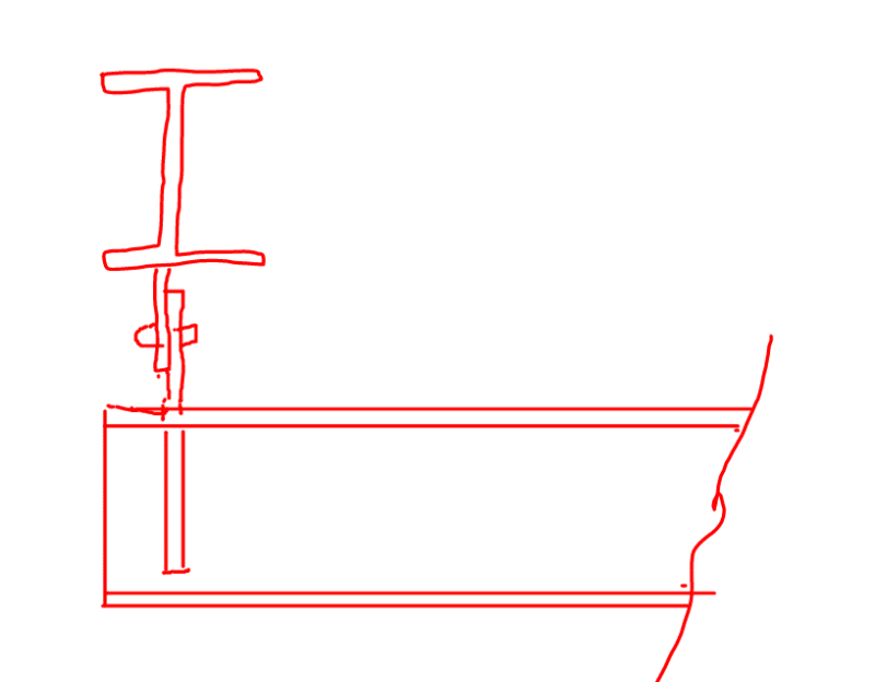

I don't love the use of a connection prone to prying in a situation that might subject the connection to a fatigue demand. Is there some, practical reason why the connection shown below would be infeasible? Blodgett would approve (at least mechanically).
Note that I know of nothing published that says that there is anything at all wrong with the original scheme in such an application.
Or this if there can be no gap between the monorail beam and the girder. Anything really to move the load around in shear rather than plate bending.

I don't have a good enough feel for the numbers here to be able to comment on that with much confidence I'm afraid. My point was really that:
1) I consider it to be a fundamental tenet of good steel detailing that loads should be moved around in plate shear rather than plate flexure whenever possible.
2) When there is prying, there tends to be uncertainty about the amount of flexural stress generated within the connection. And that means uncertainty in establishing the stress ranges at play for fatigue evaluation.
So, if I'm going to use a mechanically poorer detail when mechanically better ones are available to me, I would want a good reason for that. Possible options:
3) Cost if the basic four bolt setup with it's associated, welded stiffeners that OP mentioned is significantly cheaper.
4) Perhaps your are correct and my bolts and welds arrangement is indeed worse than OP's bolts and welds arrangement for fatigue.
