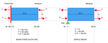

Shear flow is calculated in exactly the same manner for a simple and fixed beam. In both beams, the shear flow is zero at midspan and maximum at supports. In the simple beam, top fibers are compressed throughout the span, whereas in the fixed beam, top fibers near midspan are compressed while fibers near each support are stretched. The change in axial force in the top (or bottom) fibers from support to midspan is equal for a fixed and simple beam. In either case, the difference in moment between support and midspan is wl^2/8.

The sketch below illustrates that the horizontal shear is the same whether the beam is fixed or simply supported.

For the fixed end beam, why are the F values at the top side pointing the same direction? As you mentioned, isn't the midspan fiber in compression, and the end in tension?

I think the F's in his sketches are the ones taken in the slice just before midspan, and the ones just after midspan would flip direction.

F and F' are pointing in the same direction because it is a free body diagram of a beam cut at midspan. Fixity at the support and positive moment at midspan requires F and F' to both point left for top fibers and right for bottom fibers. The horizontal shear to be transferred at the neutral axis is the sum of those two forces. See also EngDM's post directly above this.

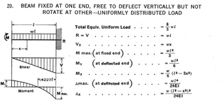

This brings up an interesting thought in my head. When bracing a cantilever beam going into negative bending at the support (to decrease Lu) we typically size it for 2% of the factored compressive load at the brace point, which we have been determining as negative moment / depth of beam. If F and F' get added together as shown in your diagram above, does this mean for a cantilever beam compressive flange brace you need to determine that load as (max positive + max negative) / depth of beam? That's one thing that is confusing me with your sketch @BAretired, when you go from negative bending at the support to positive bending, your compressive flange flips, so wouldn't the sign of F and F' be different?

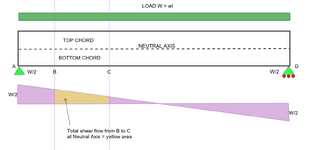

The 2% comment in red is a different matter entirely. The topic in this thread is "Shear flow for indeterminate beam".
Shear flow is calculated by the formula VQ/I, or if shear stress is required it is VQ/It. That formula is correct for any beam whether cantilever, simple or continuous. Shear flow for a beam segment is proportional to the difference in bending moment from end to end of segment. If one end has -M and the other has +M, the difference is 2M and the shear flow over the length of the segment is equal to 2M/d where d is the effective moment arm. So F and F' are both pointing in the same direction for cantilevers.

We ARE talking about chord force. We are NOT talking about lateral bracing.
The top chord force is equal and opposite to the bottom chord force. For a rectangular beam, the total horizontal shear force between the two chords, i.e. at the neutral axis, is equal to the chord force in each chord.

In the diagram below, M1 is a positive moment and Mmax is a negative moment. If F1 and Fmax are M1/c and Fmax/c respectively where c is the moment arm, they both point right for top fibers and left for bottom fibers. The horizontal shear at the neutral axis is equal to the top or bottom chord force, namely F1+Fmax.
I had a thought that ran parallel to the current discussion. I understand that OP is not talking about bracing. I had a question regarding chord force to further my understanding, in relation to chord force and lateral bracing requirements...
So to clarify, if you wanted the compression chord force at the RHS, you would take Mmax/c and NOT the sum of M1/c + Mmax/c. In your sketch above on June 11th you have F + F' = chord force, but the moment due to F is postive and F' is negative, so their top chord loads are in opposite directions (one tension one compression) so why are they additive?
M1 is positive and Mmax is negative by convention but they are both clockwise moments. F1 pushes the top chord to the right. Fmax pulls the top chord to the right. That is why F1 and Fmax are additive. Together, they represent the total axial force in the top chord. A free body diagram of the top chord would show three forces, F1 at left, Fmax at right and horizontal shear at the neutral axis over the full length, all three forces adding to zero for equilibrium.
Axial force varies along the length of beam, F1 at left end, Fmax at right end, but the total axial force acting on the top chord is F1+Fmax. That is the force which must be resisted by horizontal shear at the N.A.
