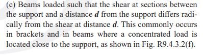

We know that if a concentrated load occurs between the face of the support and a distance d away from it, the shear demand must be evaluated at the face of the support. In this case, regardless of how the span is defined, the maximum shear to be considered occurs at the same location.

If this situation is a moving, concentrated load on a one way slab, then I've got the perfect paper for you. Basically a permutation of punching shear.
Almost the exact text is still there in §9.4.2 & 9.4.3. Also, the commentary of 9.4.3 has a few graphic explaining/discussing the text.
