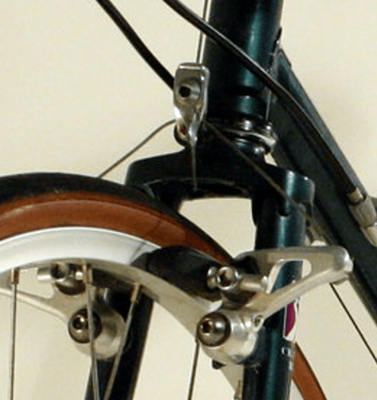

At the beginning of covid I acquired a version of the bicycle shown below. It's a 1992 Miyata 1000LT. It was the best, production touring bike that one could buy in 1992 for any amount of money. It is legendary for being a sweet, smooth, "steel is real" ride and the legend could not be truer. When I ride the bike, I feel so little discomfort in my body that it's almost as though someone chopped off my head and mounted it to the handle bars. I feel nothing but joy and exertion.
Performance wise, the only non-awesome thing about the bike is the cantilever brakes. As cantilever brakes are prone to doing, hard front braking will induce a pulsating front end shudder that is very disconcerting. Before attempting to fix the problem, I would like to accurately diagnose it. Everywhere this question is asked out in the online Bike-o-Verse, you get the same "bow and arrow" explanation described in detail here: Link. Looking at that explanation as a structural engineer, I find it to be utterly implausible. Some suggested remedies can also be found at that link but I deem them to be questionable because, in my opinion, they are based on a flawed theory of causation.
So my first question here is this: what do you think of the "bow and arrow" explanation? Do you buy it? Do you share my skepticism? I have reasons for my doubt, of course, but I'm going to withhold them for a spell here in the hope of not contaminating the thought pool. I've reproduced part of the "bow and arrow" explanation below for reference.
I've got my own theory about the cause of the fork shudder which we'll get into in more detail on later. The short version is that I think that it's a function of torsional fork twist rather than the front to back fork flexing that the "bow and arrow" theory suggests.

Close up of the brakes. The second pic is the the Shimano CX50 system that I plan to install this summer. The CX50 is basically where evolution stopped with respect to cantis before V-brakes and discs took over. I speculate that the CX50's will improve the brake shudder if I make the straddle wire angle steep but, at present, that's a pretty tentative guess.
Intriguing problem. The "bow and arrow" seems plausible in theory...but looking at that fork arrangement it seems to me it would have to be made of 10000ga aluminum to be flexible enough to make a significant difference.

I believe it is due the stick-slip, which originates from the difference between static and dynamic friction. The severity and frequency of the shudder is strongly a function of how rigidly fixed the the position of the brake shoes are. More like a violin string where the wheel rim is the "bow" and the brake shoe is the vibrating string. Loose fork bearings can make this shudder very severe.
I don't like the bow and arrow theory.
Agreed.
I believe the primary source of brake shudder is stick-slip type behaviour. The brake pad is vibrating back and forth along the tangential direction of the wheel rim. Toe-in/toe out of the brake pad can promote or suppress this primary source.
The rigidity of the entire brake system will accentuate or suppress this behaviour. I conjecture that the primary source of flexibility is torsional bending flexibility of the brake arm about the brake post and possibly a minor amount in the fork itself. In the case of cantilever brakes P-Delta effects of the tension on the brake cable accentuating the torsion of the brake arm. In a V-brake the P-delta effect would have a restoring affect on the torsion of the brake arm.

The issue as I see it, is what causes the slip? You apply the brakes and have dynamic friction. If you reach a point where you stick (static friction), the friction force increases, right? Unless you start pedaling again or ease up on the pressure, it shouldn't un-stick.
Its a bit more complicated than that and maybe describing it as stick-slip is glossing over the finer details.
Globally there is clearly no full 'stick' as the wheel is continues to rotate and the pads are globally static. If there is proper stick you'll soon know it as you are launched into a lovely somersault which also gives you a brief moment of contemplating your life choices before pain interrupts such thoughts.
Locally I suspect there is minor stick slip behaviour or at least local fluctuation of effective force due to torsion. This is a common scenario in life. The violin bow across a violin string I think is a good example. The bow is always moving the string is on average static, though there is clearly fluctuations in the lateral force being applied. Other such scenarios occur such a dragging a rubber block across a surface or even dragging a 4 legged table across the floor. In the case of the table you likely do get observable stick slip behaviour, you can see and hear the legs vibrating. But globally the table is moving at a constant rate.

I agree my thoughts are a bit simplistic. As a novice cyclist I haven't really taken the time to consider parts of my bike in a rigorous engineering sense. I started typing that before your previous response - the torsional flexibility of the brake arm sounds good and the scale makes flexibility issues more plausible than the fork itself.
Actually the more I think about it the more I think the table analogy is a good description of the stick slip behaviour. Humour me and forgive me if this explanation is obvious to you.
Consider a table being dragged at a constant rate over a rough surface at a force only slight above the global static friction. Every now and again one leg is going to catch a microscopic edge and move over into stick friction. It continues to stick and bend as the table continue moving until the force & energy builds up in the bending of the leg. Eventually this force exceeds the static friction and the leg slips and springs back. This can be happening on all 4 legs and can be quite noticeable on a table with slender legs because the reduced stiffness means a lower frequency, and higher amplitude & wavelength of slip.
So again to summarise the key ingredients you need is friction, imperfections and non rigidity.
In the case of a cantilever brake, I believe the primary non rigidity is the brake arm itself bending the arm and about the post. (I earlier described this as torsional, though I believe this was an incorrect description.)

maybe something like this? And oscillates between bites and slaps until user releases brake? Seems like the bowstring theory would require a huge amount of deflection of the axle relative to the brake mount relative to the head tube to make any sort of noticable difference in cable tension. Like, a catastrophic amount of deflection. I bet against the bowstring theory.
My 'deformed shape' dashed lines are just general. The deformation is probably mostly in the brake assembly joints and not so much the fork itself?
Exactly that. Far clearer in pictures.
It also helps show why having the break pad "toe in" helps prevent shudder. (You want the pads front of the pad touching the rim before the rear as then you avoid the "bites" section of that diagram.)
