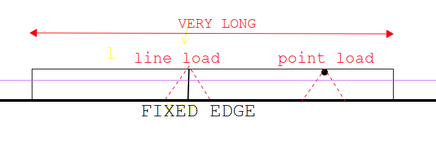

I have a cantilever plate rigidly clamped on one side and free on the other sides, with the plate being very long in the direction perpendicular to the cantilever span. For a point load applied near the free edge, I usually determine the required plate thickness considering load spread at 45 degrees. My question is, for a uniformly distributed load (UDL) along the length of the plate, how should the required thickness be calculated? Do we still apply the 45-degree load spread assumption, or is there a different approach for UDL in this case? Any guidance or references would be helpful.
If the load is uniform in the direction parallel to the fixed edge, you'd typically design that on a unit length basis.
I am trying but I am not able to attach a sketch. Some issue on my side. It's a UDL Line load acting perpendicular .
Treat the plate as a simple cantilever beam. You have a long line load so it is just a simple cantilever calculation with a point load of a unit length x UDL. for a beam that is a unit length wide.
Thanks @BAretired for posting the sketch.
I understand simplifying it to a unit-width cantilever beam with UDL. My only doubt is about the effective width. For a point load on a plate, we often assume 45-degree load spread to calculate bending resistance. In the case of a continuous line load along the length, do we still consider same effective width or beyond unit width, or is treating it as a unit-width beam sufficient for plate thickness design?
