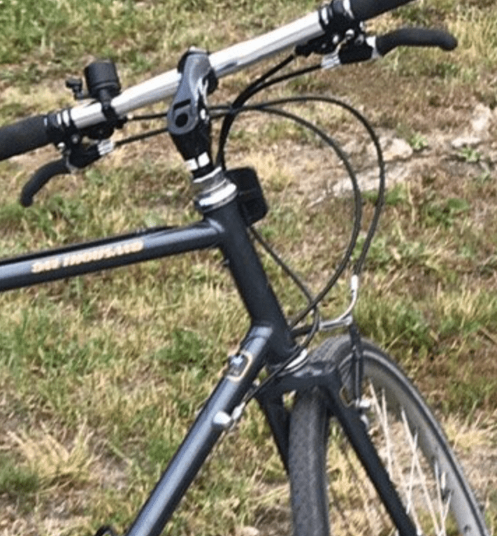

At the beginning of covid I acquired a version of the bicycle shown below. It's a 1992 Miyata 1000LT. It was the best, production touring bike that one could buy in 1992 for any amount of money. It is legendary for being a sweet, smooth, "steel is real" ride and the legend could not be truer. When I ride the bike, I feel so little discomfort in my body that it's almost as though someone chopped off my head and mounted it to the handle bars. I feel nothing but joy and exertion.
Performance wise, the only non-awesome thing about the bike is the cantilever brakes. As cantilever brakes are prone to doing, hard front braking will induce a pulsating front end shudder that is very disconcerting. Before attempting to fix the problem, I would like to accurately diagnose it. Everywhere this question is asked out in the online Bike-o-Verse, you get the same "bow and arrow" explanation described in detail here: Link. Looking at that explanation as a structural engineer, I find it to be utterly implausible. Some suggested remedies can also be found at that link but I deem them to be questionable because, in my opinion, they are based on a flawed theory of causation.
So my first question here is this: what do you think of the "bow and arrow" explanation? Do you buy it? Do you share my skepticism? I have reasons for my doubt, of course, but I'm going to withhold them for a spell here in the hope of not contaminating the thought pool. I've reproduced part of the "bow and arrow" explanation below for reference.

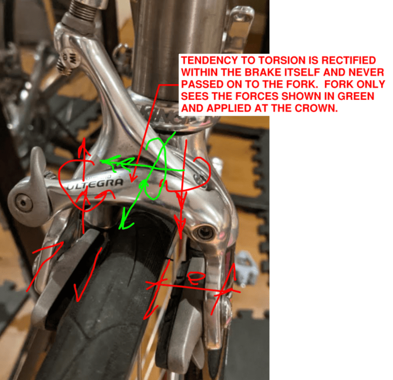

2) More than anything, I can say with considerable confidence that caliper brakes do not produce the shudder problem. A picture of one of my high end vintage calipers is shown below. As shown in the sketch, I believe that caliper brakes and cantilever brakes both exert identical forces to the steerer tube. But only the cantilever brakes exhibit the shudder. That leads me to believe that the steerer tube is not the difference.
It was in examining the caliper brake below that I came to my "aha" moment on this. The same forces shown in red that would torque the forks on a cantilever setup are also present in the caliper setup. The big difference, I feel, is that the caliper setup rectifies the torsion within the brake assembly itself rather than passing it through the fork legs. That's how I've come to believe that torsion occurring between the brake pads and the fork is the culprit.
phamENG said:
I'd be happy to hear the elaboration.
It's bascially the situation shown below with braking applied only at the rear. It's an unimpressive endo of sorts where your back wheel never leaves the ground. The reduction in contact pressure between the back wheel and the ground means that any serious braking will result in the back wheel breaking into a skid and all of the braking power coming from the front wheel.

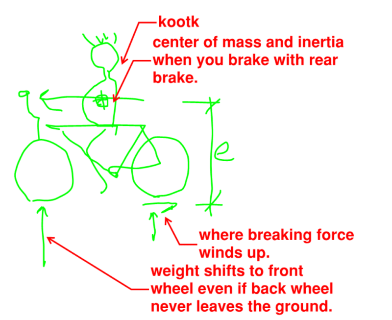

I may be able to offer some meaningful help with regard to your cycling technique.
Firstly, in a lot of situations, rear braking is safer than front braking. That basically includes serious cornering or any time that you're on a surface where you might break traction at the front wheel (ice, rain, leaves, gravel). The reason is simple enough: a front wheel that is skidding sucks pretty badly at steering. And steering can be pretty important. So there's logic in rear braking. The real weakness with rear braking is that it simply won't get the job done in a high speed emergency situation when you need to stop quickly. That, because of the endo weight transfer thing that we discussed above.
Secondly, I've read some interesting stuff suggesting that our common perception of what happens when we front brake and fly over the handle bars is deeply flawed. What everybody perceives is that they hit the front brake hard and then flip over the front wheel with their bodies and their bikes traveling together as a rigid body of sorts. Apparently, what really happens is this:
1) You hit the front brake hard and your bike slows fast. Faster than your body.
2) Because your arms are poorly braced, your body flies over the handle bars separately from your bike.
3) Your bike only flips over because you drag it along with you. This is especially the case if your shoes are clipped in.
4) You and your bike wind up in a heap of pain and shame so quickly that it's almost impossible for you to accurately parse out what really happened.
The moral of the story is that, from a physics perspective, it is nearly impossible for you to flip over the front wheel, along with your bike, as a combined rigid body. You'll invariably start skidding the front wheel before that happens. So, from a technique perspective, what you need to do is to simply brace your arms as stiffly as you can before you hit the front brake. This encourages you and your bike to travel as a rigid body.
I practice this technique a few times at the beginning of each cycling season just to get reacquainted with it. I'll do it in an empty parking lot and can indeed lock up my front caliper brakes without flipping over. It's kind of fun really.

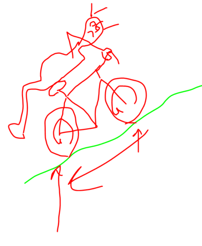

You can def. flip a mountain bike over with disk brakes as a rigid body (squishy fork, sticky tires and a high CG). For maximum braking, they teach us to drop out heels and our CG as much as possible and put your weight back. You can then use both brakes more effectively. Having a dropper seatpost that is already down helps even more.
Yeah, mountain bikers are always very resistant to the concept. I suspect that there are many complicating factors on typical mountain bike ride where one flips over:
1) Maybe downhill bumping up and down.
2) Front wheel may catch in a rut, against a root, or something that changes the physics a bit.
3) Riding stiff armed is pretty much anathema to comfort on a mountain bike.
My hardtail is a Marlin 6 with hydraulic breaks and some sticky, Schwalbe Big Apples on the rims (basically giant road tires). I can lock that up on pavement with just the front brake without going over. The stiff arming basically encourages the weight shift to the rear.

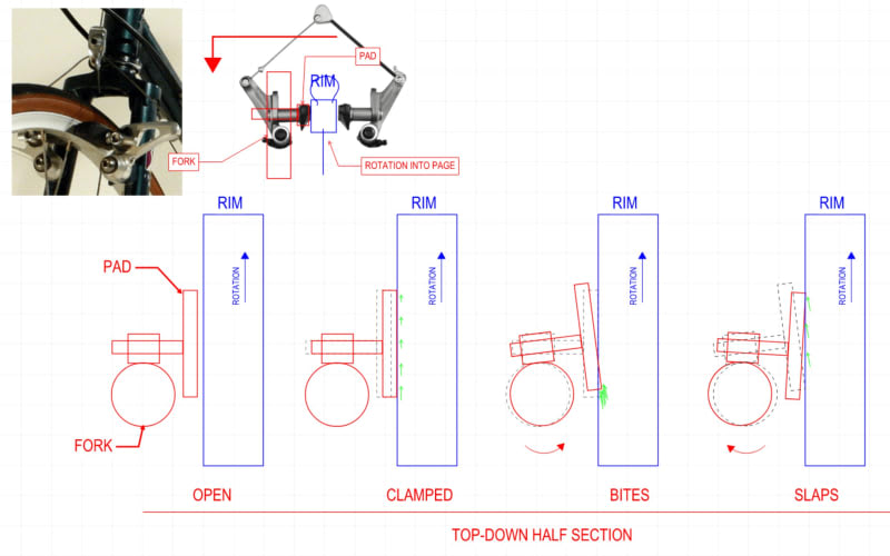

Me too, especially because it saves me the effort of putting a similar diagram together myself.
I agree that the stick and slip is the front end of the problem but I feel that the lager question is why that's a particular issue with the cantilever brakes. Dold's suggestion that it's about the cable pull line of action doesn't speak to me for a couple of reasons:
1) Different models of cantilever brakes and v-brakes actually reverse the positions of the pads vs the cables.
2) I feel as though the main arms of both brake types are pretty solidly moment connected to the braze on mounting post. I don't see the cable offset forcing a rotation through that.
When you look at the diagram below, I feel that it is the transition from "clamped" to "bites" that is of most importance. And, just as dold showed it, that would seem to be a study in torsional load versus torsional stiffness. To the extent that a system lacks torsional stiffness, that gets you to the bite faster. With regard to potential flexibility, here's what I see for options.
1) Lateral flex in the brake assembly. I don't feel that this is a major contributor because:

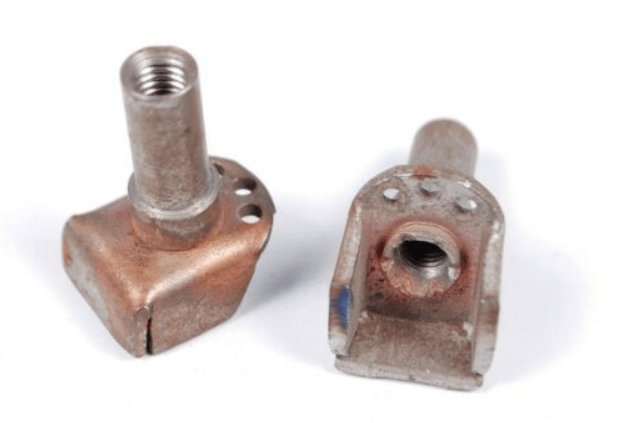

2) Flex in the plates of the little braze on boxes to which the cantilever post is welded. On older bikes like mine, the boxes are three sided as shown below rather than a larger diameter tube which would be better. The walls on my bike's "box" look to be about half as thick as the ones shown.
