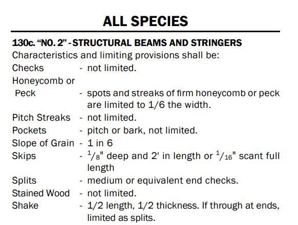

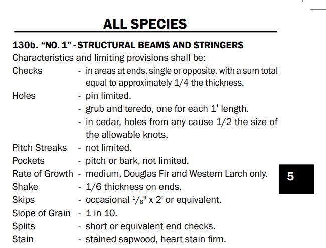

Any concern with the checks/splits in those cantilevered 4x8s? Or is this already considered in the lumber grading?
1) I believe that these would be the National Lumber Grader's Association specifications for this.
2) No limit at all for #2 or lesser.
3) In my opinion a more reasonable limit for #1 and better.
4) One would think that "ends" would really be the high shear location at the start of the back span for a cantilever.
After checking on all referenced material, I find the contractor is quite experienced and smart in leaving the face with checks facing out, and leave the smooth (assumed) face inward to support the interior joists, and not violating the rule - not to glue or use strap to close the checks, for which may impede the wood from expand/shrink during the next drying cycles.
From KtooK's latest excerpt, can this 4x8 graded as No.1 lumber, with the checks near/at ends less than 1/4 of the thickness? Seems the check outside of the end region does not count towards grading.
OK Ya proved it. This OG gives up. One piece.

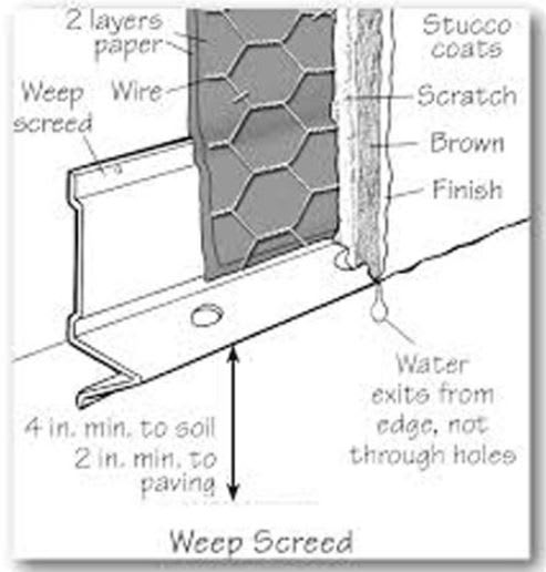

The drainage on the top of the balcony doesn't matter. It looks like a t-bar drainage system on the balcony, but unless that's flashed incorrectly that doesn't matter either. The problem is that stucco is not waterproof and neither is the paint....water will get in there and without proper weeps it won't get out....thus the rot.
Of course the drainage on top of the balcony matters. It's a bucket of water otherwise. But, if what you're referencing is a lack of weep screed at the soffits then, sure, I take your point.
If it is a t-bar perimeter system on the balcony (which is common), the drainage is under the slab, not on top. Yes, you want most of it to run off, thus the conductor head, but there has to be waterproofing under the slab.
Yes, that's the type of weep to which I was referring.
I certainly close my eyes and trust the system. The Australian code simply limits the opening width (3mm) and length of the check (L/4 to L/2), but not the depth of the check. The depth just needs to be less than all the way through the stick. Got 1mm hanging on at one edge? That's a check, not a split. Check is fine for half the length; split of any length would be rejected. Internal checks are limited to 10% of the cross-section though. [ponder]
Moving to USA because you have more documents explaining code provisions, TFEC Tech Bulletin 2018-10 says "the tabulated allowable shear stresses [in the NDS] are based on the conservative assumption of the most severe checks, shake or splits possible, as if the timber were split through its full thickness for its full length." It also says there are limits on the depth of check for the higher grades which is more encouraging than the Aust requirements.
