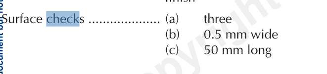

@canwesteng interesting, I have dug up our timber grading standard now and you are right
There is an allowance for checking that varies between different grades of timber...and for 'Building Grade' it is not restricted
To be fair, I'm not sure what "building grade" means as I can't find a definition and it isn't a standard phrase...but I assume that this would apply to deck posts

I think the degree of checking is reflected to some degree in the published design values. Larger lumber tends to have lower allowed stresses.
