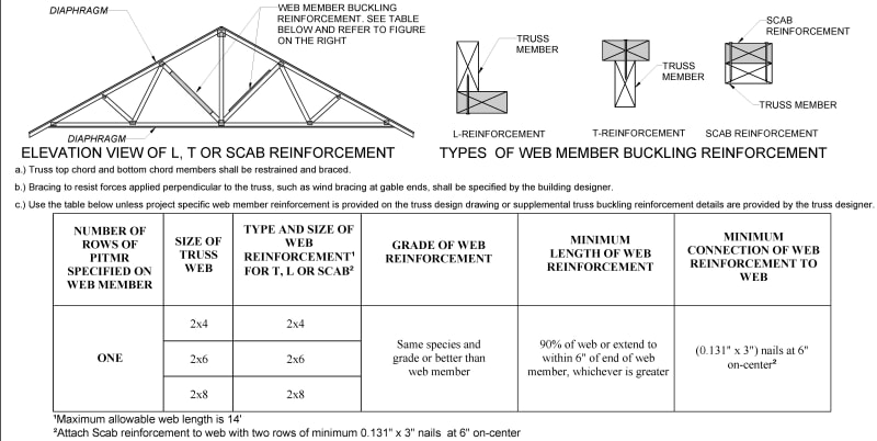

To determine the capacity of this slender post (without getting into composite action), would you consider it as the twice the capacity of a single stud with strong axis buckling as the limiting factor. (i.e the weak axis is braced to equal the strong axis)
I would typically just double the capacity of a single member and call it a day, however I wouldn't be surprised if Perp bearing actually controls assuming this is bearing on a plate.
I wouldn't count this as a double, but ignore the strength of one and consider it as a brace for the other. This is a T-brace that is established practice in the fabricated truss design sphere.
Not sure I've seen any testing on this approach, however.
I recently made a spreadsheet for reinforcing wood trusses and in the process came across a research paper on T-braces (Shrestha, Deepak; Bender, Donald A; Woeste, Frank E.):
The approach in the research paper is to determine an overall effective modulus of elasticity for use in buckling equations. I ended up just calculating the radius of gyration and gross area of the combined section and going from there using the normal tabulated Emin.
Edit: and I take Lu as the overall length of the member, unless there are discrete braces or sheathing attached.

As a side note, XR250, the 10d nail you're showing. Common? Box? Sinker?
The research cited uses a 16d box nail (3.5" x 0.135") @ 6" o.c. into the brace element. First nail is 3" from the end of the T-brace.
Does anyone have a source for nailing for scab bracing (where the brace piece is flatwise against the web)? I feel like I found it somewhere once, but I've since lost my source.
Might have found it.
AUGUST 1, 2016 | SCAB-BRACE DETAIL | MII-SCAB-BRACE
For those who are interested, I found a Mitek detail for a T-brace with nailing that's not consistent (less) than the Woeste nailing (2011 document). It uses 10d nails. 3" x 0.131" is a sinker?
AUGUST 1, 2016 / I-BRACE DETAIL WITH 2X BRACE ONLY | MII-T-BRACE 2 | T-BRACE

I'd use PL Premium and treat it as a T.
@lexpatrie - for detailing the T-reinforcement, I use the prescriptive IBC requirements as a baseline.
