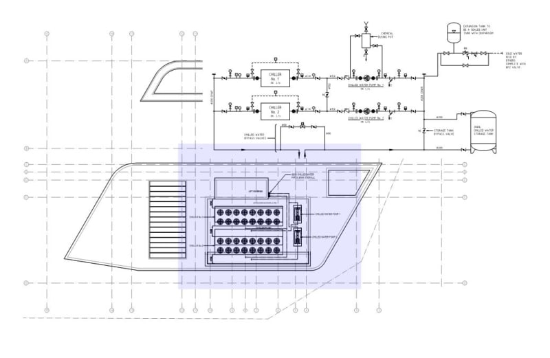

Hello ladies & gents,
I'm tendering on a mechanical plumbing job for this building with the air-cooled chillers & all other equipment located on rooftop.
My client's engineer told me "the required test pressure on the roof will be approx. 925kPa". Considering we test 1.5 times of working pressure, the working pressure will be about 600kPa (87psi).
I wonder if 87 psi is a normal pressure for pump head + expansion pre-charge?
Not sure if this information is useful, but the farthest cooling coil is 130m away from the rooftop plant. (100m elevation & 30m horizontal pipe run)
Hi Moideen, I looked closer at what you are saying. Let’s look at initial drawing that was posted and the information that was given to us and referred to by you in your example:
Given:

In summary, I will advise that this is a low head application. I will also advise the selection of the pump looks cockeyed to me
Hi QualityTime, moideen,
Sorry gents, my question must have caused confusion and data is cockeyed. That's partly because that project I looked at was at a preliminary stage.
This is the doc I've received from my client. There's no schematic available. The only schematic available for the chillers looks like a copy-&-paste from some other project. All the pipe route and sizes are marked on preliminary drawings by the contractor. I don't think they've planned it all out yet.
