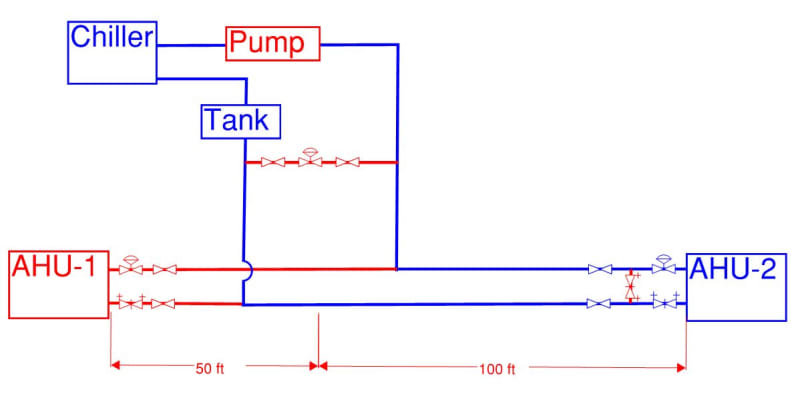

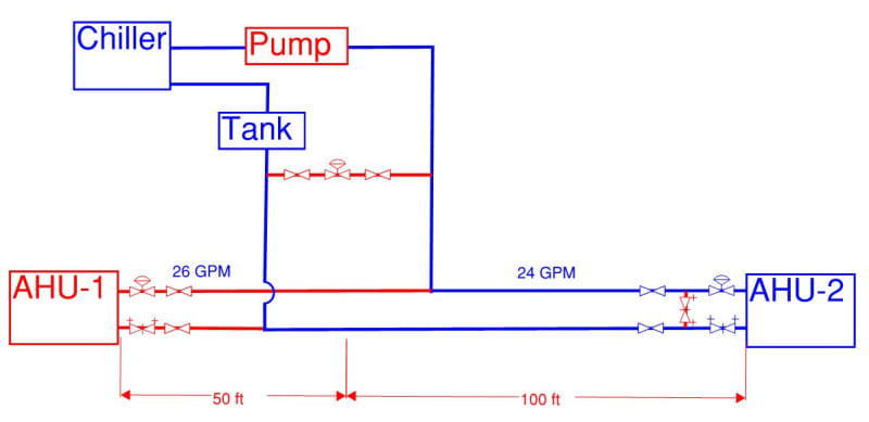

So when we calculate the total friction, we only need to consider the run with highest friction loss?
For example, to get the total friction loss of below, I only need to add up the friction loss in the blue path?
Please assume the flow rate has been balanced to be as below (just in case longer run doesn't make the bigger friction loss)

[li]Yes[/li]
[li]The chiller is on the discharge side of the pump[/li]

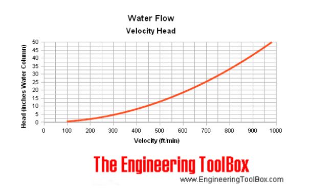

You also mentioned "difference in velocity head between the pump suction nozzle size and the pump discharge nozzle size". I don't understand how pressure head transfer into velocity head.
I've found some introduction on engineertoolbox.com and below graph. Just trying to figure out how it works.
The graph you provided above is not what i am talking about. Pumps, usually but not always, have suction nozzles one size bigger than the discharge nozzle. Because of this we have to do an additional headloss calculation

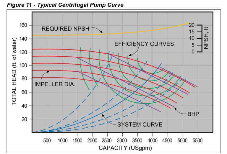

Yet another question... if we have a close-loop system served by a pump with 4" discharge running at 400 gpm (10.1 fps), can we possibly estimate the total friction loss?
I ask this because I can't see the connection between velocity and pressure.
I've seen below graph before but it's complicated for me and I didn't dig into it. Is it relevant to above question?

[li]Yet another question... if we have a close-loop system served by a pump with 4" discharge running at 400 gpm (10.1 fps), can we possibly estimate the total friction loss? - The total friction loss is the blue line you showed in your sketch. The total dynamic head (ft) = total friction loss (ft) + difference in velocity head between the suction and discharge nozzle on the pump (ft). The units are all in ft. I am not sure what is the problem here. I would have thought you would have understood this concept by now[/li]
[li]I ask this because I can't see the connection between velocity and pressure. - Think of it this way, the more water you try to pump through a fixed pipe size the greater the water velocity and the greater the friction loss (i.e.pressure loss) per unit length of pipe. From a practical point of view how does one decide on the correct pipe size to begin with? For pump discharge piping the piping is sized for a water velocity of 4-10 ft/s and for the pump suction piping it is sized for a water velocity of 4-7 ft/s. I will guarantee you that if you have a velocity of, for example, 15 ft/s the piping will be screaming from the noise of the water flowing through it. Do not confuse high pump discharge nozzle flow velocities from discharge pipe velocities[/li]
[li]I've seen below graph before but it's complicated for me and I didn't dig into it. Is it relevant to above question? - Yes it is very relevant to a designer of this system. The blue lines represent the system head curve developed from (2) above at different flows. The reason why they have many blue curves is because your friction loss calculations will depend on what you initially assumed how smooth the inside of your piping is. If your piping is very new and has smooth inside walls there will be less friction loss and the blue curve you should be working with should be closer to one the lower sloped curves on the far right. If your piping is very old and tuberculated on the inside walls the friction loss will be higher and the blue curve be closer to one of the higher sloped curves on the far left. The 5 red parallel pump curves are for different diameter impellers. Without going in too deep, the blue system head curve is supposed to intersect the red pump curve at the sweet part of the curve at the condition point you have computed.[/li]

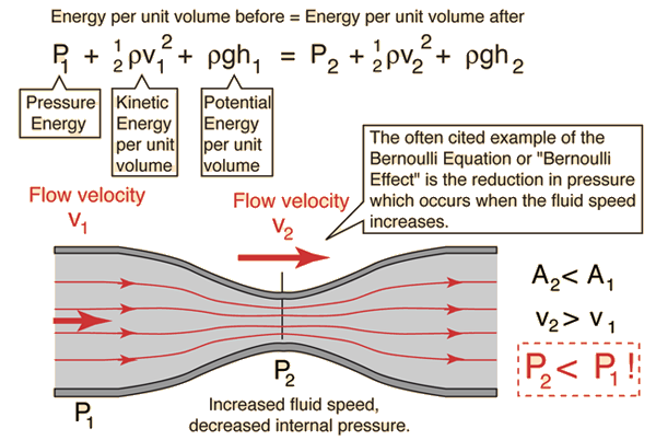

I got puzzled this morning because I was trying to fit velocity head into bernoulli principle, where the water already has a velocity/momentum. And I couldn't.
Now I think velocity head is, when the pump starts up, what pushes static water to move and give it a velocity. If this idea is right, I can understand why "Total Dynamic Head = X + 1.58 ft - 0.31 ft".

Sorry I asked the question wrong. I should ask about the relation between pump discharge volume (gpm) and pump Total Dynamic Head (ft). Now that I think about it, the pump curve graph I attached may be relevant.
3. I understand that (1) the higher the velocity, the higher the friction loss. (2) high water flow makes the pipe scream or cry. (3) in pipe size selection, we set a max velocity & max pressure drop as limitation.
But I don't understand the relation between GPM & Ft of head of the pump. Actually it's the same question in 2.
4. Ok then I'll dig into that graph. I used to spend a whole morning staring at it and figured out nothing. Hope I have better luck this time by reading your comments. Thanks.
[ol 1.]
[li]Ok. In order to select a pump the first step is to develop the system head curve. The example that you were providing is the first step in developing the system head curve. Look at the appended example. In this case the pump condition point is 50 gpm @ 12.94 ft. It is saying that you need a pump that can deliver 50 gpm against a resistance (total head i.e. friction loss) of 12.94 ft. It is one point on the curve but is the most critical point. You develop the rest of the curve by assuming different flows, 10 usgpm, 20 usgpm...etc to say 70 usgpm and working out the friction loss for each flow through the same piping.[/li]
[li]I am not sure if you know how to read a pump curve. Without going in too deep the pump performs only according to the curve. If your condition point does not fall (i.e. intersect) on the curve you have the wrong selection. Even when it falls on the pump curve it has to fall on the sweet spot of the curve. Operating a pump outside the sweet spot of the pump curve will cause a lot of problems[/li]
[/ol]
By developing the system head curve and plotting it on the pump curve, for an experienced engineer, it inherently tells you a lot of information. It is too deep to go into that now.
