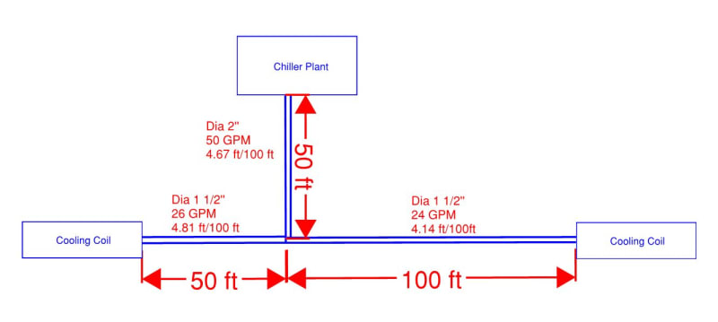

But I've got questions about how to calculate pipe friction loss of the whole system. In below sketch, which is the right way to calculate friction loss?
1. loss in Chiller plant + 50 ft/100 ft x 4.67 + loss at Tee + 100 ft/100 ft x 4.14 + loss in Cooling Coil
2. loss in Chiller plant + 50 ft/100 ft x 4.67 + loss at Tee + 100 ft/100 ft x 4.14 + loss in Cooling Coil + 50 ft/100 ft x 4.81 + loss in Cooling Coil

Hi:
[ol 1]
[li]You have not drawn the entire system correctly. You should be showing the pumps.[/li]
[li]The diagram should be shown more like the first diagram that you posted AND you have to add the cooling coils.[/li]
[li]Correct me if I am wrong but the chiller plant should be supplying both cooling coils. I think that is what you mean but your sketch is inaccurate. A proper picture is worth a thousand words[/li]
[li]The friction loss is both on supply side of the piping and the return side of the piping (1. loss in Chiller plant + 50 ft/100 ft x 4.67 + loss at Tee + 100 ft/100 ft x 4.14 + loss in Cooling Coil + friction loss in return piping back to the common Tee + friction loss 50 gpm in 2" pipe back to the chiller)[/li]
[/ol]
You could have one thousand of the 100 foot cooling coil lengths running in parallel but you count the friction loss only once
The thing you need to work out is how the flow is being controlled to the 26 and 24 GPM you list.
Without some sort of flow control ( a valve of some sort usually) the system will balance out the different losses and your coil with the lowest total piping losses will flow more than one far away.
So the trick is to figure out which one of your coils is the furthest away / highest frictional losses, design for that as the pressure loss and then add up the flows from all the units. Then make sure that you can control the flow at the ones with the lowest frictional losses to prevent short circuiting
What LittleInch is saying is that there is typically a motorized valve that controls the flow of chilled water into the cooling coil; otherwise you will have 24++ gpm going through the cooling coil flat out at all times and you will freeze everyone out in the room. I assume you have not shown this because you are just trying to get a simple answer to a simplified sketch without getting into too much detail. I would assume the actual design that you are working with has this control valve shown in the PFD.
There are many motorized control valve types that can be used to control the flow. They can be two way valves, 3 way diverting valves, 3 way blending valves,etc. Each of those types of valves has to be sized properly to be able to achieve linear control, with a good turn down, without hunting. There is a lot of engineering involved to get everything to work together as a system. The most important thing is turn down capability. I think that is outside of scope of what you are trying to do
Remember you are not trying to design the system. If you are not an expert stay away from it. Keep the lines of responsibility separate and clear. Have you approached the designer?
