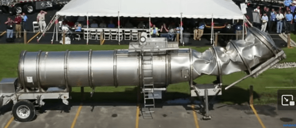

Shells under external pressure are often buckling critical long before they reach the material compression limit.
ASME code may be considered overly conservative, but you really really do not want to operate near the structural buckling limit in any design.
Addition
Here is a video from WABASH using a tanker trailer, a shell with stiffener rings which shows the speed and suddenness of a vacuume buckling failure.

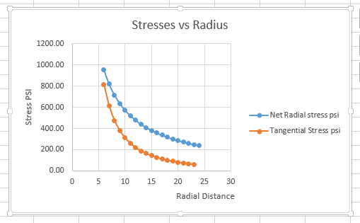

Dik, Attached the spreadsheet. The calculation goes something like this. Did it from FBD just now for a 6" ID to 24" OD cylinder, without looking in textbook, so might be just an approximation. Looks like it has enough curvatures.
