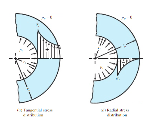

A question. With tubes containing pressure, as I understand, there is a certain point where increasing wall thickness no longer increases the pressure rating. There is a section of a large cannon breach near here and you can see that the breach has a core and an outer cover that is shrunk over it. I'm guessing this is a workaround for that problem.
Does this same rule apply to tubes resisting external pressure? A diminishing of returns as wall thickness is increased?

For internal pressure of a thick walled cylinder, hoop or tangential stress is higher at the inside radius, one being tension, the other compression, Mohr's circle, containing both the (-) radial and (+) tangential circles, shear stress becomes large on the inside face. The outside face would not control.
The outside sleeve cylinder of your cannon was heated and then shrunk into place, putting the inside cylinder in an initial compressive state, a prestressing for cannon barrels, reducing initial 0 stress to compressive stress, thereby allowing that much more tension in the inside (crditical) cylinder when the explosives go off.
Not an expert on external pressure, but basically the reverse situation, high radial stress on the outside, 6000 psi, 15 psi on the inside and compressive tangential stresses, but buckling is often initiated before actual shear failure by defects and other nonconformaties, so its not linear.

Is there a formula for sigma r?
dik - formula should be in Roark (Formulas for Stress and Strain) in the table for Thick Walled Cylinders.
