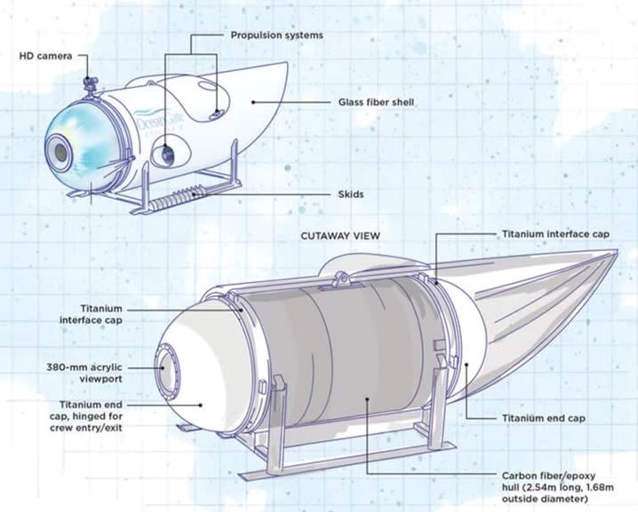

Supposedly the Titan cylinder was designed to a factor of safety of 2.5, so the cyclic loads should have been nowhere near levels that would cause significant damage; though I have my doubts about how they sized the cylinder for the static loads based on what is in the Compositesworld article linked above, so they could have been very optimistic for static strength leading to having a cyclic loads problem.
Then there is the "bonding" .....

Having 5 layers material bonded together is good for some applications like bullet proof vests. It's a poor choice for something that has to hold liquid at extreme pressures. Once the water gets in between layers and starts distributing pressure to the inner layers it's going to undergo a progressive delamination. I read somewhere that epoxies have rather poor peel strength. That would have been a disaster once the inner shell started to bulge inward with the outer shell holding in place.
Edit: Never mind, it was 5 inches not layers. But they did layer the carbon fiber so the point may still be valid.
