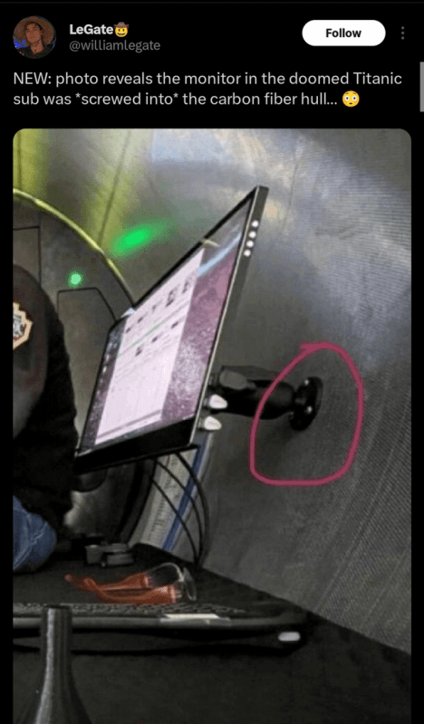

Stress raisers
OK, probably not the end of the world, but the correct approach is to bond a plate to the hull, not drill bloody screwholes in the hull.
Cheers
Greg Locock
Those aren't drilled into the hull, there's some sort of an acrylic inner lining.
It may not be screwed into the hull, there seems to be a traslucent lining installed with lighting behind it.
An interior lining seems appropriate to protect the pressure hull from incidental damage. Drilling holes in the vessel wall would definitely be NOT cool.

There was a Reddit link with pictures of the interior. It clearly showed a perforated metal liner that stood off the wall by a few inches. Sadly, that post has been deleted.
