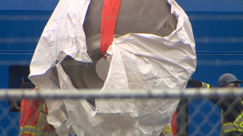

I did notice that one of the rings that was glued to the end of the carbon tube was disconnected from end bell. Not sure what that means, but does show the forces involved.

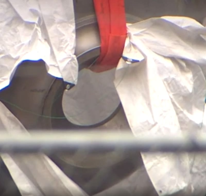

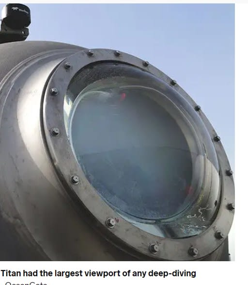

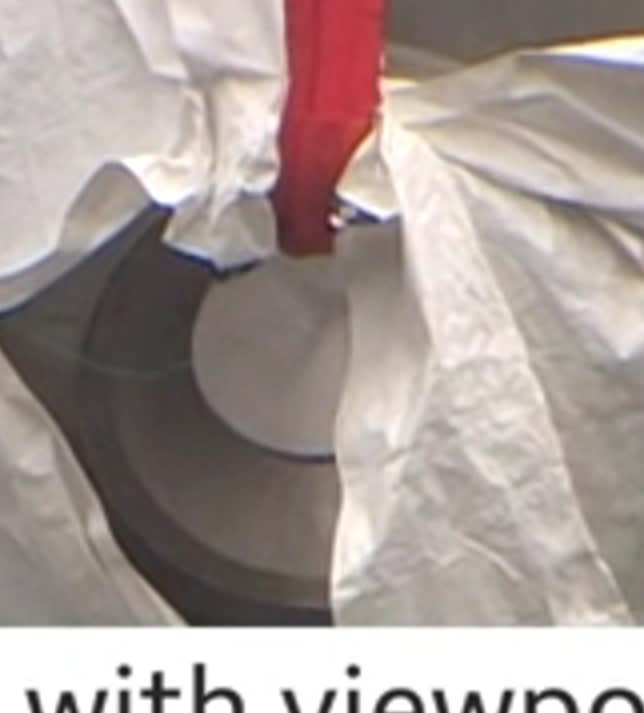

Nothing particularly new here, but it looks like the porthole window wasn't actually attached to the endcap with bolts, since there's no visual evidence of broken bolts or bolt holes, so maybe only epoxy?
TTFN (ta ta for now)
Well there was a bolted ring when it set off.
It was possibly bolted to a flange that has been sheared off where it met the large reinforcing ring?
Nah. It blew out at some point during the implosion. Bit difficult to see but looks to me like the acrylic view port had the 45 degree chamfer machined in so that the pressure sealed it more and also compressed the material. The bolts are just there to stop it falling out. That little round profiled end on the end cap can be see where the strop goes through it on the recovery photo.

That picture may be the inside of the end bell. Hard to say exactly.
I don't see any bolts or bolt holes.
As for the damage, particularly to the un-pressurized back end;
Remember that if the implosion happened one hour and forty five minutes into the dive, they may have had over one half mile to fall
A lot of damage may have resulted from the impact with the bottom.

My guess is the bolted flange probably separated from the end cap due to the strong moments applied to the bolts with a bolt driver during the recovery effort.
any validated maintenance plan to address any issues found by inspection.
For the tube it'd be replace since you can't really patch it.
So you think they took it apart before raising the pieces? I'm doubtful of that.
It’s got to be the outside.
The inside:
Maybe the bolts were part of an outer assembly?
