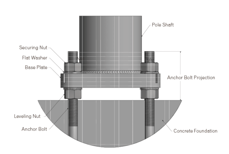

I disagree with this statement. I am a proponent of adhesives mount fasteners in the maritime industry. When using adhesives to attach fasteners to metallic structures, fatigue is a concern. However the plastic/epoxy adhesives have a Young's modulus that can fully accommodate the elongations of the steel structure over all conditions that would not also contribute to a fatigue failure or the steel structure.
Adhesive fastening systems are superior but the salespeople don't know how to push their products. All cases require the use of leveling just like concrete installs.
However, the sales people don't see this and look bad when fasteners pull off during tightening. There is little trust for their products outside of the aviation industry that has specific procedures.
Sorry Tug... with the pressures involved, I suspect differential movement could be an issue. I, however, have no idea of how the carbon fibre cylinder and the titanium hemispheres will interact. I wouldn't rely on the high pressure to provide the 'clamping' action to keep them in contact and waterproof. I spec Hilti chemical anchors several times a day, usually. I'm also on Masterbond's mailing list and often get information on the various types of epoxies they have... structural, medical, and electronic, conductive and non-conductive. I'm somewhat aware of some of the epoxies out there.
