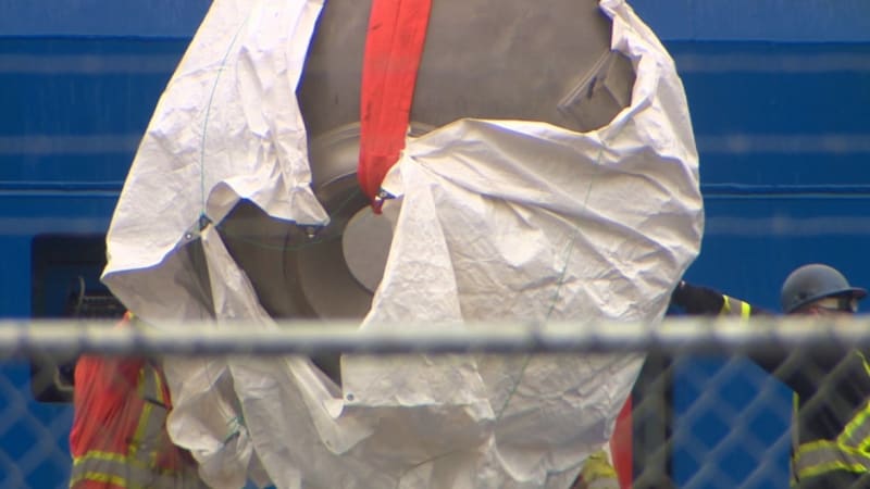

I saw some additional photos on TV, one appeared to be the titanium end ring sans the dome.

I had thought the end caps would survive, and it appears the porthole side did, but it's not obvious whether the window itself broke before or after the implosion
